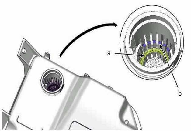

N.B.: Checking of the LDS fluid level is done with the vehicle in the forced low position (hydraulic suspension circuit de-pressurised).
"b" LDS fluid maximum level.
"a" LDS fluid minimum level.
Open the cap (3) of the fluid reservoir LDS.
If necessary add LDS fluid up to the maximum level "b".

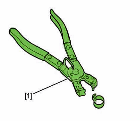

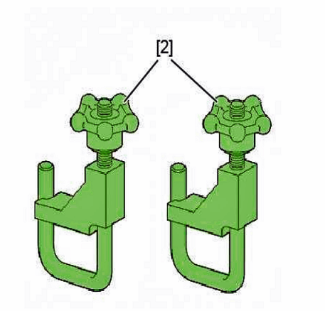

| [1] clip pliers CLIC 4121-T | [2] set of two hose clamps 4153-T. |

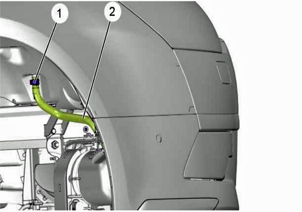

| Clamp the hose (2); Using tool [2]. Remove the collar (1); Using tool [1]. Uncouple the hose (2) from the LDS fluid reservoir. Drain the LDS fluid reservoir. CAUTION: Recovered LDS fluid must not be reused. |
- Couple the hose (2) on the LDS fluid reservoir.

| "b" LDS fluid maximum level. "a" LDS fluid minimum level. Fill the LDS fluid reservoir up to the maximum level of LDS fluid "b". |
