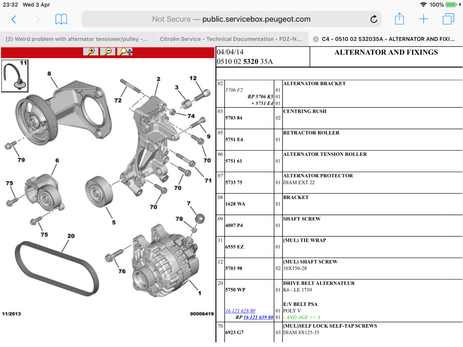

x 6957
Re: Weird problem with alternator tensioner/pulley - C4 2.0 16V petrol
Ok, so it looks like it’s the alternator bracket that has cracked (number 2 on the diagram). You’ll also need a new roller (number 5) when replacing this.
The bracket is priced at £87 (UK) which includes our VAT at 20%, so may be less with your local dealer.

It is indeed that number 2 part. I might get one off a parts vehicle. Or do you think it's wiser to buy a new bracket? Can you buy it at OEM parts suppliers or only authorised Citroen workshops?
I can change the belt and rollers but changing this bracket might be beyond my skills. A person at another forum suggested that I need a floor jack or engine support bracket which I don't have.
Anyways, I will do some calls tomorrow and see what I can find.
Should I replace the other roller (number 6) as well?
Unread post by xantia_v6 »
I might be wrong, but looking at the photos and diagrams, I think that it is number 6 that is broken, which is part of the tensioner assembly. Look at the relative position of the A/C pulley, the idler pulley and the tensioner pulley.
It is not obvious from the diagram whether a lot of dismantling is needed to replace the tensioner. Even the alternator bracket looks to come off fairly easily one the alternator is removed.
Unread post by SuperMajinBuu »
You might be onto something here. It is definitely number 6 that is wobbly. But when I looked at it as much as I could see is that the broken part is on the number 2 bracket and not on the roller/tensioner. I could try to take better pictures tomorrow but it's hard to access.
I suggest that you remove the tensioner assembly (it looks like there are only 2 bolts), and everything should become much clearer.
Unread post by RichardW »
I concur, Mike, looks like the tensioner to me - and anyway the bracket is not item 2 in the diag above, that is further forward. The big bracket in the pic is the engine mount - don't try removing that unless you are sure what's going to happen - at the very least you will need to support the engine.
Hi Richard, thanks for the reply.
In that case could be car killing if it's the engine bracket. It does seem that the diag above is not complete because on that one number 5 roller is connected to that bracket and the crack is near where the number 6 is attached. I will take the front right wheel of today and remove the plastic shield/cover to see if I can see anything from there. It is a problem this engine with unacessible parts. I also have a mechanic coming tomorrow and looking at it for a second opinion. Hopefully it's just the tensioner.
I'm sure it's not car killing!! I'll have a look later to see if there is a procedure for the tensioner change. The engine mount is still available, £125 from Citroen in UK - but I really think it's *just* the tensioner - but that is £105.71 from Citroen here. Part no 575161 - there are lots on e-bay uk for much less than that!

RichardW wrote: 04 Apr 2019, 10:06 I concur, Mike, looks like the tensioner to me - and anyway the bracket is not item 2 in the diag above, that is further forward. The big bracket in the pic is the engine mount - don't try removing that unless you are sure what's going to happen - at the very least you will need to support the engine.
Just going on what No 2 is is officially described as "Alternator Bracket" as shown on the diagram - I find it avoids confusion Richard

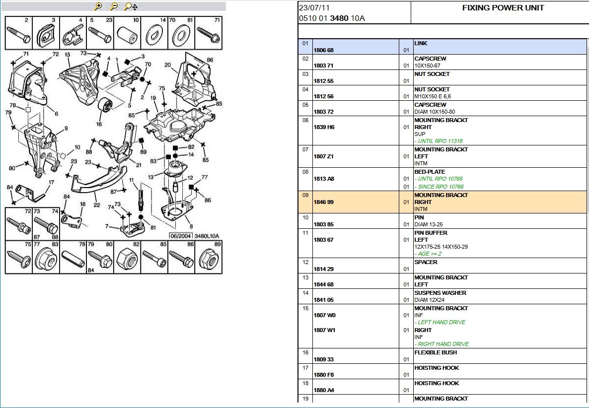

x 3566
The large bracket that you've circled the top of in the engine diagram is part 9 in the diagram below.
A generic search on C4 2.0 16V gives it as part number 184699
Engine bracket - PSA, fair use
