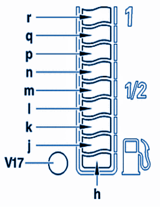

Ok, as promised, here is the technical explanation for your Xsara Picasso as to how the fuel reading is displayed and how this is calculated at both ignition on and when driving:
Phases of operation: When the ignition is switched on.
The instrument panel compares the last fuel level displayed with the gross level indicated by the fuel sender unit (variable resistor fitted with a float).
If there is a significant difference, the gross level information is displayed, otherwise the last fuel level displayed remains.
Phases of operation: When driving.
Below a certain sender unit value, the instrument panel sends the minimum fuel information to the BSI via the VAN in addition to the fuel level in order to warn the engine management ECU.
In addition, the instrument panel displays the warning message : "LOW FUEL WARNING". The warning lamp V17 is illuminated.
This is what is supposed to be in the tank, according to the segments lit:
"V" in the table relates to the amount of fuel
- The fuel sender unit is no longer used.
- The engine management ECU supplies the fuel flow information to the BSI.
- The BSI encodes this information in a VAN frame.
- The instrument panel takes this consumption information into account to calculate the fuel level.
- The instrument panel sends this level to the BSI via the VAN network.
| Segment | H | V17: Warning | J | K | L |
| Litres | V Greater or Equal to 0 | V Less Than 5 | V Greater or Equal to 6,5 | V Greater or Equal to 13,5 | V Greater or Equal to 20 |
| Segment | M | N | P | Q | R |
| Litres | V Greater or Equal To 26,5 | V Greater or Equal to 33,5 | V Greater or Equal to 40 | V Greater or Equal to 46,5 | V Greater or Equal to 53,5 |
