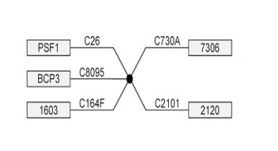

Ok, so this is all that is listed - 4050 on the first diagram is the Water in Diesel Sensor, which I have then expanded in the second diagram.
There is no further detail on the pins within the Engine Fusebox, other that diagram 3. They do not list any other detail David.

Does the below look right to you?
Looking at the Water in Diesel Sensor (4050) in the middle image I can see the 3 pins on the sensor.
Pin 1 - 12v Supply - C4050 - Goes to EC73 and then to PSF1 via fuse F6 which connects to Pins 4 or 20 on the Grey plug.
Pin 2 - Earth (?) - M4050 - Goes to EM16 and then to MC16.
Pin 3 - Signal to ECU (?) - 403 - Goes to Engine Management ECU on Pin 11.
Wiring diagrams aren't my forte so just wanted a 2nd opinion
David.

403 is the Water in diesel fuel detector info
M4050 is the Earth
C4050 is the positive.
Now not strictly correct as the C4050 positive goes into EC73, which is a d1 crimp ignition controlled supply protected by fuse number 73. This consists of:
Here's the socket references:
EC16 is the earthing crimp and MC16 is the earth.
As for Fuse F6 in the engine fusebox, PSF1, this would seem to show the protection for the auto gearbox, so may not be relevant - as the EC73 crimp brings together other wiring. 1603 is of course the auto gearbox.

DHallworth wrote: 01 Apr 2019, 20:30
David.
Remember there are multiple connectors on the engine ECU so there will be more than one pin 11. On this one its pin 11 on the 58 way black connector.
