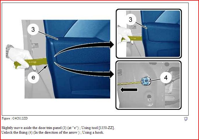

How to remove the internal front door card on a 2013 B78 C4 Picasso?
Looked all over and this model is not on any forum or youtube.
I got the two screws inside the handlebar and the one screw top front edge.

There appears to be a hidden fixing....

Thanks, I'll have a go on the weekend,
The previous pictures only show the three screws I already found?

If after seeing Richard's pictures you need further help - i.e. the full removal guide, let us know and pop your VIN up here.
