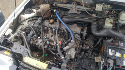

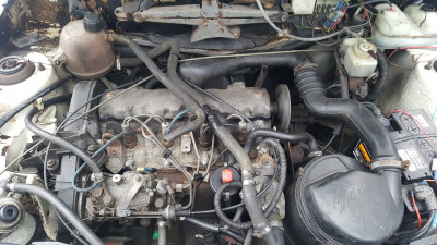

Re: citroen c15 d cooling system
i have replaced the blue hose with proper pipe , i suspect something has been canabilised somewhere but this is what i have to work with atm ,
i know the fans work , ( had an auto electician check and change relays yesterday)
i have run the engine up for 30 mins and it didnt boil - nor did the fans come in
so is it ready for the road ?
have a look at the pipework ,,, i know its not correct , but it seems to work
what do you think ?
- white exec
The black hose connecting radiator top hose (thermostat output) to the expansion tank will be sufficient on its own to allow coolant to expand into, and return from, the tank.
The blue hose (from the top of the thermostat housing) will work as a possible escape route for trapped air, but also risks air being sucked back from the expansion tank as the engine cools. If the system has been properly bled of air, there should be no need for this pipe, and I would suggest removing it, and simply using the spigot on the top of the 'stat housing as a bleed point (fit a small tap or bleed screw there).
Otherwise, looks ok, assuming you have a blanking cap on the radiator, and the pressure cap on the expansion tank.
