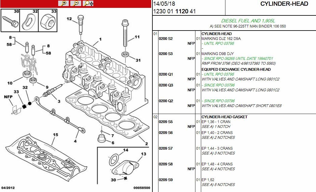

This is going back a very long way, but when I re-headed our NA BX19RD (mid-'90s), I fitted the 'new' multi-layer (all-steel) HG, and had no problem with it. I vaguely recall HGs being available in 3 thicknesses (1, 2, or 3 notches), to accommodate head/block skimming. As our block had never been ground, and the replacement head was brand new, I just went for the standard gasket, which was, by then, all-steel.
Looks like (for the 1.9) three of the five HG thicknesses are still available from Citroen.
For the 1.7, they're all NFP.

Thanks Chris, having been fine on your BX, I'm sure should I ever need to replace the HG on my 405, the Multi-Layer will be fine. I think the BoL quotes four thicknesses of Gasket, but the differences are fractions of a millimetre; I'll get the thinnest multi-layer I can find if the job ever comes up
