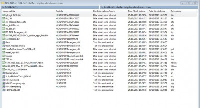

While I was traveling home I inserted the USB key with the upgrade software (NG4-N42c) and ... the upgrade process continued until the end ... 100%.
All NG4 functions are OK. Speech recognition is ok, phone is ok, navigation is ok.
IS IT A MIRACLE?
The upgrade software I used is the one you sent me, and it's identical to the one I used before (as you can see in the screenshot below). So what happened to make the NG4 change its mind?
Perhaps the continuous disassembly and assembly, startup and restart, have unlocked something that prevented proper operation.
In any case, now it seems that everything is working properly.
