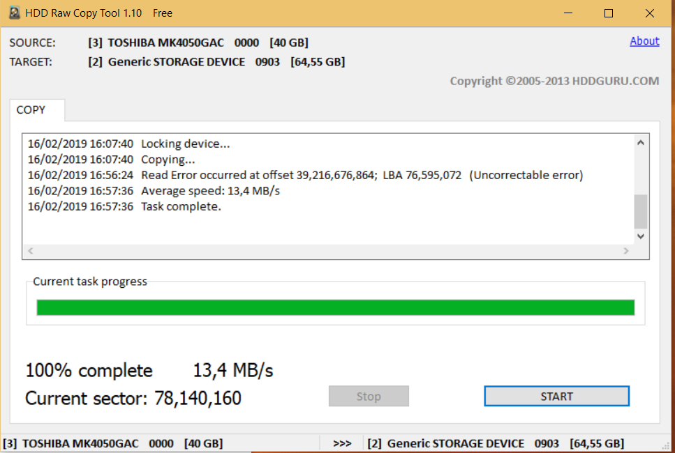

Unfortunately, even my hard drive has problems. I tried to clone it with HDD Guru; the copy worked, but there are some sectors that are not repairable and so even with the cloned CF card the NG4 behaves in the same way (the voice commands do not work and there are many other anomalies).

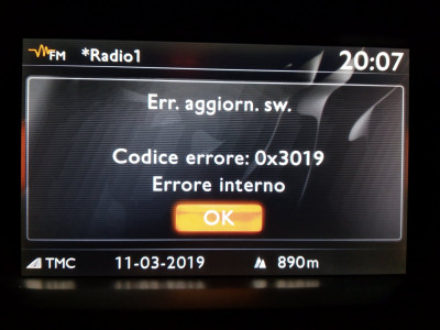

Unfortunately, it seems that the firmware upgrade on the CF card is not working. The process reaches up to 67%, goes off, restarts and then provides this error: "software update error - error code 0x3019 - internal error".
Then it asks me to reinsert the usb key and try to upgrade again.
I repeated the operation three times in a row but I always got the same result.

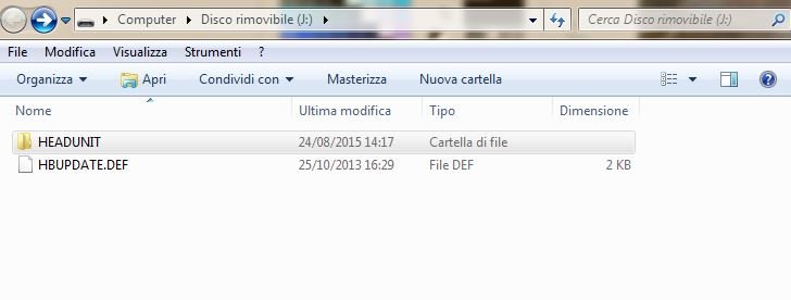

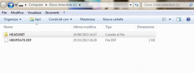

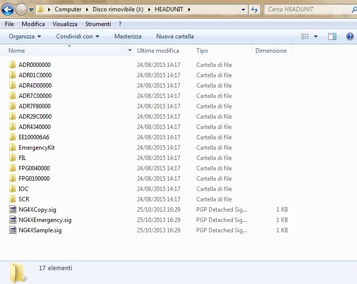

You have extracted the latest firmware onto a USB key, making sure onlybthe extracted folder and files are on the key and nothing else? A screenshot of the file contents might help.

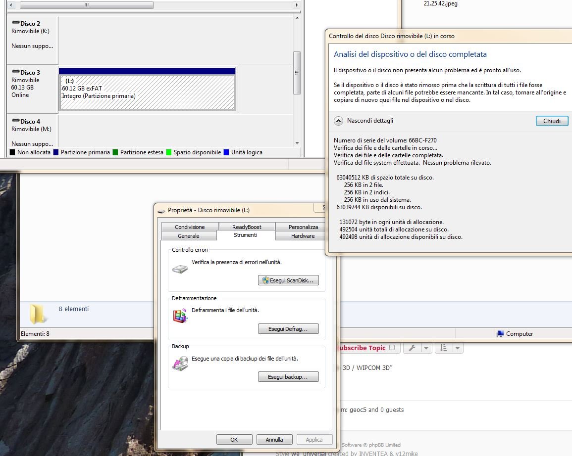

I might be inclined to reformat the CF card (FAT32, as Marc said), and then run Scandisk on it, just to check for any errors with the card. That way you can eliminate a possible cause for the problem.

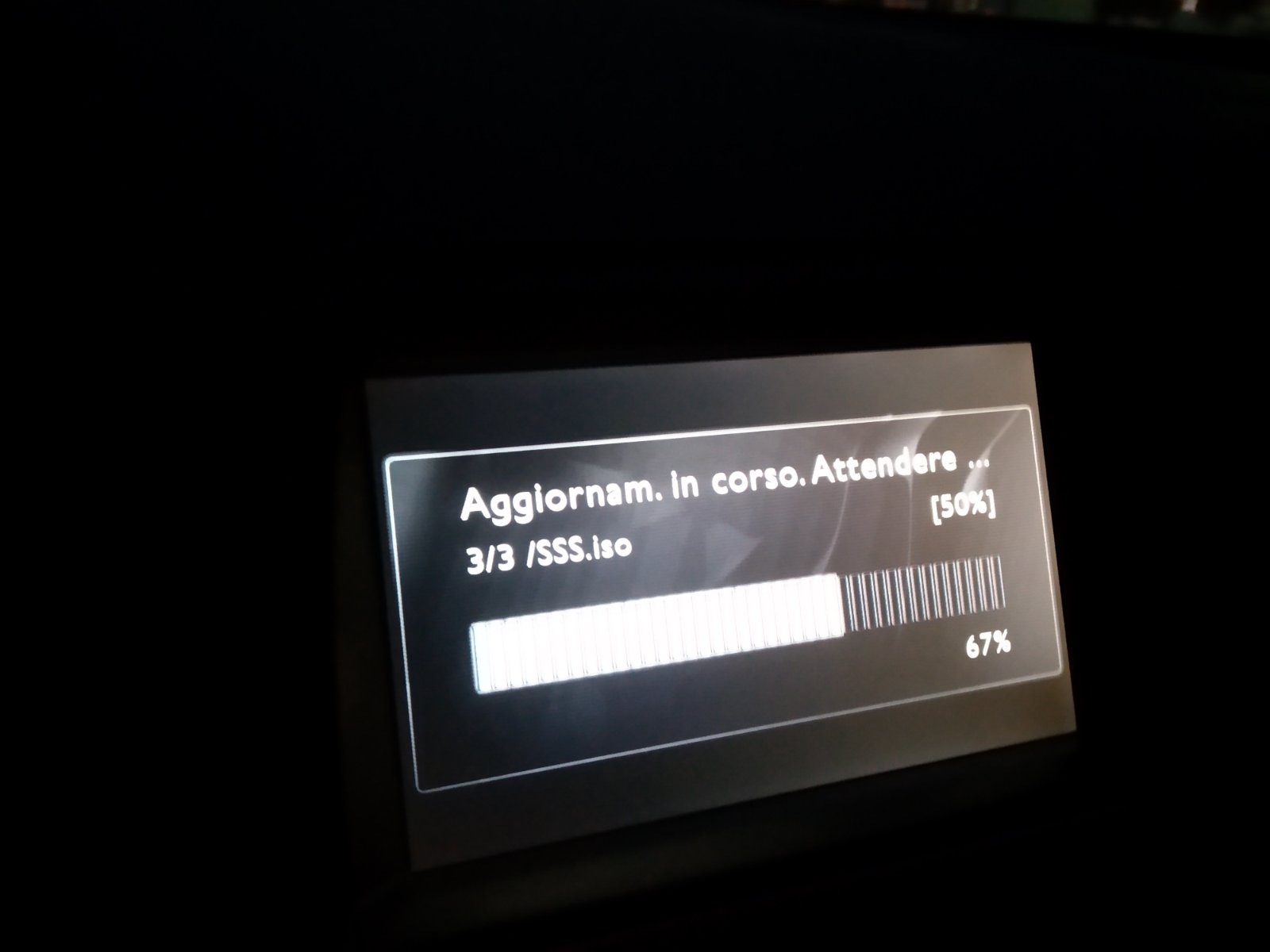

2) as a result of these problems I have attempted to install the firmware upgrade (NG4-N42c) via USB key;
3) installation of the upgrade has never been successful. He always stopped at 67% and then he didn't go further. (To interrupt the process I had to disconnect the battery); 4) I cloned the hard disk on a CF card and in the cloning procedure the HDDGURU software completed the work, but says that there are some sectors with non-repairable errors;

Several possibilities:
1) It is possible that your N42C firmware upgrade file is corrupt and not written properly, so it cannot read from the USB. Use another copy of the file. I can supply this if you need it - let me know.
2) You have created a fault in the unit by disconnecting the battery - which must NEVER be done when performing a firmware update as it can risk corrupting the unit.
Soo first of all I would get another completely different copy of the firmware update, format the USB key with FAT 32 and then try again. PLease then copy a screen shot of the USB key once you have put the new files on.

This is the screenshot of the copy of the upgrade I used
If you can, send me another copy so I'll try.
Perhaps there would be another way: I could try to clone the CF card with the image of a working hard drive, since mine doesn't work. Could you send me a copy of the image of your HD?

I'll send you a Private Message shortly Ivano. But looking at that screenshot - it does seem that the disk has some unrecoverable errors, which are affecting the copy.

At 67% of the upgrade, the system restarts and gives me the usual error message (error code 0x3019, internal error).

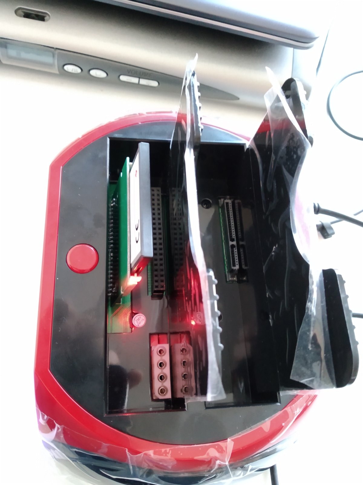

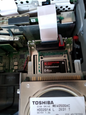

I checked to have correctly inserted the CF card with the adapter. I checked with the dock station that the CF card is readable with the adapter ... OK. In any case, the system did not partition the CF card. After extracting it from the NG4 I checked it on the PC and it results a single partition (60 GB) formatted in FAT32.
It is as if the system could not write to the CF card.

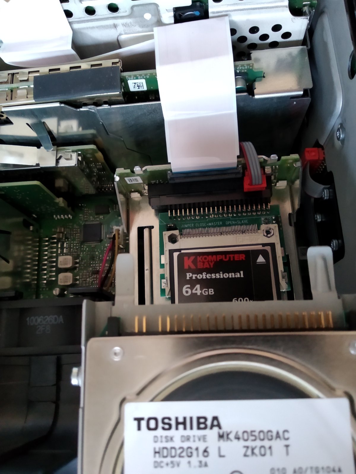

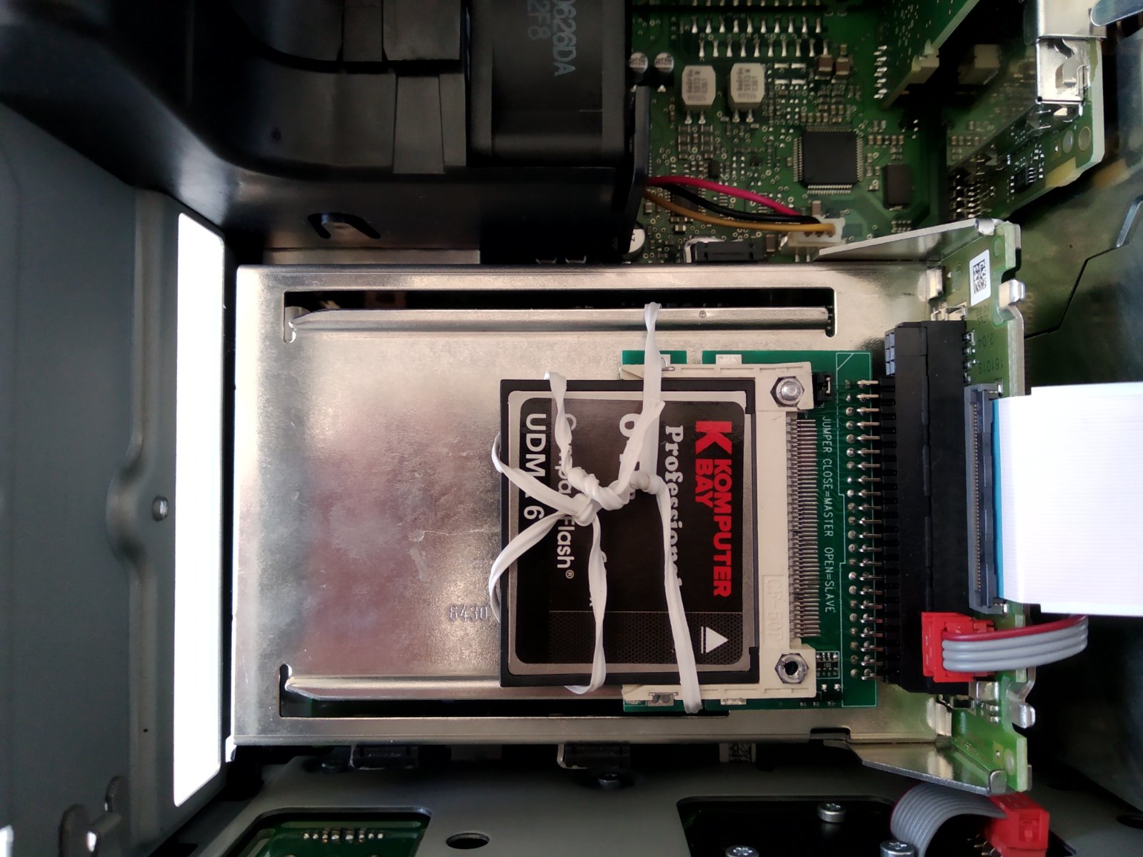

Ivano, do you have the link for the CF to IDE card adapter you are using? I want to see the exact adapter you are using if possible - a link to the actual one will be fine....
I have a suspicion that the upgrade is writing some of the files to the internal chips as part of the firmware upgrade, but when it comes to creating and writing to the CF card it cannot communicate or write to the card - which is what you also suspect. I know that some of these adapters will not work / or the configuration of jumpers and pins need to be exactly correct.
As per my guide, the NG4 has the internal DVD set as the MASTER device, so you must have a CF card adapter that is configurable as a SLAVE, otherwise the NG4 will not be able to write to it.
geoc5
- Posts: 12
- Joined: 10 Mar 2019, 16:24
- x 1
- x 6957
Re: Guide to Replacing the NG4 Navidrive 3D Hard Drive with a CF Card
Ok, so are you 100% sure you have the jumper setting correct? What I would do is move the jumper on the CF card to the other position and try again.
