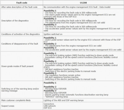

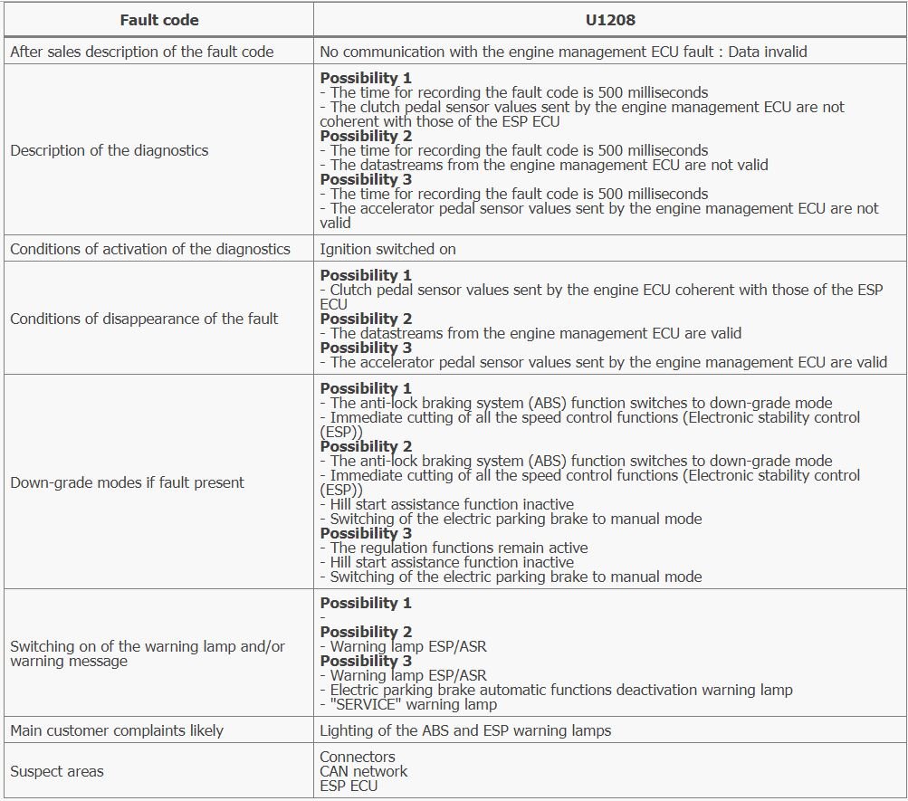

The BSI has obviously been swapped. Both those VINs relate to the same vehicle model and engine, so that's a start.
As for the faults, these both relate to the ABS / ESP ECU which A) is not getting any signal from the Engine Management ECU and B) is causing the second fault as a result of fault U1308.
U1308: No communication with the engine management ECU fault : No signal
U1208: No communication with the engine management ECU fault: Data invalid
So basically U1308 is saying the ABS/ESP ECU is not getting any signal from the engine ECU, which results in the second fault U1208, which basically is saying it can't understand the data - which makes sense as it can't if it's not getting anything in the first place.
So the focus needs to be on wiring connections from the ABS / ECU to the Engine ECU - check all connectors. Has any work been done on the brakes lately or any work generally? This won't be the first time we've found people have had work done and dislodged a connector or not put it back properly causing problems down the line.
Of course until this is fixed all your ESP functions will be disabled including hill start and some functions of the electronic parking brake, so be aware.

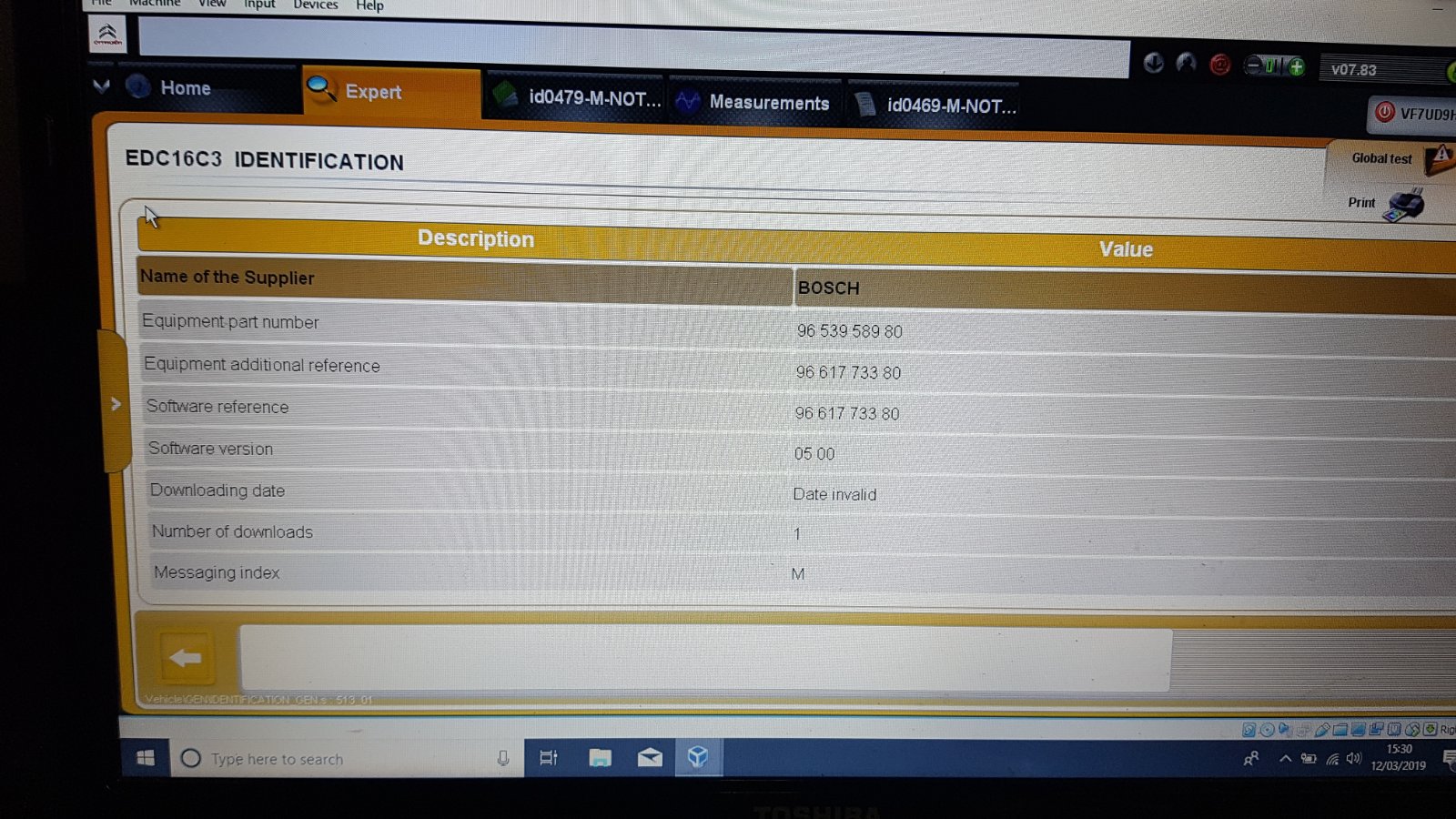

I traced clutch position sensor back to ECU and the ABS ECU and all fine. I managed to connect Lexia to the car and I cleared all the faults. I could see in the ABS ECU the position of the clutch position would change when I pressed it down and same with Bosch ECU. Once I do that I cleared all ECU fault codes and I get ECU communications coherence fault straight away and the ABS/Braking system warnings come on. Here is a screen shot of the version and sw version on the ECU. Does anyone know if there is a problem with these versions?
