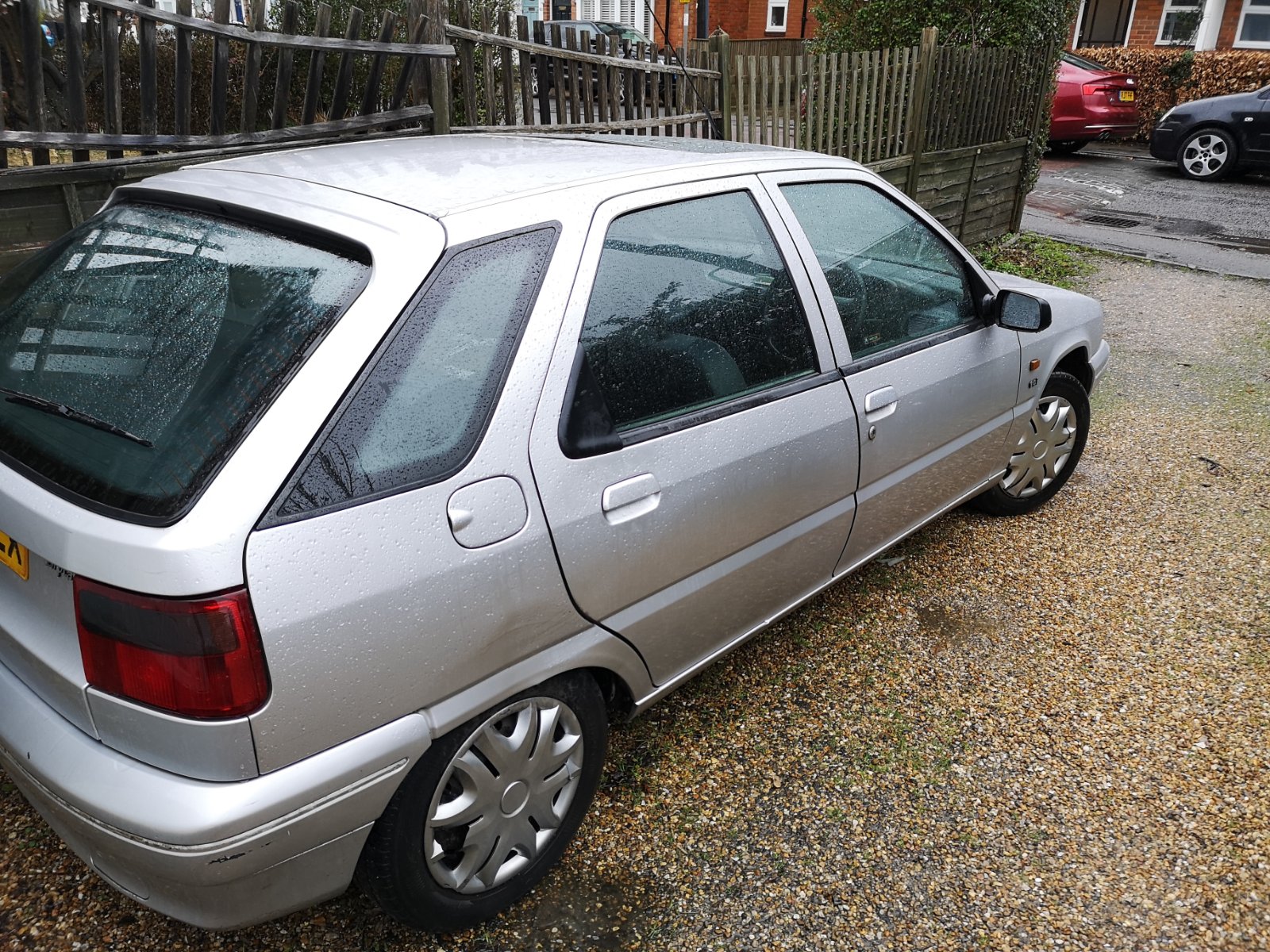

So, enter the 3rd ZX! a 1997 1.4i Temptation! Bought from Derby on Monday, a guy from another forum I know was delivering a car to Newcastle on Tuesday, so I bunged him £50 and he got the train from Newcastle to Derby, drove to mine in Oxon, then I drove him home to Basingstoke and back again!
What did I buy (sight unseen)?
It's fairly tidy. No idea how many owners it's had yet as I don't have the V5 (The guy I bought it from only recieved it this morning, got to change the ownership tonight) but it has 57k on the clock and a very clean MOT history

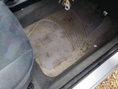

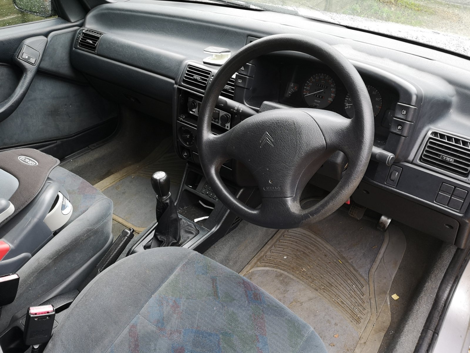

Downsides, well... the interior is perhaps not as fresh as it could be
it utterly STINKS! Must have the carpet shampooed/removed and jetwashed before it becomes warm! Not the person I bought it from's fault, he only had it 3 weeks (couldn't fit his mobility scooter in it) but it seems to be wearing all of it's 57k in it's carpet!

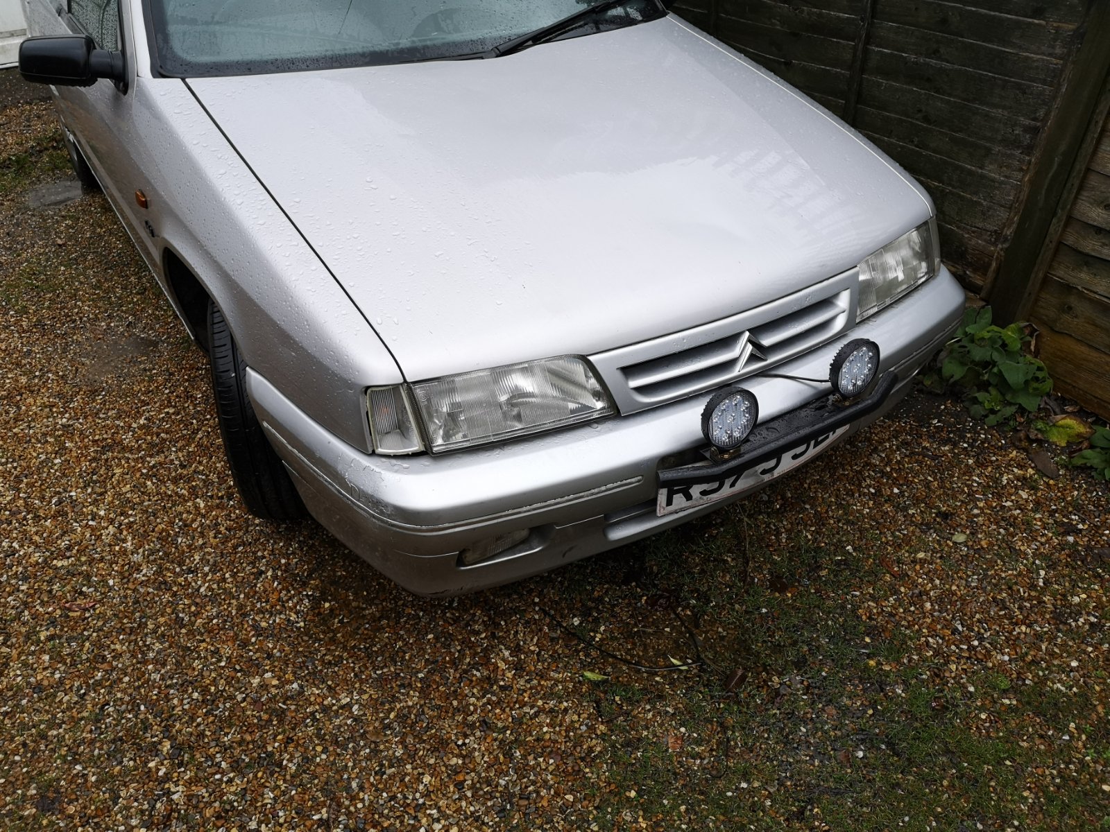

Certainly some seriously yukky interior bits!
What is that in front of the front bumper??

That's the homebrew light bar! Looks silly but I do rather like it! The wiring needs tidying, and I'm not sure how MOT friendly it is so may look at making a quick release for the wiring and noting how to remove it for the MOT in December...

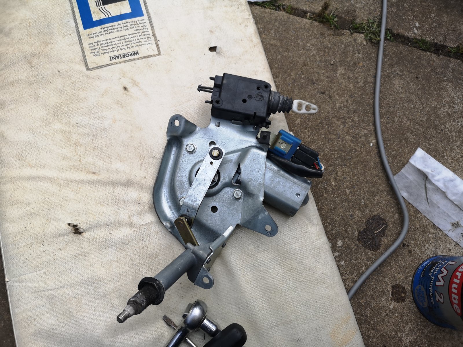

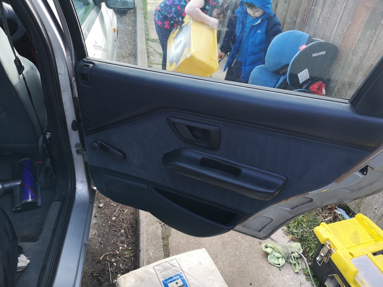

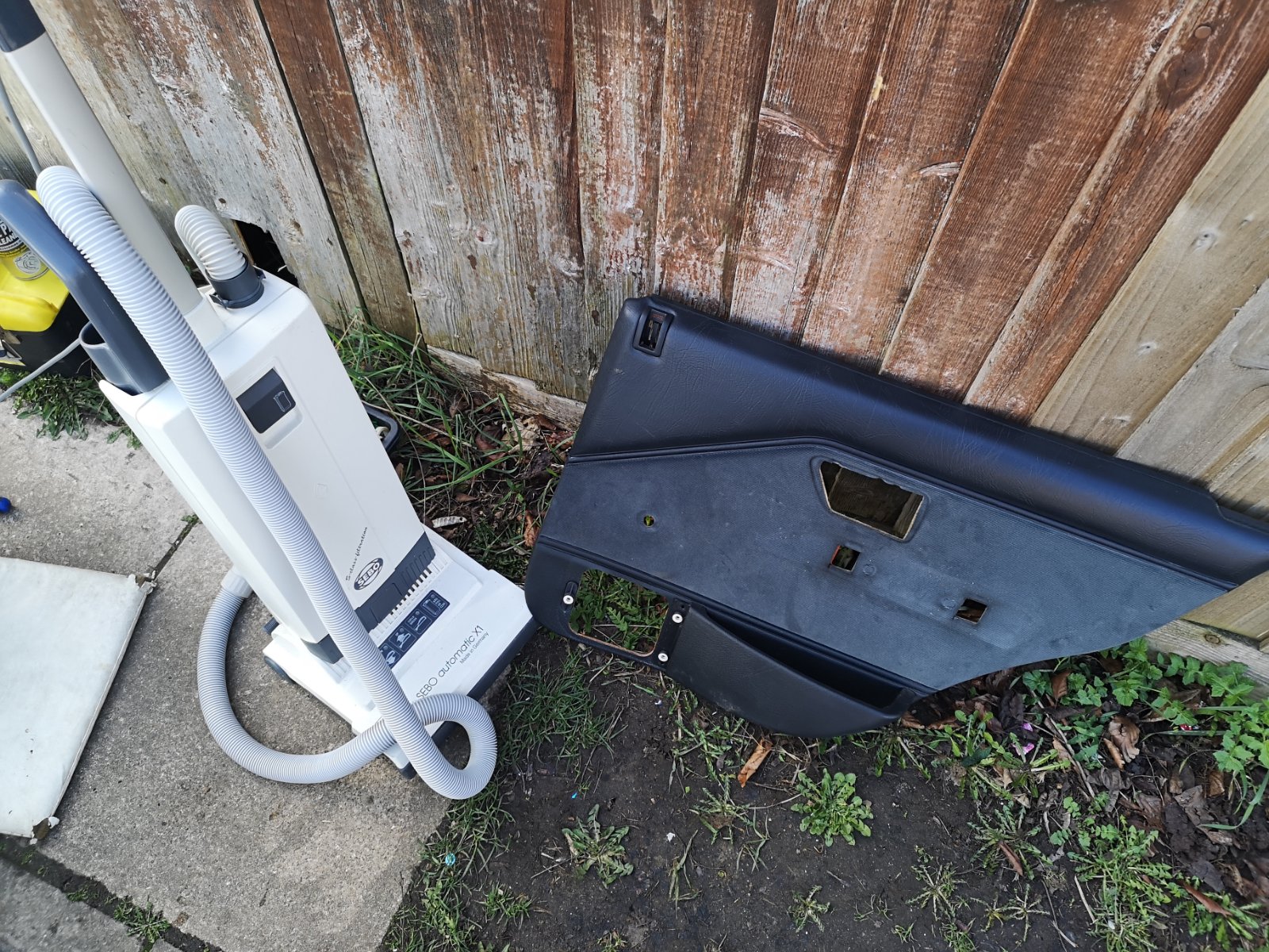

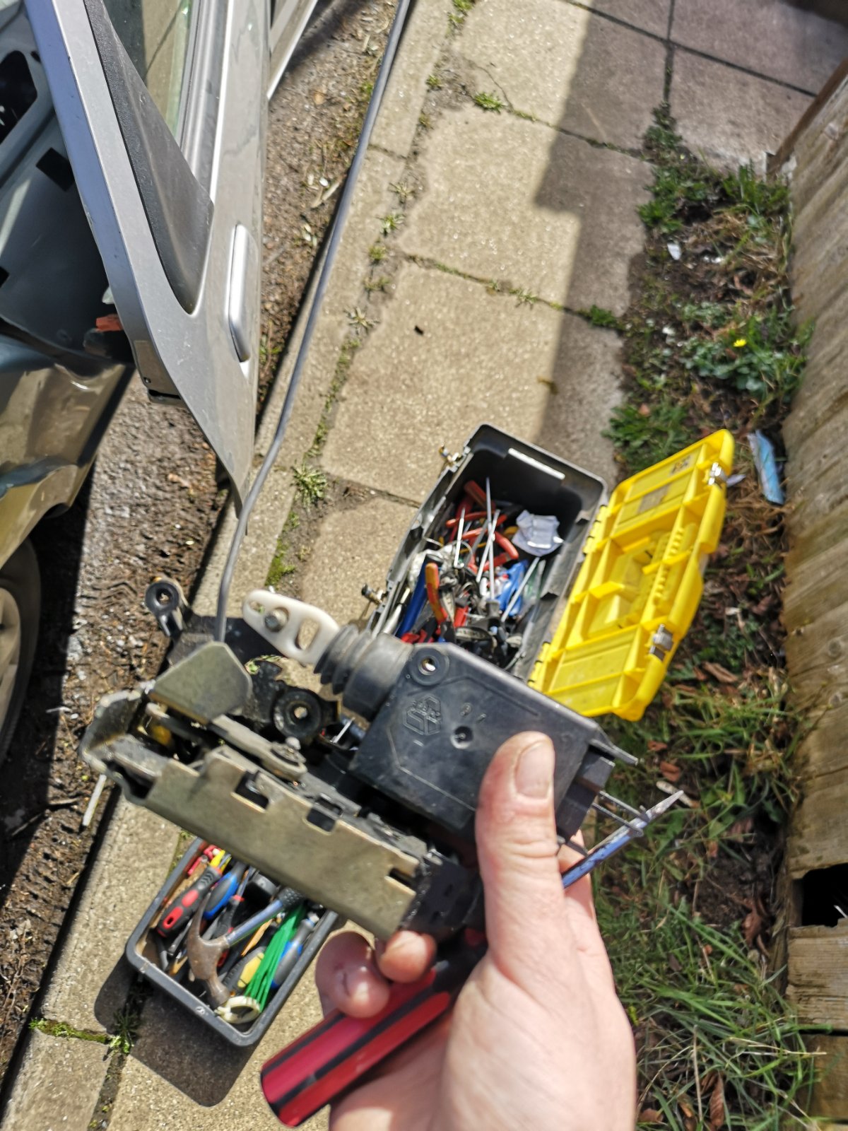

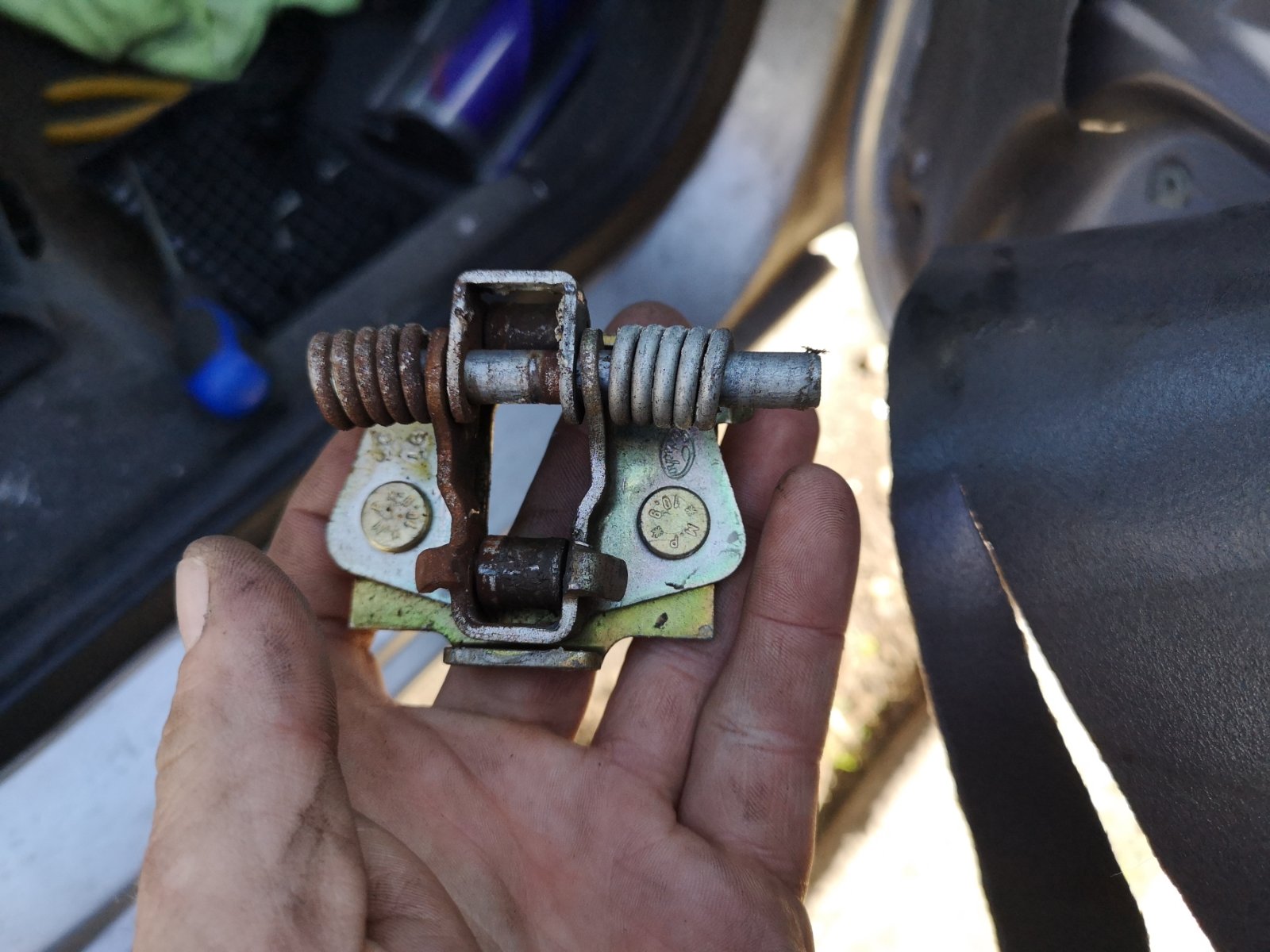

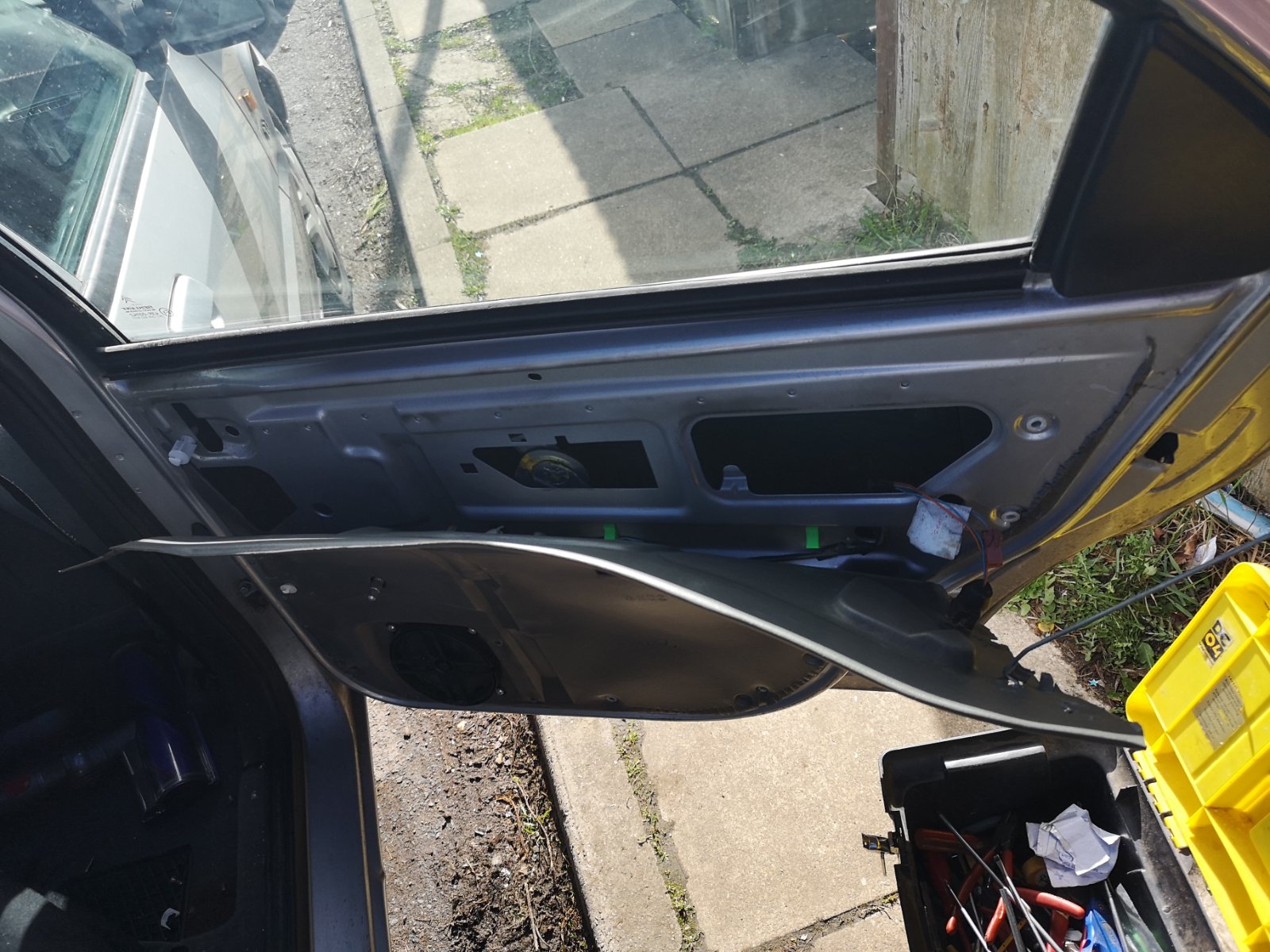

Quite a productive weekend! First on the agenda yesterday was the non working rear door, took quite a few slams for the latch to flick and latch, and has been this way for some time going by the many shallow dents by the door handle, I had to give it a swift boot thursday after realising it wasnt shut whilst driving, and I was at risk of it opening and me loosing my lunch...
Doorcard off, inner foam cut cleanly for re-taping later, unclip the metal rods and unscrew and extract the latch assembly
A good blast with brake cleaner cleaned all the old grease and dirt off, I left that to evaporate for a few minutes, then a good douse of plusgas, shook the excess off then filled it with spray grease. Refitted, and fully working again!
I gave the window mechanism a good dribble of grease too, and one more for luck on the latch. Next, I removed the speaker for the next job, and their all like this...
The reason for this? The check strap did nothing. The cause was immediately apparent when I found the other half of it rolling around in the door skin
It had been pushed in from the outside, the mounting point was a right mess, so a few well aimed blows with a drift and mallet bent it roughly back into shape. I un-seized the mechanism with more plusgas and spray grease, then re-assembled and fitted it with some nice big washers to spread away from the mullered metal. Job done!
I then grabbed a broken Sebo from the shed (I collect, repair and have a youtube channel on vacuum cleaners, hence the easy access to a fully working suction wise Sebo, albeit with a broken height adjustment) and gave the doorcard a good vacuum off as it was filthy underneath the furniture
I broke a few trim clips removing it, but once hooked onto the top trim, and with everything screwed on it's not going anywhere
I did battle with the lock peg, I forgot how much I HATE THEM, can never refit it correctly. It's not fitted properly now, just sitting there with the rod moving underneath it, I'm never going to unlock the door with it(car has a chinese RF locking system fitted which is utterly fab) so it'll do for now!

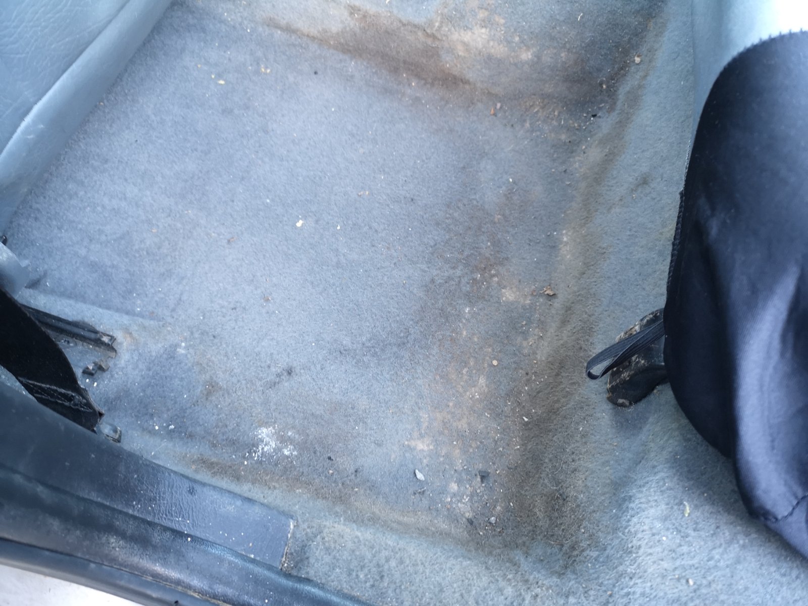

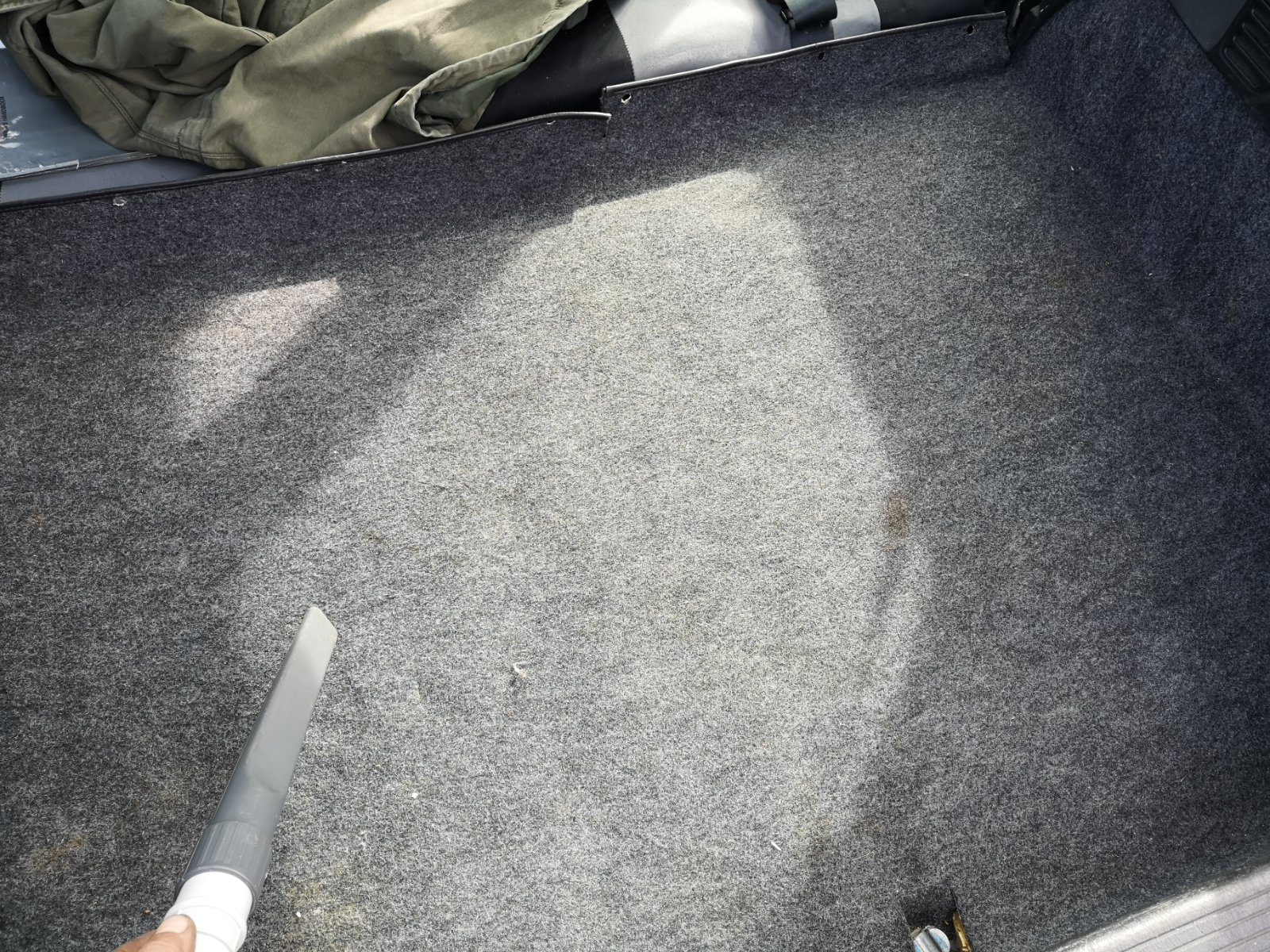

I next moved to the boot, emptied the few things out of it and got vacuuming! It wasn't too bad, but the whole interior utterly stinks so I was half expecting to find a dead rat or similar
Nothing found, and it was quite clean really. The parcel shelf fabric slid right off it as I leant it up against the fence, so that's fully stuffed! Dropped the wiper motor down for a good grease of the pivot points, and I dis-assembled the wiper arm end, removed the circlip, 2 washers and remains of the seal and filled it with plusgas until it was dripping out of the other end. I can no longer hear it turning whilst driving at 70mph which is much better!

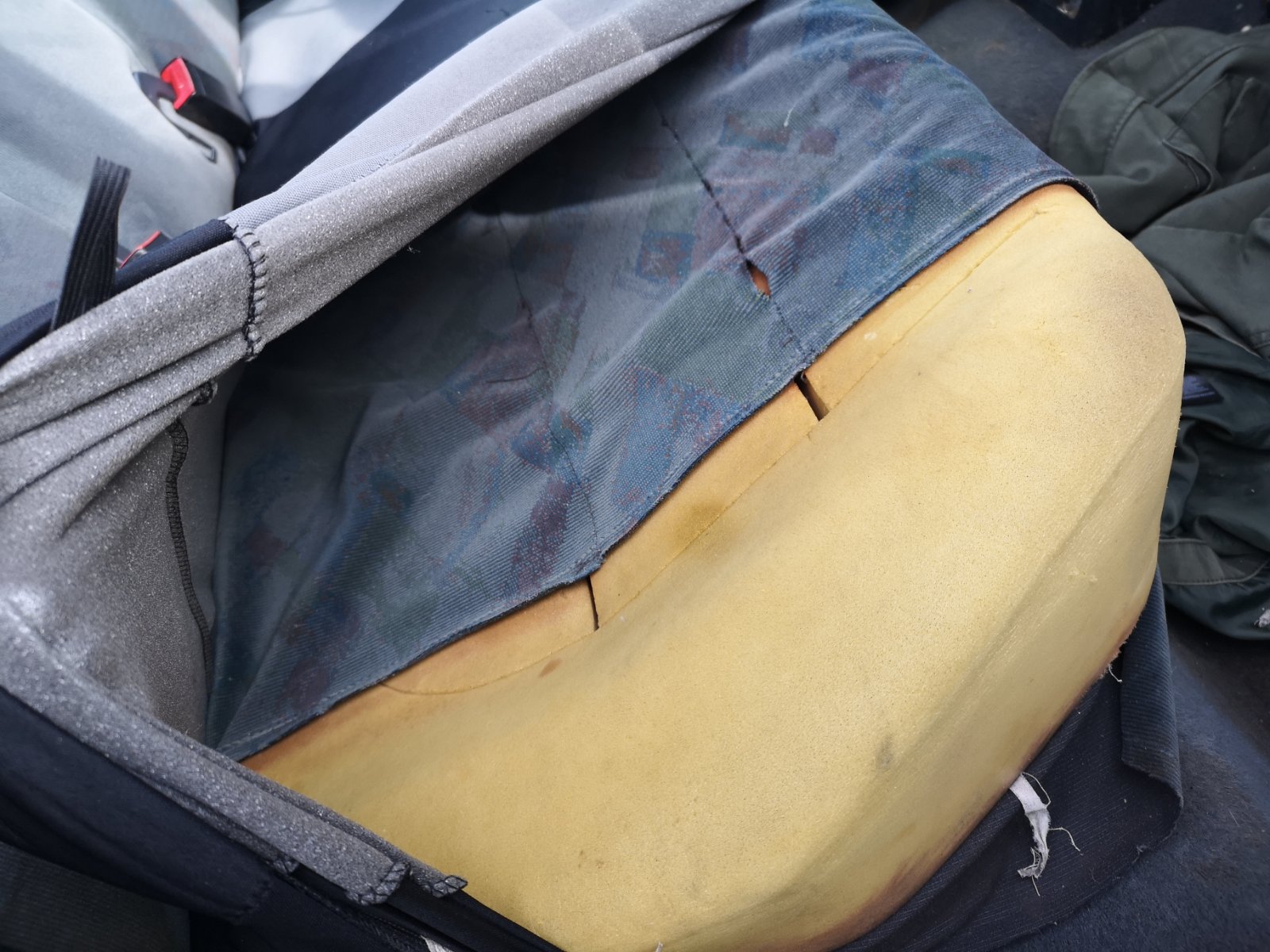

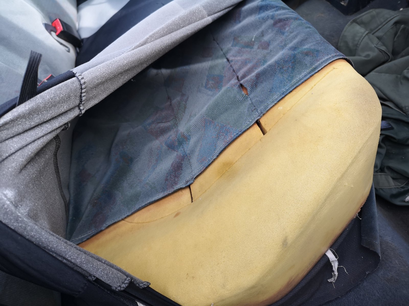

The guy I bought it from said the rear seat covers were there for a reason, and he was correct!
I removed the cover from the seat back as that's fine, and tightened up the straps on the base, will look out for a ZX with OK seats being scrapped and try to nab a matching set, but for now, since it's only ever me in the car 97% of the time, it's fine!

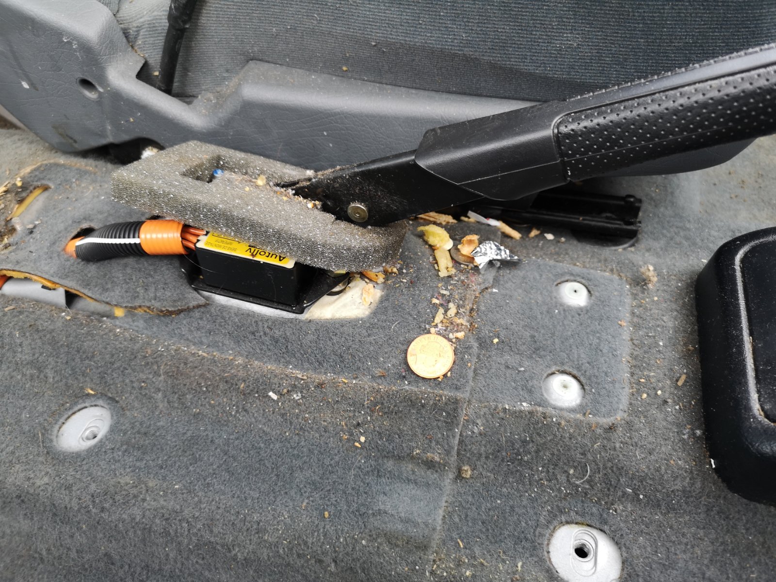

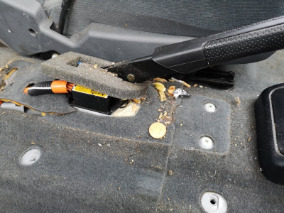

I then whipped the drivers seat out for a good vacuum, and found some change! It's now a £299 car!
I neglected to take any photos as it was getting on a bit but it was all vacuumed off fairly well, it all needs coming out again when the weather is better for a proper shampoo but the amound of food I got rid of will hopefully take the smell with it!
The front seat fabric changed colour too with the vacuum!

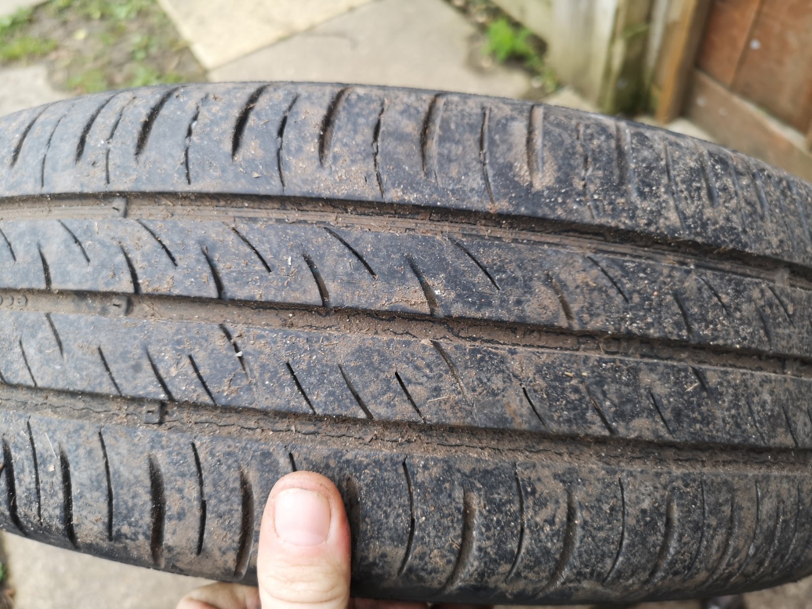

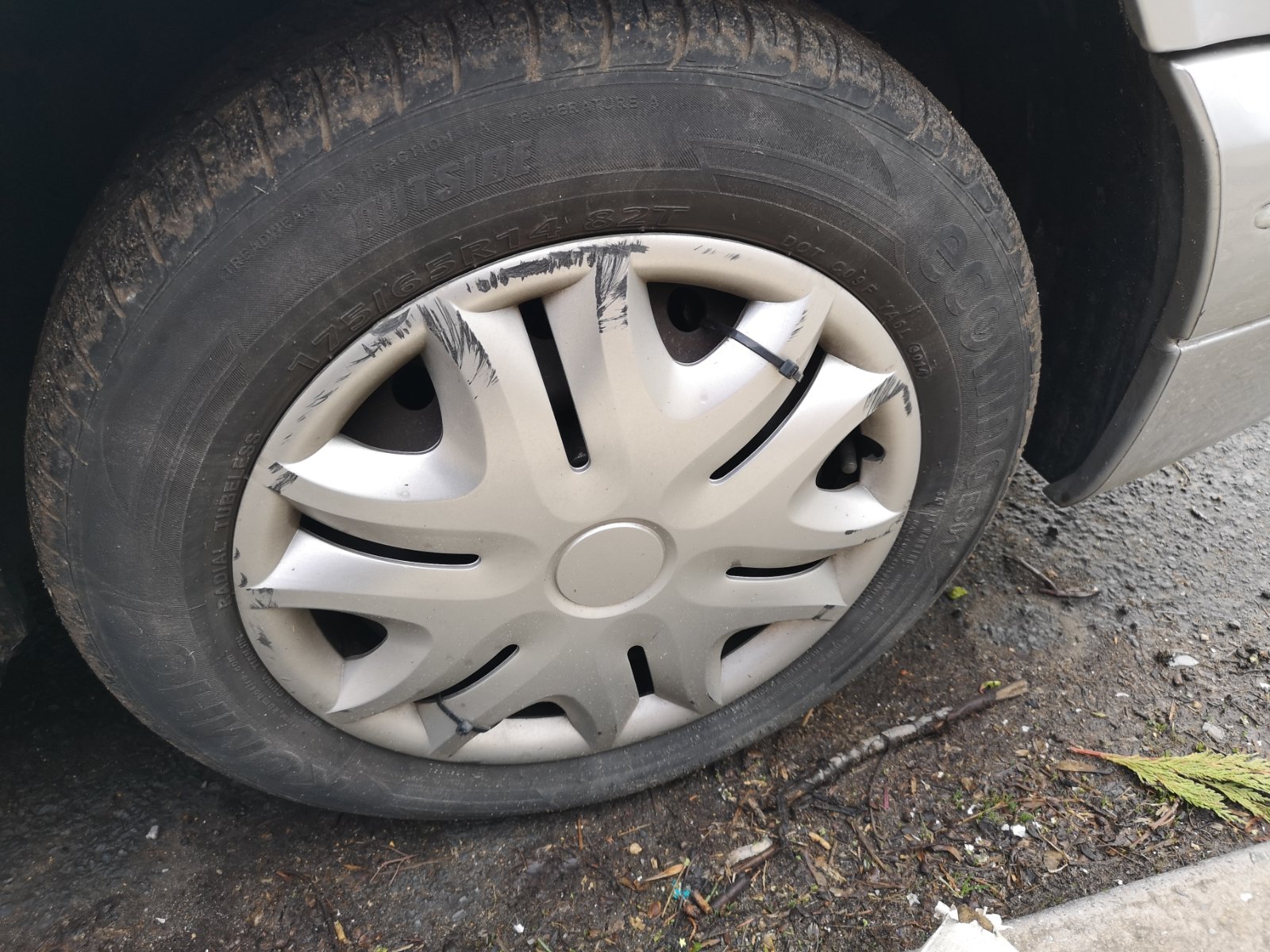

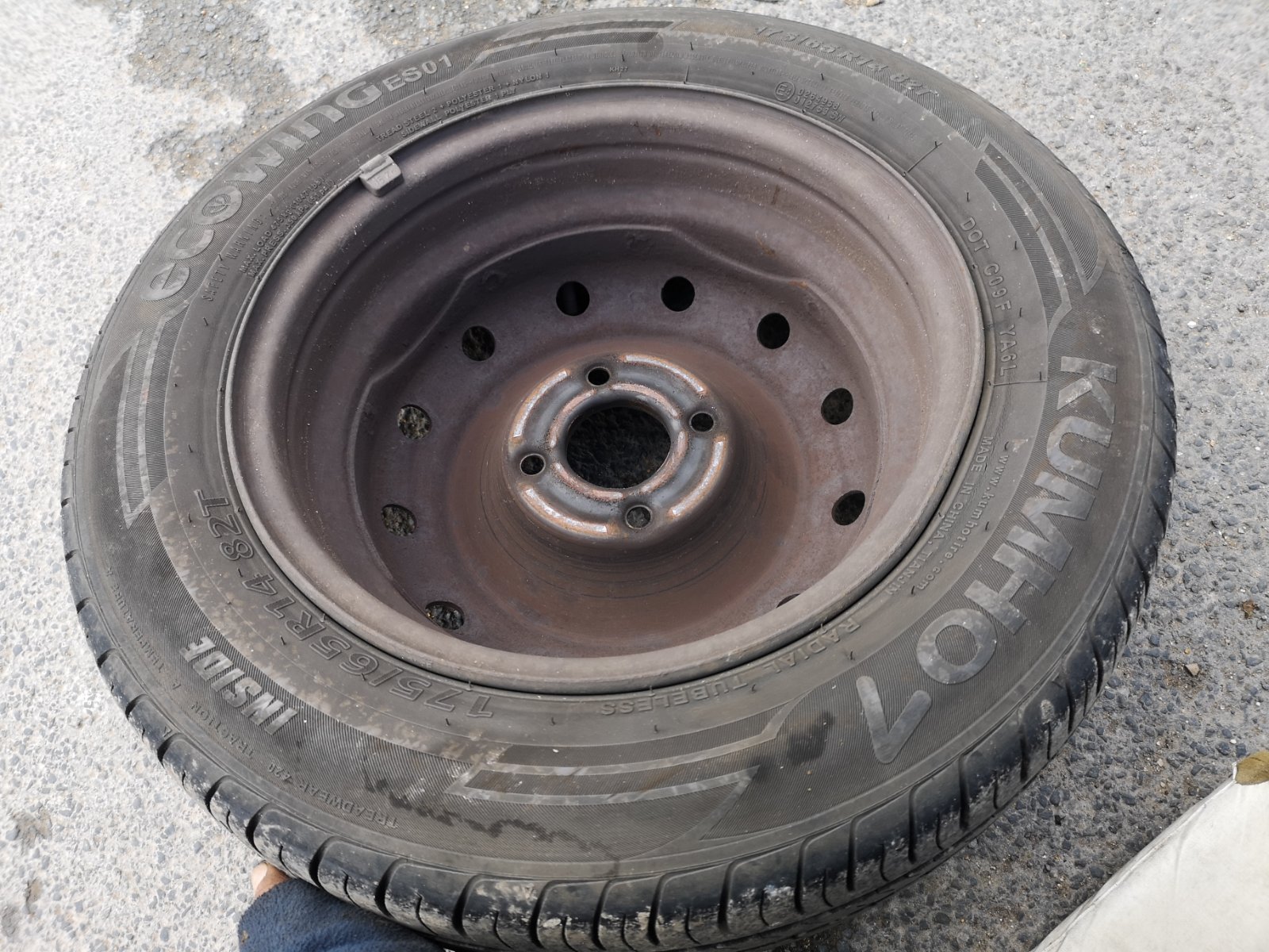

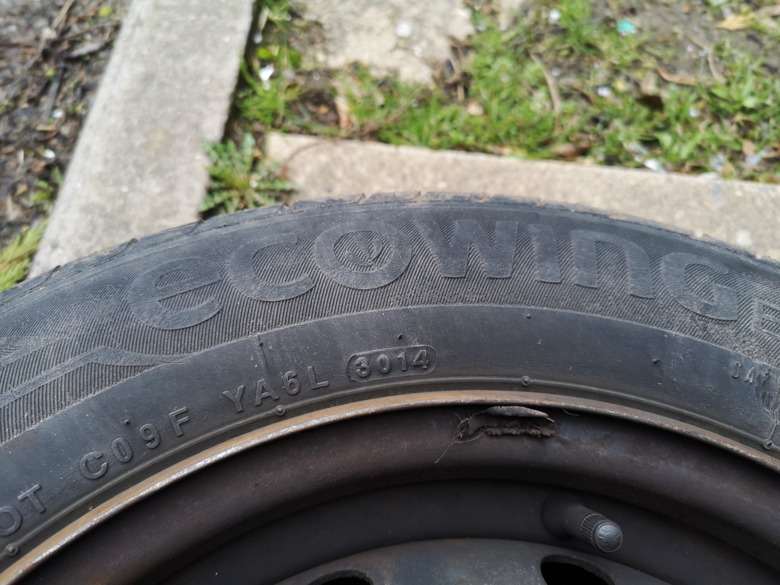

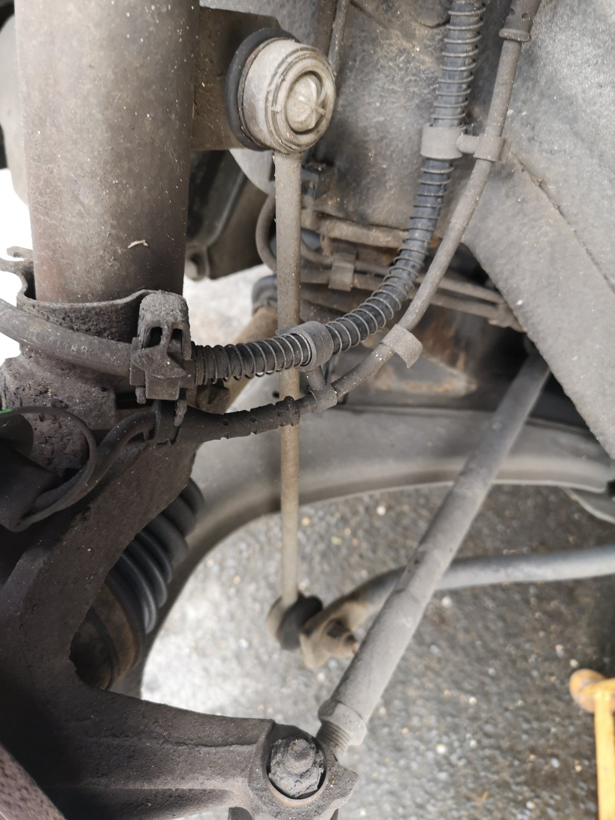

This morning! And I had some spannering to do. The shocking drivers wheel was removed... This car had an advisory for knackered tyres on the MOT in december and I think part worns were lobbed on, or these are the same tyres (the advisory was for tread depth though and this has plenty of that)
5 years old
Eek

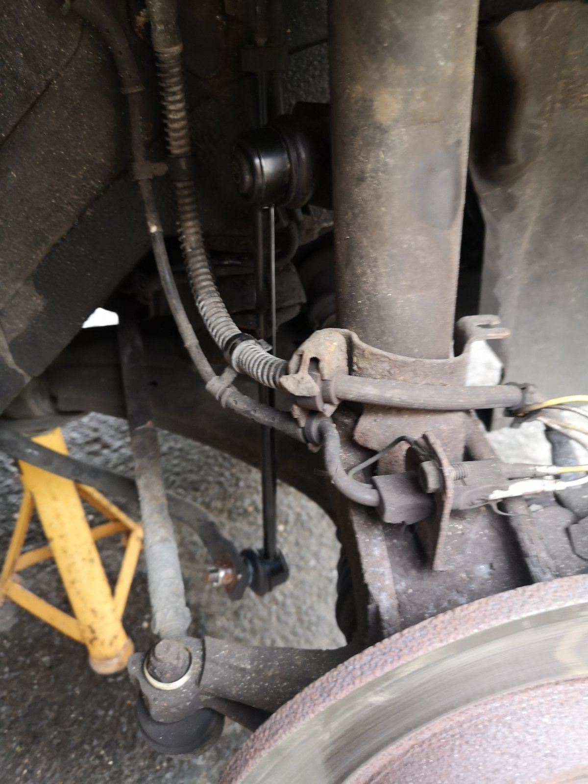

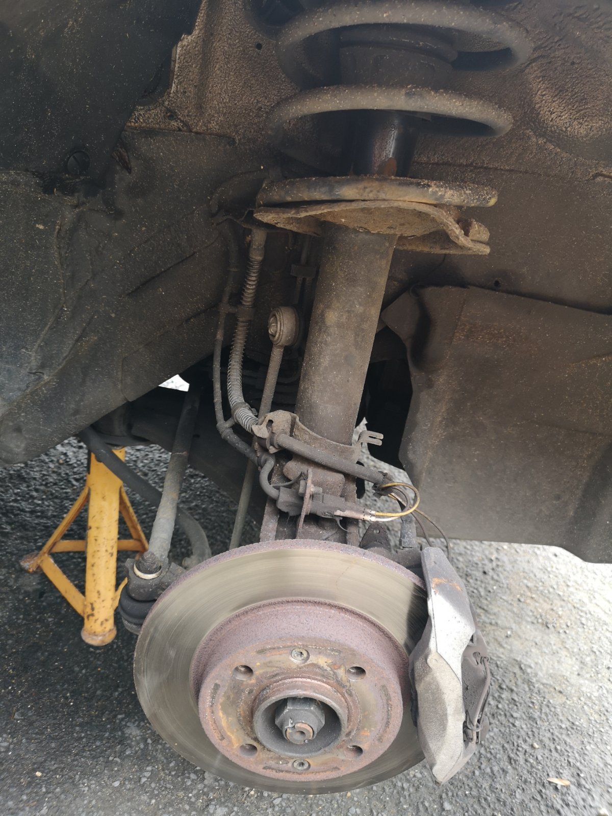

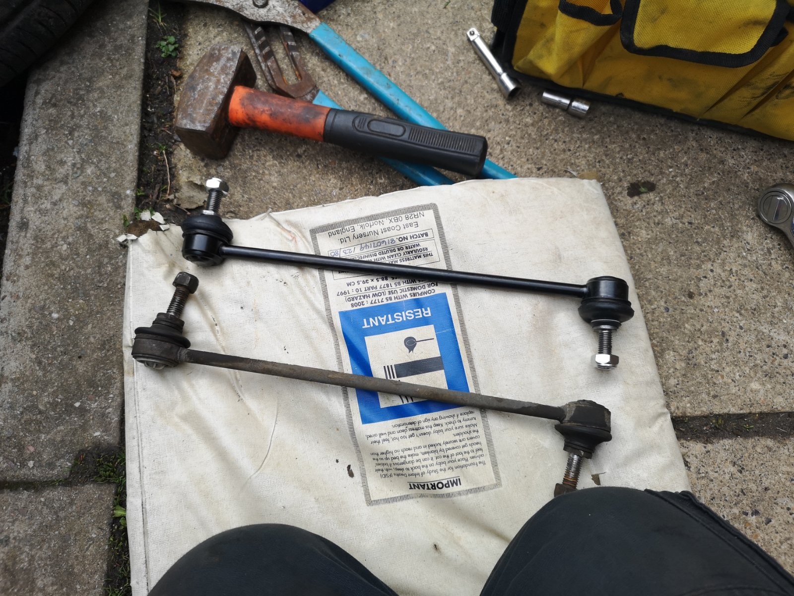

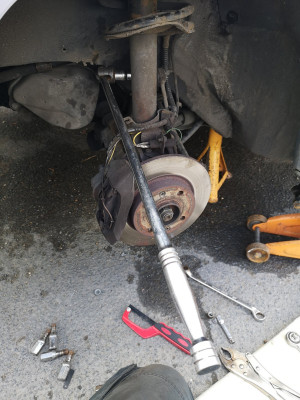

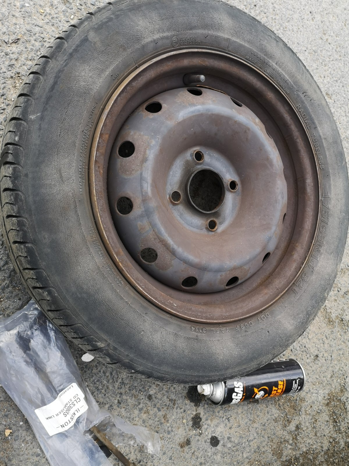

Anyway, we are here for the droplink

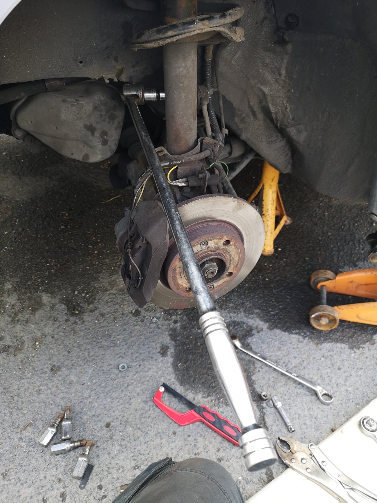

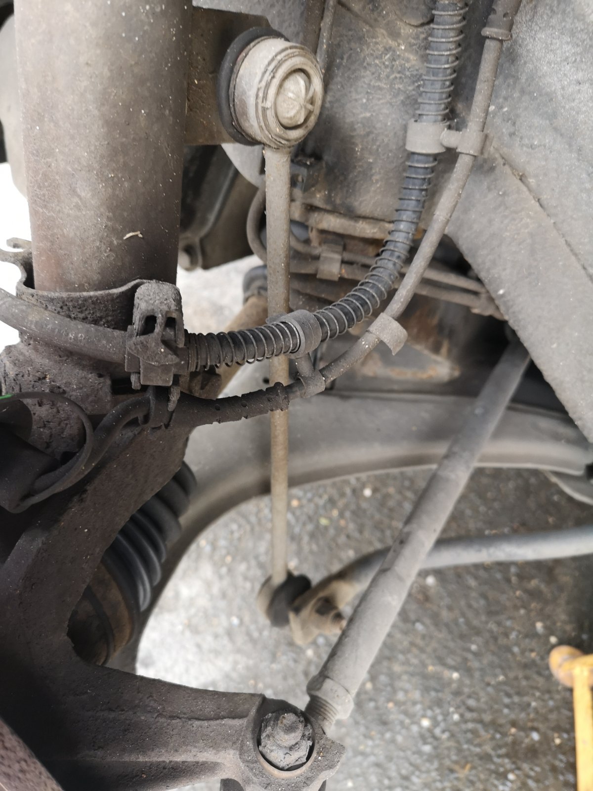

Because it's clonking like a right clonker! Removed
The guy I bought it from had meant to sort it but hadn't, so the new parts were in the boot which is my favourite kind of part! Shiny
Did the passenger side as well, and the tyre was worse if anything!
This side tried to be a sod, so 3 spanners were wedged in to keep the one spanner on the flats, and I deployed the persuasion bar
I won! All that done, I coppaslipped the faces of the wheels and the wheel bolts up and refitted the wheels. I then had a peek under the cambelt cover. The only paperwork I have with this car is a printout of the MOT history from the DVLA website (binned) and a properly dogeared owners manual (sat on the bookcase wedged to flatten) so I was half expecting to see string and bits of rubber, but it looks like it'll last the month

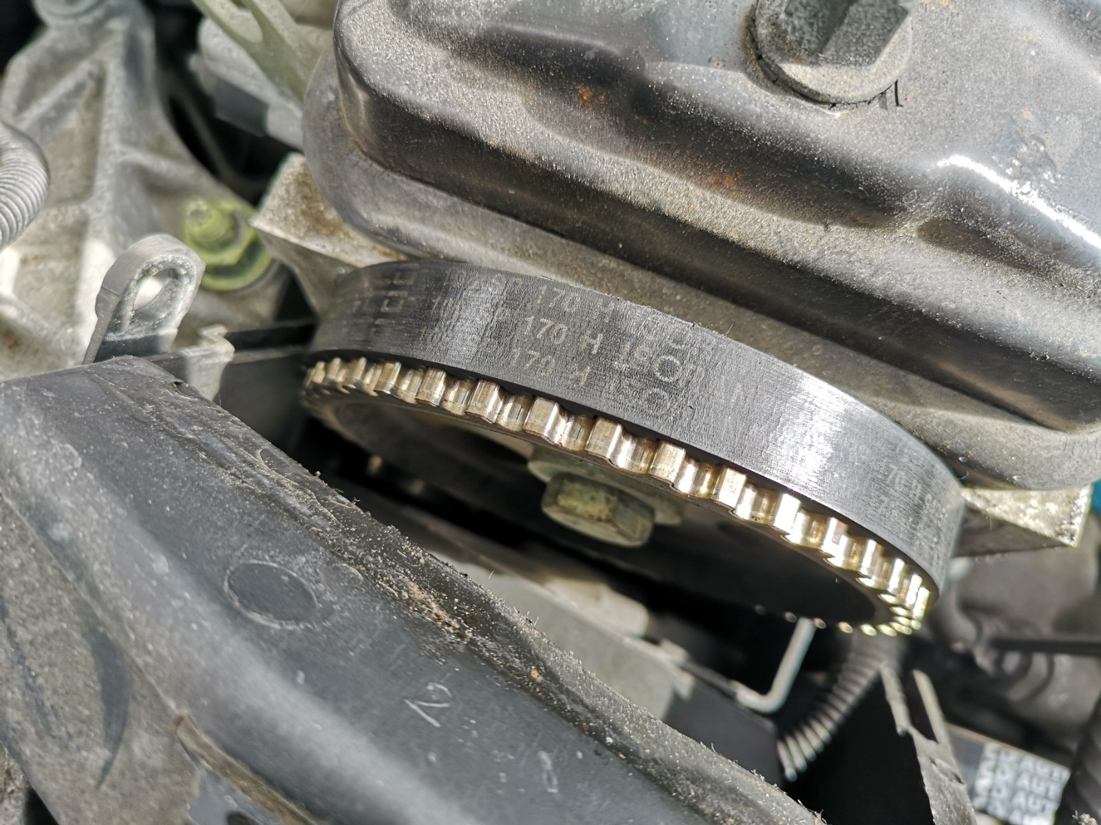

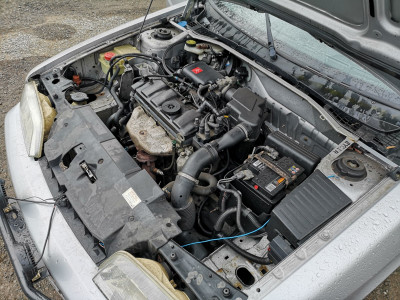

There is a very loud bearing-ey noise from the engine, that raises in volume with the revs. Ignoring that for now, aiming to lob a full cambelt and waterpump kit on it next month, if it's still there I'll have a look at the aux belt tensioners.

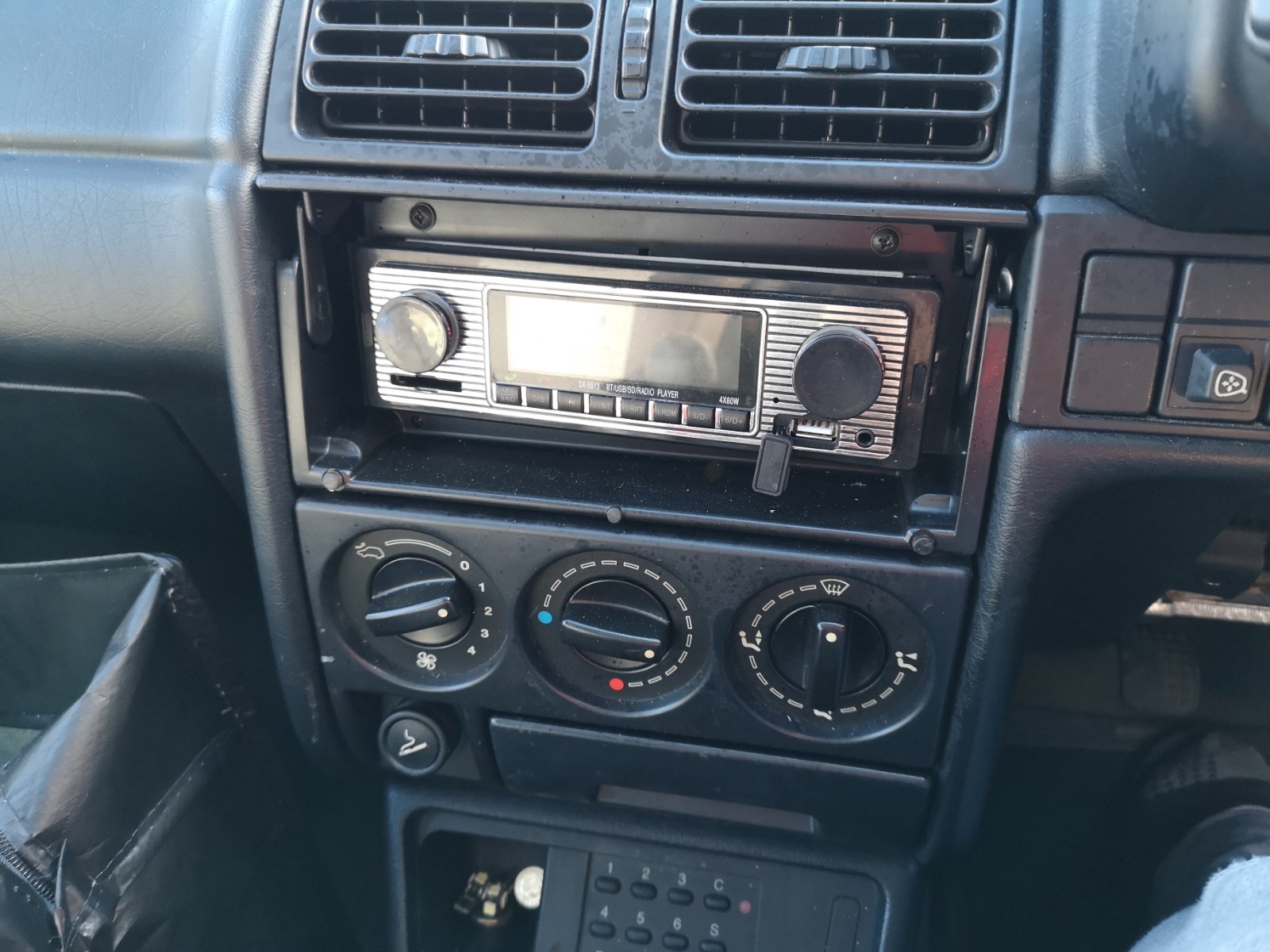

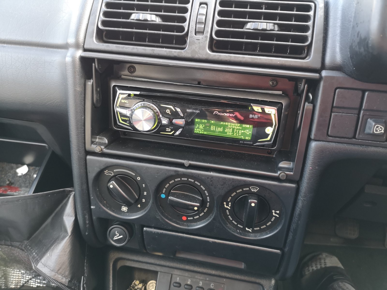

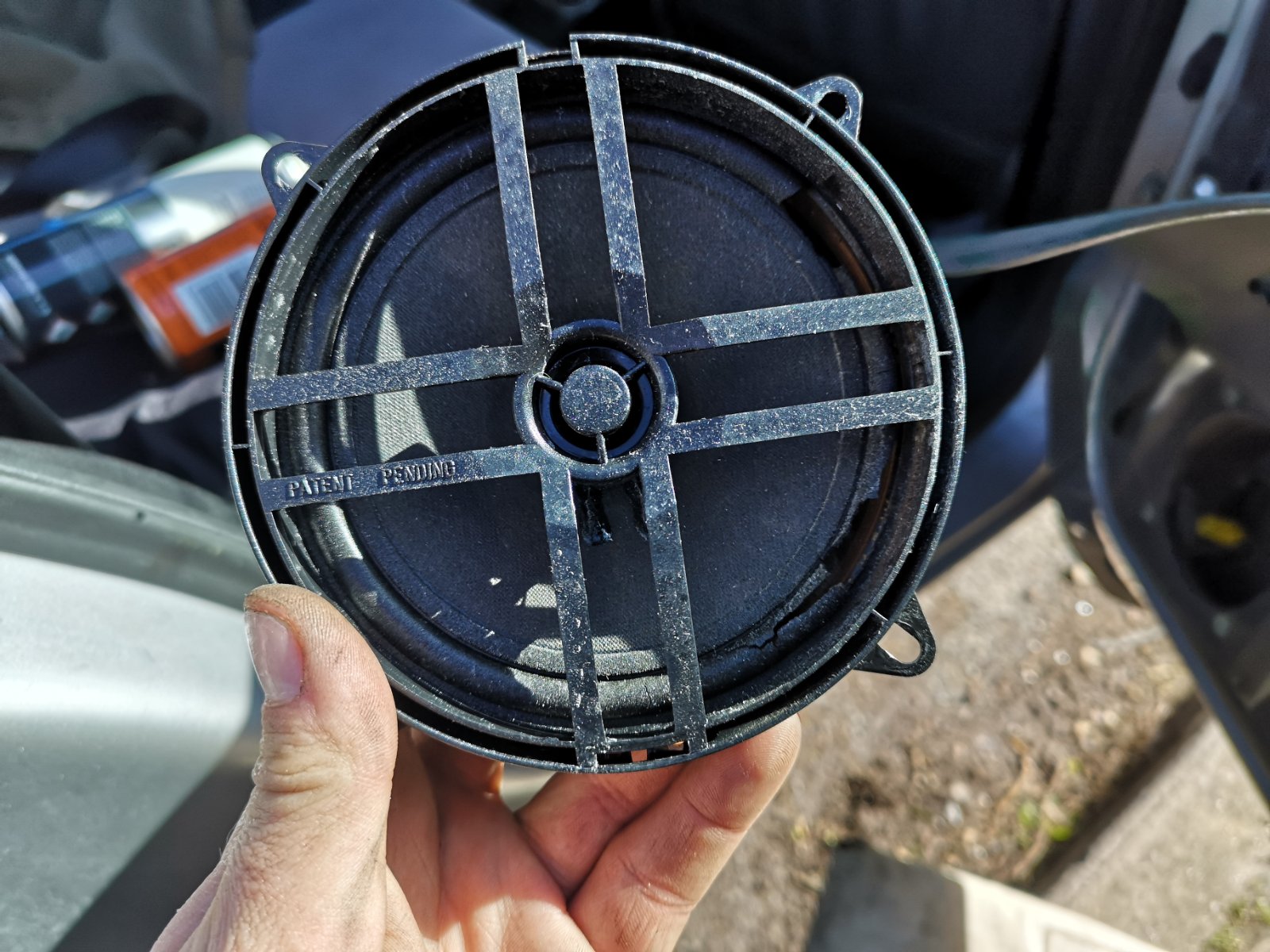

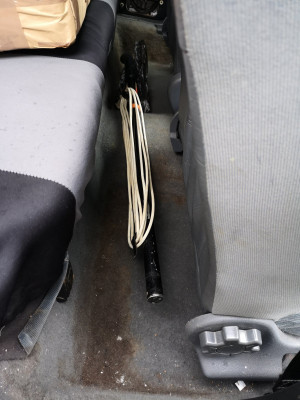

And fit and run the wires for my DAB aerial and phone mic. The previous owner had left an (awful) bluetooth headunit in so the guy who collected the car for me had some music for the drive from derby to Oxford, and I plugged my USB in for the last few days as well, it sounds like a terrible tape player!
But the thought was very much appreciated (I'm posting it back to him along with his wire strippers I found lying in the inner wings). But I need my Pioneer back! I bought this when I had my blue Laguna 3 years ago, this is it's 4th car... I've stopped properly running the cables for the DAB aerial now, the cable just comes in over the boot seal then gets tucked along the top of the A B and C pillar trims and door seals! Takes seconds to remove...
I set it to what I think is the same shade of green as the dash (see, having a radio capable of the full spectrum of RGB is handy, once you take it off stupid flashing disco demo mode). Need to double check in the dark though.

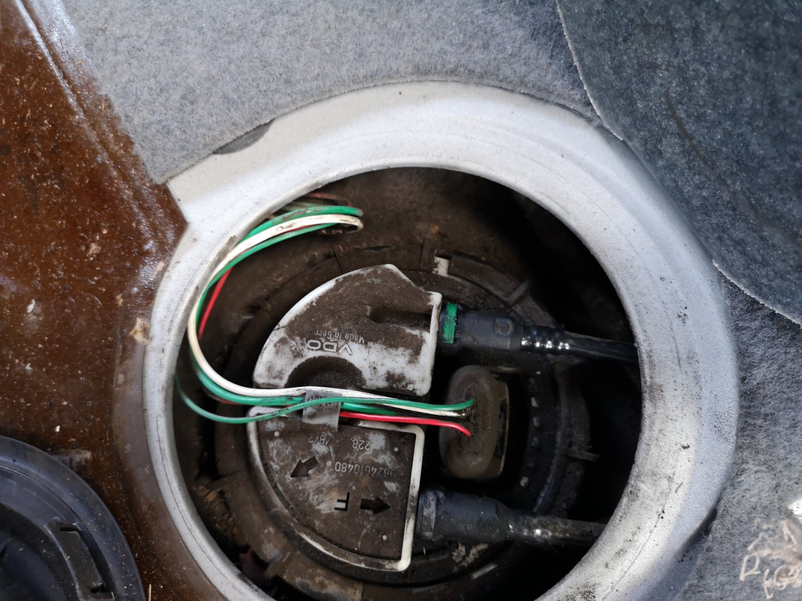

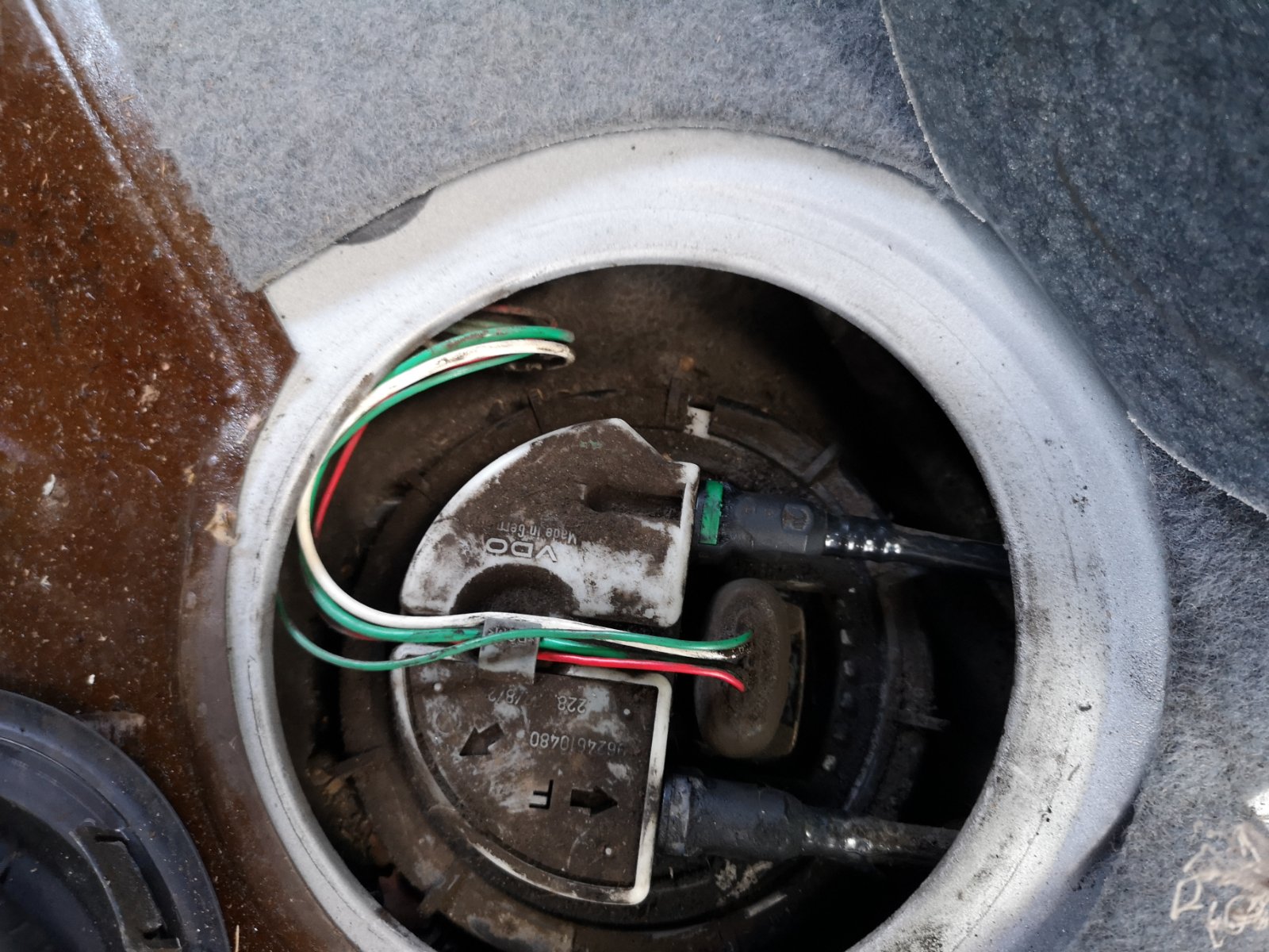

I then went to have a look at the fuel sender, to see if I could fix the comical fuel gauge. However, the sodding thing snapped with the 4th light tap with a hammer and screwdriver...
Luckily only a small part of the retaining ring moved, and the sender is still firmly stuck down with crud so I backed right off, need to source a new retaining ring now! I packed up all the tools, and as this was about 2.30, and the sun was shining and a gale still blowing, had a look at the mouldy passenger footwell

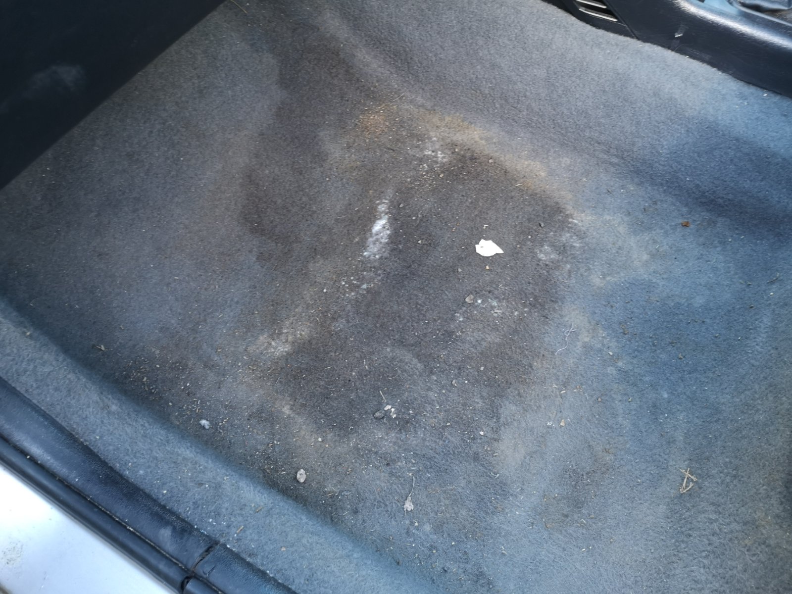

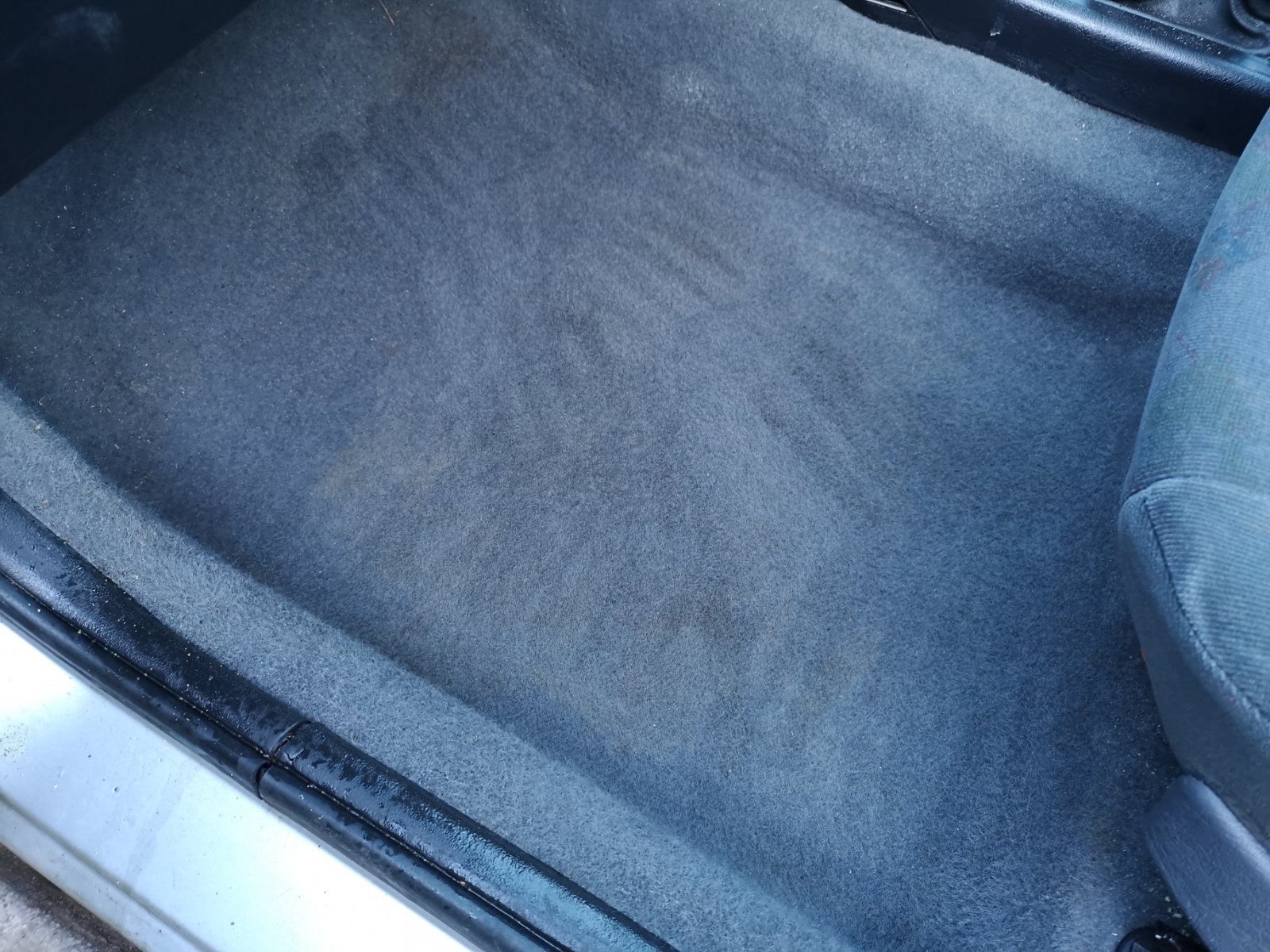

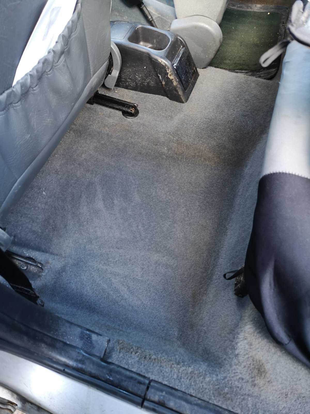

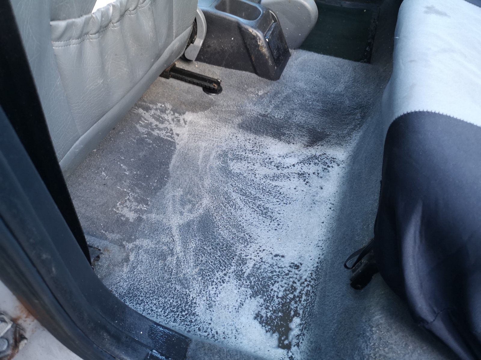

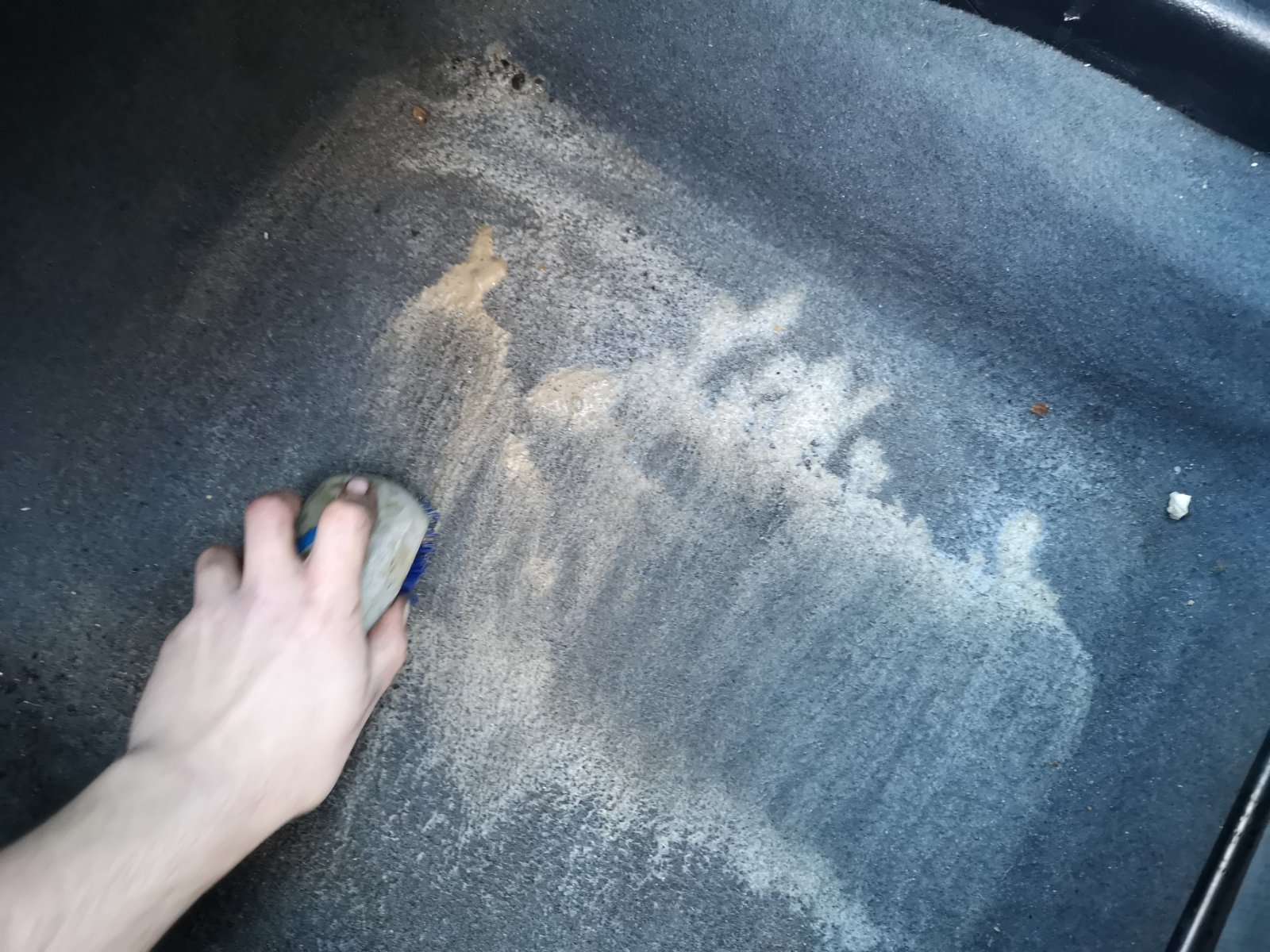

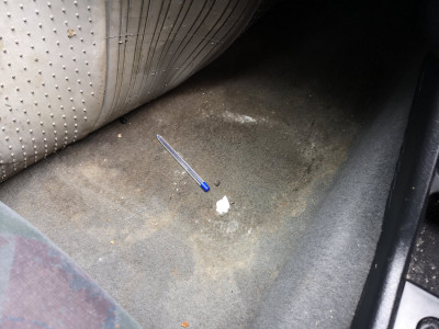

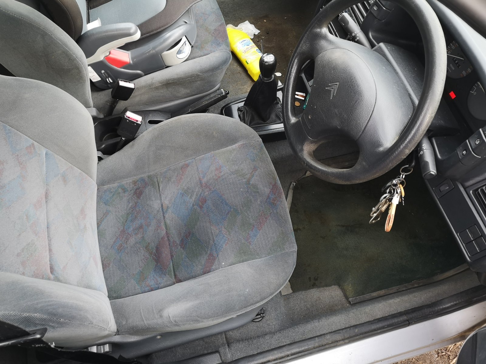

Using a load of hot water, with a slug of bleach and G101 I sloshed that about and scrubbed it right in, then sucked it out with a wet vac. Did that 3 times and it came up really well!

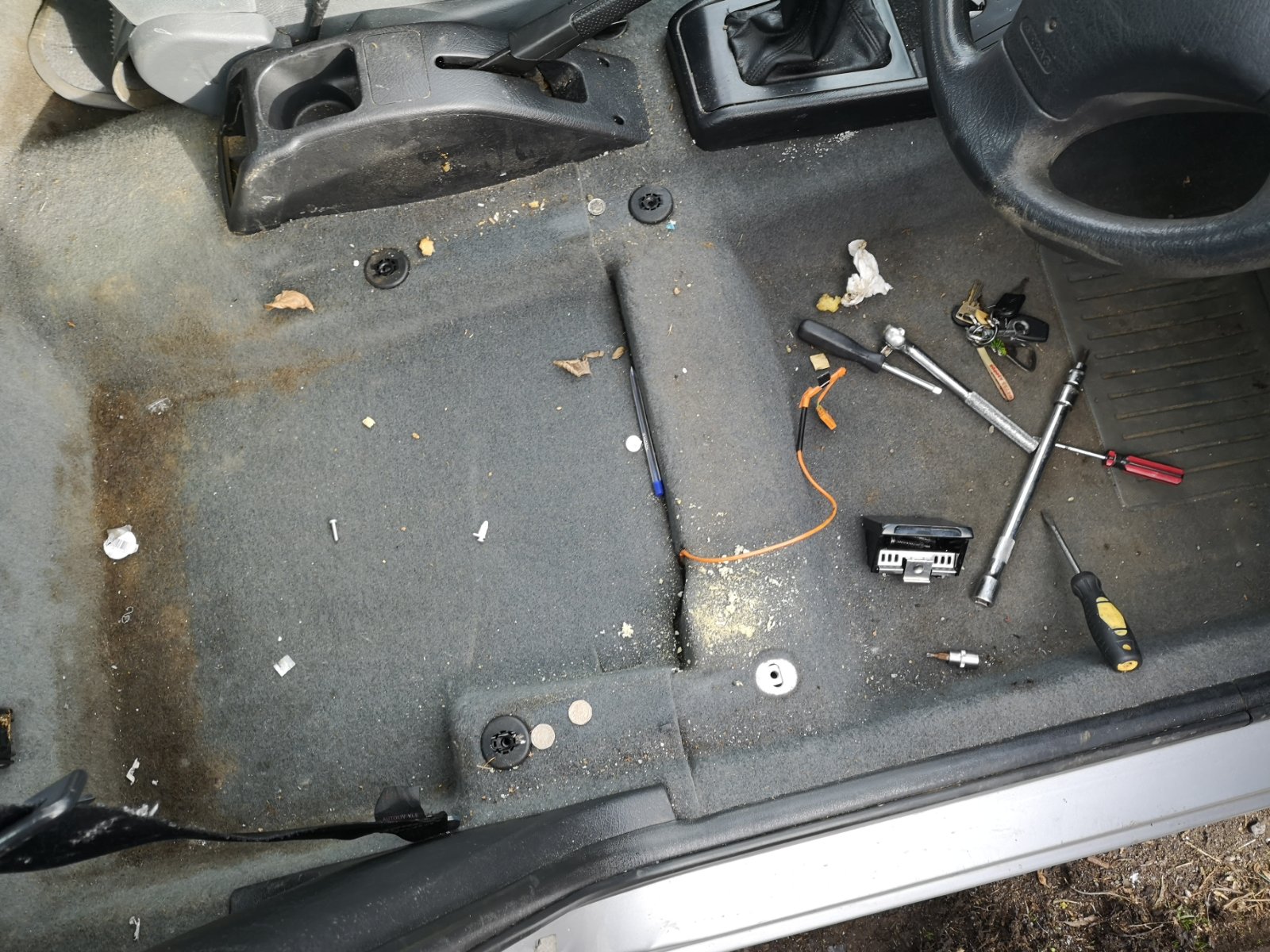

I had a load left, and the carpet was coming up really dry (which was something I was worried about) so I did the rear passenger footwell too
The vax told the tale...
It all needs doing properly, but it's a vast improvement and now it smells of bleach and G101 which is 600% nicer than it smelt before! I took advantage of the weather and opened every window and sunroof and left it until it got dark, smells very fresh in there now
When I get 5 minutes I'll find the proper upholstry shampoo tool for the vax, have the seats out and use a combination of sloshing water in, scrubbing, then rinsing it through with g101 and hot water in the vax, then fluff the carpet up with the steam cleaner. For now though, I no longer have to hold my breath as I get in before opening a window!

5 years old
Eek
