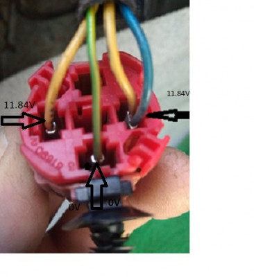

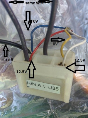

May be some additional info might help. I've checked the voltages on the terminals of these two sockets and here are the results. the voltages were measured with the ignition off. sorry for the poor quality - I've made it with the "paint", which I'm not very familiar with. please be advised that the cable leading to the white connector (conn2) is a shielded cable.

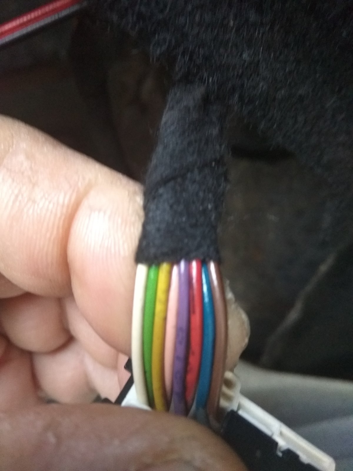

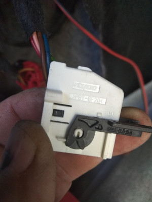

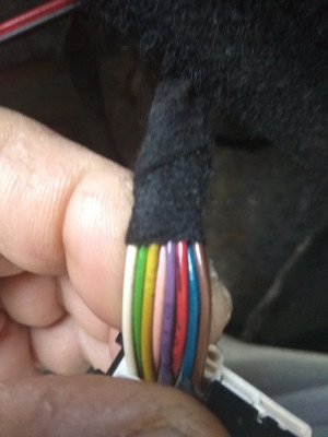

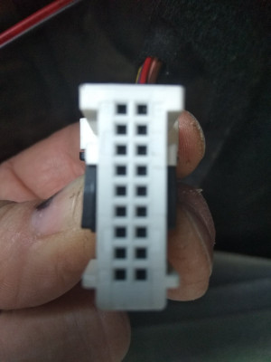

My search for the mysterious connector for the tow bar electric, yield another connector, well hidden of the lefthand side of the luggage compartment. I really hope that it's indeed the right one. attached a picture of it.

To try and identify it, I need to know how many pins are in the socket (used or not) and how many wires go into it and what colour are the wires.
However that is the right sort of connector that goes into a PSA BSI or other fuse box like the trailer unit, so you may well have found the connection, but I can't be sure.

the socket has 18 point - 2 rows of 9, as you will be able to see in the pics and there are 8 wires goes to it. the colors are as follows: brown, blue, red, pink, purple, yellow, green and white or light beige. I hope it helps. is there a way to know purpose of each wire?

I don't have any of the paperwork with me but that does look like the plug that fits in the socket that's underneath the LH blue fuse.

There you go I think Paul has just confirmed it

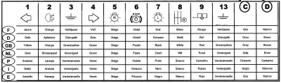

This is what I have:
C & D are the bottom Brown & Grey wires in the bottom 2 arrows in the last picture.

That's the microswitch that registers if a plug has been inserted, or not, and informs the BSI so that the braking profile can be altered.

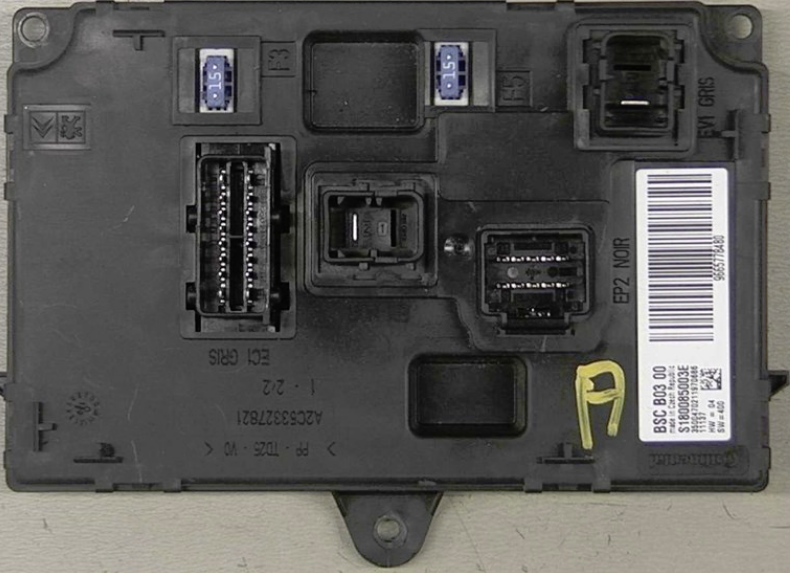

As Paul says ^ everything is there - but the plug in your photo is designed to fit into a the correct Citroen 'BSR' trailer unit. Then the electrical harnesses all plug back into the relay unit with some other connections to be made. It's one advantage of having a proper kit - it is adequately designed for towing, is suitably fused, and interfaces with the vehicles BSI and Engine Fusebox, as well as the ESP / ASP system to provide adaptive braking and stability programmes to account for towing Avi.
