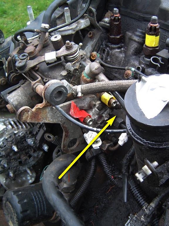

The bolt that I was referring to that's a proper Pain in the 4X is the one marked '3' on your diagram.
I strongly suspect that the fourth bolt is in situ correctly, but just in case, its approx location is marked on this not particularly good pic: fixing is not visible but is close to where the arrow points, just behind the pump (bolts to the block).
This one's a doddle to get at and I'd think unlikely to be any issue with that
[NB: spare lump, injection pipework absent]

Pug_XUD_KeenAmateur wrote: 05 Dec 2017, 19:46 The bolt that I was referring to that's a proper Pain in the 4X is the one marked '3' on your diagram.
Isn't it just :twisted:
You need to ensure it and the pump flange nuts are done up tight too as there's a lot of vibration in that area of the engine and they will soon come loose if you don't...
A wobbly pump will cause the belt to run offline but they should not have needed to disturb the pump when doing the belt :?

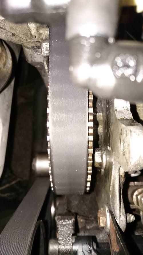

Picked it up again, the garage have diagnosed it as the pump being slightly not straight., apparently it was the plate behind the sprocket (not the bracket, apparently. I'm not 100% sure what he's referring to)
£80 has got me a new belt and the pump realigned. Knock £25-£30 off that for the belt, I guess £50-odd isn't worth arguing about as I care about keeping them sweet.
Hopefully that's the last of it.

Me too. The photo is so I can compare it to make sure it isn't moving across at all.
I notice it's starting to have those marks on the back of the belt again though. Should I worry about those?
Posts: 54992
x 8325
Re: 1999 DW8 Dispatch - Timing belt hanging off the edge of the fuel pump sprocket
kenbw2 wrote: 06 Dec 2017, 18:04 I notice it's starting to have those marks on the back of the belt again though. Should I worry about those?
Not necessarily Ken as the belt contacts the side cheeks of he crankshaft sprocket in the normal course of running...
They should only be light witness marks and should not cause damage to the integrity of the belt by taking small lumps out of it, putting small tears into it or causing roughness on the belt surface...
Over time those witness marks become quite polished and smooth..
