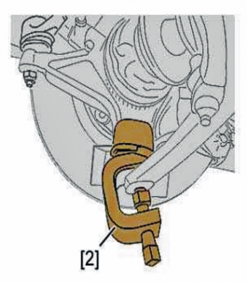

Remove the pivot ball-joint nut.
Uncouple the ball joint Using tool [2].
Detach the drive shaft from the hub.
