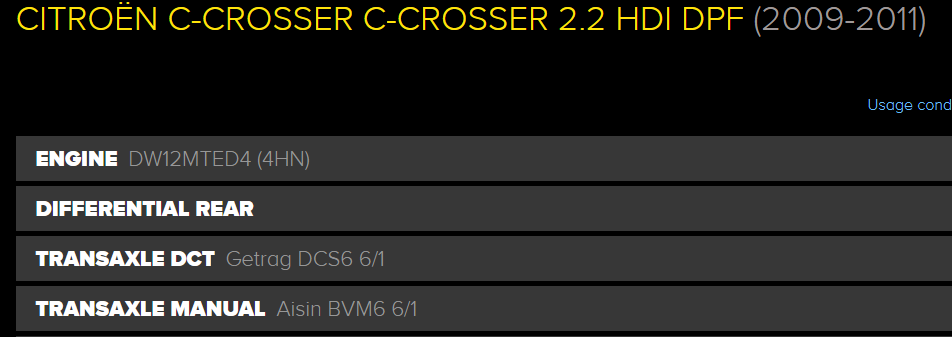

EDC5
- Posts: 1218
- Joined: 01 Jul 2017, 21:48
- x 131
Re: C Crosser, Dual Mass or Solid Flywheel
Stumbled upon this:
Looks like an Aisin manual gearbox and a Getrag auto on the C-Crosser.
- x 6960
I’ll have to look for a 2009 model 2.2 to see if they changed to that or whether they have always been the same on the OP’s 2007.
