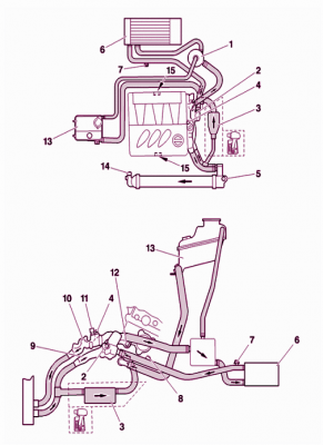

- x 6963
Re: Nightmare-ish XM ES9J4 coolant bleeding
Info on Cooling System for Ref:
So the fans run together but at 2 speeds - low at 96° and the higher speed at 101° if I'm reading this right.
Click Table to Zoom
(*) Degassing chamber plug with violet marking (inscriptions on top).
N.B. : The 2 fans are controlled by the coolant temperature housing.
| (1) Bubble trap. (2) bleed screw(s) . (3) Oil / water heat exchanger. (4) bleed screw(s) . (5) bleed screw(s) . (6) heater matrix. (7) bleed screw(s) . (8) temperature switch. (9) Water inlet housing. (10) Coolant outlet housing . (11) Temperature sensor . (12) Temperature sensor . (13) Header tank. (14) drain plug. (15) drain plug. |
| Reference | 8 | 11 | 12 |
| sensor | Temperature switch | Temperature sensor | Temperature sensor |
| Information | Coolant temperature : Gauge | Coolant temperature : Warning | Coolant temperature : injection |
| Connector colour | Blue | Brown | Green |
| Tightening torque (daNm) | 1,7 | 1,7 | 1,7 |

Late to this thread, so will try to catch up.
I replaced the radiator in my Xantia V6 a couple of years ago and didn't have any difficulties bleeding the system. And then at a later time replaced the thermostat and bled the system again. I think your procedure isn't right and your expectations of what should happen are a little bit out...
Finally the green sensor is near the front corner of the engine on the thermostat housing - this is the one that goes to the engine ECU.
While the blue sensor controls the gauge reading on the dashboard, it's actually the brown sensor that controls the fans which lights the red over temperature warning light within the temperature gauge. So if you get a faulty connection (open circuit/high resistance) on the brown sensor on the side of the block it will cause the fans to instantly go to high speed and the red over temperature warning light come on.
If the temperature gauge reading is normal at this time then it's almost certainly a fault with the brown sensor wiring. Using contact cleaner on the sensor plug might be worth trying. It can also be caused by a bad connection on the "bitron" control module which is the control unit for the fans. On a Xantia this is mounted under the left headlight with a long plug with a slide release - not sure where it is on an XM!
The way I did mine is to open all 4 bleed screws and leave the expansion chamber cap off, then start to slowly pour coolant into the expansion chamber. One by one from the lowest to the highest each bleed point will start to flow coolant - as soon as it flows coolant close that bleed screw then continue pouring, when the next one starts flowing, close that one and continue, keep repeating this until all 4 bleed screws/caps have flowed and been closed, then finish filling the coolant level until it's about half way up the expansion chamber. Don't overfill the expansion chamber.
Only at that point would I start the engine. Just let it idle do NOT rev it up - there's no need. It will take a good 5-10 minutes for it to warm up sufficiently for the thermostat to open, you can tell when this happens by monitoring the temperature of the upper radiator hose with your hand - it will stay completely cold for 5-10 minutes then all of a sudden within a few seconds it will start to get hot, this is the thermostat opening.
At this point it will probably gurgle through the open expansion chamber filling hole as new pathways are now flowing in the block and the coolant level may go down a bit. At this point you should top up the level again, but no higher than half way. Once it's idled for a few minutes with the thermostat open and flowing you should put the cap on before it gets any hotter.
I think your expectation that you should be able to reach the high fan speed is mistaken - under no load at idle or even holding 2000rpm it should only heat to the low fan speed, then cool down enough for the fans to go off again. Going to the high fan speed with no load would actually indicate a fault.
So when the dashboard gauge says 90C the coolant in some parts of the engine can easily be over 100C. Because you have the cap off the system is not pressurised so will boil just above 100C. So by leaving the cap off you caused some point in the cooling system to boil, this will spray water and steam all over the place through the filler neck. I've actually done this myself once by accident by forgetting to put the cap on immediately after finishing topping up after bleeding.
To see the true engine temperature at the thermostat, use a Lexia and look at the temperature reported by the engine ECU.

This is not the way I would do it. There's no need to have all the bleed screws open while running the engine with an ES9J4, and it may actually result in air being sucked in. There's also no need to rev up the engine and this may also contribute to sucking in air through the bleed caps.Now that i have replaced radiator, thermostat and sensor, it was time for coolant system bleeding. If i understood correctly its pretty simple overall. Just put revs between 1500-2000RPM, open all four bleeding points and keep around 1 extra litre of coolant in expansion chamber while engine is running. Process is done after all air is out, BOTH of fans have spinned and warm air is coming in.
As others have pointed out later in the thread, both fans always run together - either slowly or fast. If only a single fan runs then there is a fault. It sounds like your low fan speed was not working and you have now fixed that.So i did that all and everything was going fine, air was coming out from system, and car was blowing warm air in to cabin. Temperature was precisely at 90 C when first fan started to blow. Around same time thermostat opened, system sucked almost all that extra coolant and no more air was coming out from the system. Nice, all i had to wait was the second fan to spin and i was DONE. Except it didn't. Engine didn't just get around 100-110C to get second fan running.
And at this point i started to have trouble. After waiting for some time, still only slower fan has blown few times, everytime at 90C. So i thought if i rev engine bit more than 2000RPM, maybe it will heat just enough and im sure both fans will start run.
The dashboard temperature gauge runs from the blue sensor on the back of the block - this measures the return temperature from the radiator, not the flow temperature from the thermostat. So it always reads 10-20C lower than the true temperature at the thermostat.Instead of that what happened, was coolant level started to RISE slowly in expansion chamber and all the sudden it simply blew everything up around engine bay.
At that point i had no idea what happened. According to temperature gauge, car didn't overheat. Temperature didn't really go much over 90C.
One thing that came to my mind was blown head gasket, but im not sure about that. System isn't closed so therefore it can't have too much pressure in it? And before changing parts i had no problems at all.

If you're going by the dashboard gauge this is to be expected - as in my previous post it reads 10-20C lower than the true temperature. I would only go by the Lexia reported temperature, where it will go on to low speed at about 94C and high speed about 104C.Raatokalle wrote: 08 Mar 2019, 19:22 Problems
1. Unlike earlier, now i don't even hit 90C before fans start to blow. Fans start now at 80C and in 2h of idling only once temperatures went to 90C.
Car is still blowing very warm air into cabin tho.
By revving the hot engine up with no system pressurisation you're causing "kettling" on hot spots in the coolant channels that is generating small steam bubbles - by leaving the cap off you're causing the exact problem you're looking for! Normal operating pressure is about 1.4 bars and this will raise the boiling point of the coolant a lot. The steam bubbles are only forming because you left the cap off.2. Im kinda worried about blown head gasket. Only symptom related is to it, is bubbles coming out when i rev.
But the thing is, it doesn 't do that all the time. For a long time i thought all air had come out, but all The sudden when i quickly rev'd to around 3000-5000rpm, some bubbles came.
It's not enough to put the cap back on when the engine is already hot because that won't pressurise the system as the water has already expanded. You'd have to put the cap on and let the engine fully cool down, allowing air to be drawn in through the one way valve in the pressure cap, then next time the system heats up it will pressurise and everything should be fine.
Gosh, im getting paranoid. Should just stick with BX's![]()
Yes you are getting paranoid.
One other thing to consider at least on the Xantia is that the split welded coolant expansion chambers are notorious for developing a leak around the seam. This can prevent the system from pressurising correctly. They typically only last about 20-30k miles before needing replacing! I had to replace the expansion chamber on my first Xantia V6 when I bought it, and on my second Xantia V6 as well.
My second Xantia V6 had only done 65k miles when I bought it and the service history showed that the expansion chamber had already been replaced twice before and then I had to replace it again! Average time between replacements was only 25k miles.
Not sure if the XM uses the same unreliable expansion chamber, but if so I would be looking very closely at it for any signs of leaking around the seams! It's critical that the coolant system remains properly pressurised when operating under a high load.
