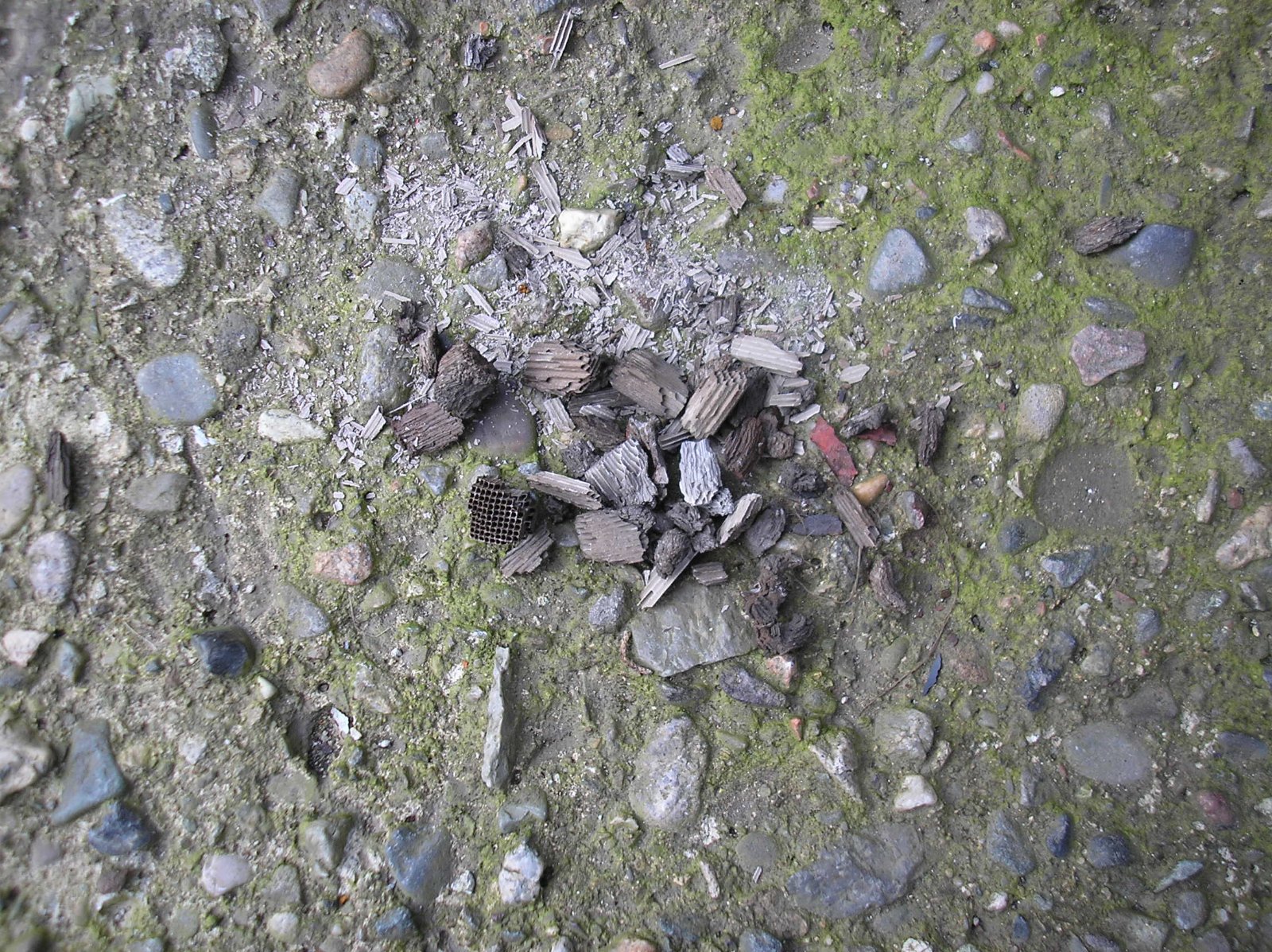

The exhaust cam cover "breather" is full of crap and still being cleaned. Although the exhaust cam cover is a little bigger than the inlet and has the oil labarynth, the weight difference is quite remarkable, due no doubt to the crap that is in there.
I suspect the last owner poured oil over the engine rather than in it as oil stains in cam belt area, maybe power steering fluid?
It's had a good clean in that area.

I was slightly mis informed, the mil light came on on his way to work after about 8 miles going up an incline which is not that steep but fairly long.
Anyways I had the car back and the code was for a cat problem again, the same as the last time.
So i removed the tail exhaust box, it rattled. Thats corroded a lot in the 4 months its been on i thought.
I tipped out the corrosion and saw what i first thought was burnt wood, and on closer looking saw bits of the cat internals.
As suspected due to the misfire, fuel injection and glowing yellow hot cat, its been "roasted". A new one was got and the old one removed only to see a large ball of roasted cat internals.
New cat and sensors fitted, and the rest was re fitted. The rear of the middle section was a bit corroded and holed by the rubber hanger finger, so that was repaired.
Its due to be finally buttoned up this afternoon and road tested.
God i hope this is the end of this particular chapter of the saga, but i know there will be more to come.......
will report back with an aok we hope.
see picture of cat internals that has made its way into the rear box.
ah picture not tooo clear but see the pile of bits in the centre, should have taken picture on a white back ground. Will take a pic of the ball inside the cat later. If you zoom in the bits show the matrix structure and some well melted/fused bits.
