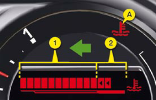

There is no actual temperature shown in degrees.... it is just shown as segments that should remain in Zone 1.
How long is it being driven for - it can take several miles before you start to get get any bars filling in. This is the gauge and temp segments will start to fill in zone one. If it is not putting any segments up after 5 miles then something may well be wrong. However the warning in red, shown at 'A' should show up along with the STOP lamp if it ever enters zone 2

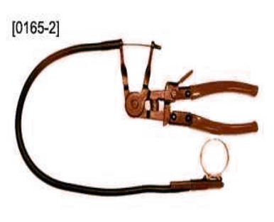

Uncouple the pipe (1) (at "a"); Using tool [0165-2].
  • Open the bleed screws located on the coolant outlet housing and the heater pipe.

Connect the hose (1) (at "a"); Using tool [0165-2].
N.B.: Refit new clips.

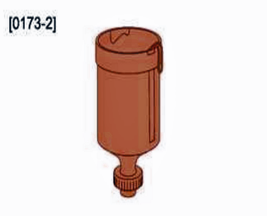

"A" : Fitting with filling cylinder offset; Using the tools [0173], [0173-B], [0173-C].
"B" : Fitting with filling cylinder direct; Using tool [0173-2].
  • Fit the filling cylinder, blank and adaptor assembly on the expansion chamber (according to assembly).
  • Open the rod on the filling cylinder.
  • Slowly fill the cooling system with clean coolant.
  • Close the bleed screw when the fluid is flowing freely without any air bubbles.
N.B.: The filling cylinder should be filled to the 1 litre mark for correct bleeding of the heater matrix.
