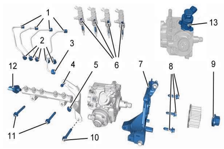

I'm about to fit a new injector but I can't find a torque setting for the bolt that goes through the clamp. It's a 63 plate Peugeot Partner 1.6HDI any help will be appreciated.

Here you go:
(Note: these tables are specifically for the OP's Peugeot Partner Euro 5 DV6TED Engine with Bosch Injection Only)
| Ref | Designation | Stage | Tightening Torque |
| (1) | Connections (Diesel Injector) | Pre-tighten Tightening | 2 daNm 2,5 daNm |
| (2) | Connections (Fuel High Pressure Pipes / Fuel High Pressure Common Injection Rail) | Pre-tighten Tightening | 2 daNm 2,5 daNm |
| (3) | Union (High-Pressure Fuel Pipe / Fuel High Pressure Pump) | Pre-tighten Tightening | 2 daNm 2,5 daNm |
| (4) | Bolts (Fuel High Pressure Pump Rear Bracket) | Tightening | 1 daNm |
| (5) | Bolts (Fuel High Pressure Pump Rear Bracket) | Tightening | 1 daNm |
| (6) | Bolts (Diesel Injector Fixing Flange) | Pre-tighten Angular tightening | 0,7 daNm 80° |
| (7) | Bolts (Fuel High Pressure Pump Front Bracket) | Tightening | 2 daNm |
| (8) | Bolts (Fuel Injection Pump / Bracket) | Tightening | 2 daNm |
| (9) | Fuel Injection Pump Pulley Nut | Tightening | 5 daNm |
| (10) | Bolts (Fuel High Pressure Pump Rear Bracket) | Tightening | 2 daNm |
| (11) | Bolts (Fuel High Pressure Common Injection Rail / Engine Block) | Tightening | 2 daNm |
| (12) | Fuel High Pressure Sensor | Tightening | 4,5 daNm |
| (13) | Bolts (Fuel Pressure Regulator / Fuel High Pressure Pump) | Pre-tighten Tightening | 0,3 daNm 0,7 daNm |
