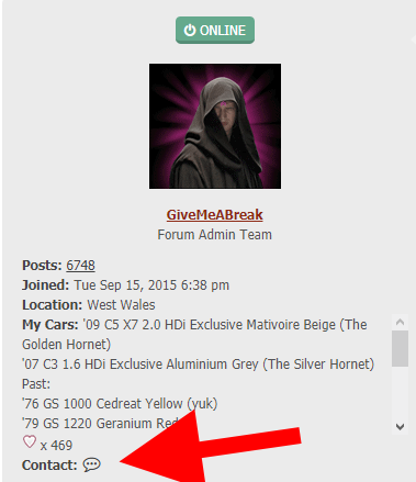

Just send me a Private Message - something obviously isn't working somewhere at your end:
Just click here on the speech bubble: Then click the left hand icon: This will open up a private message window already addressed to me. Just type or paste your VIN and hit 'submit'. Job done and I will get it instantly.

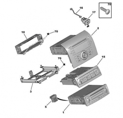

Ok, so now I have your VIN.
I'll be straight upfront here. This van is a Jumper III - joint PSA / FIAT collaboration with the Ford Puma engine! These are also similar to the Fiat Ducato vans.
As such, they are not true PSA systems, so I have no information or documentation on these. What I can tell you is:
1) It is a Blaupunkt system radio made for Fiat, part 1 in the diagram below.
2) According to the specs for your vehicle, I cannot see a bluetooth module listed, but the part is shown as part number 15 in the diagram above and is just referred to as 'Box'!
3) Part 15 in the diagram is commonly fitted to Peugeot Boxer, Ducato, Relay (Jumper) MK3 and is a Bluetooth Handsfree Module ECU. So it is this part that will handle the calls and bluetooth functionality and pass this on to the audio system.
So was this module (part 15) retro-fitted to the van at a later date or was it factory fitted to start with? The reason I ask is that if it was fitted at a later date, was it correctly coded and configured to the vehicle properly. If it was original or has been correctly coded, then I suspect that it is faulty - OR may need an update. How this is done will either be through an upgrade using the USB key or via a dealer level diagnostic tool like Diagbox and a firmware update via the PSA servers - if in fact it is possible to update this unit. Only the dealer will be able to advise you of this.
Here is a link to a replacement module - but I wouldn't want to advise that you replace it without first checking the route cause:
https://www.ebay.co.uk/itm/GENUINE-Peug ... 3207074923
I would also suggest that you delete the phone that is paired from the system and try re-pairing it again. I note you have an iPhone 7 - so what version of IOS is the iPhone on? If you have updated the iPhone to IOS 11 - it is full of bugs and has rendered thousands of iPhones unusable (especially the iPhone 6 series). IOS 11.2 has just been released to the public - you may want to try that as there were issues with bluetooth connectivity. Having said that - sometimes updating is not always a good thing if the newer updates cause compatibility problems with your van's older bluetooth software.

Thanks for all the details.
This obviously looks like the console I have
I have tried the re pairing weeks back, but same prob
Oddly enough an update with apple maybe 2 months back and the followin* day the problem occurred, whether by chance or is the problem. However my phone continues to work with my 59 plate Ford Focus with zero problems
I have tried via the menu on the van to run an update, which runs for 5mins, then comes up with an error, something similar to ‘update fail/error’
Like you suggest, maybe a module update, as I suspect Citroen will want £100’s and then tell me to replace it

Hi,
I bought a replacement module, installed it and paired.
My initial problem is/was still there and the tone almost happened immediately. I also noticed now i have changed the module the mileage flashes on the dash board, presumably because they are not synced. Any idea how to stop this?
i also tried the update (on both modules) which is found under settings and both modules come up with a config error? Any ideas on this too?
Thanks
