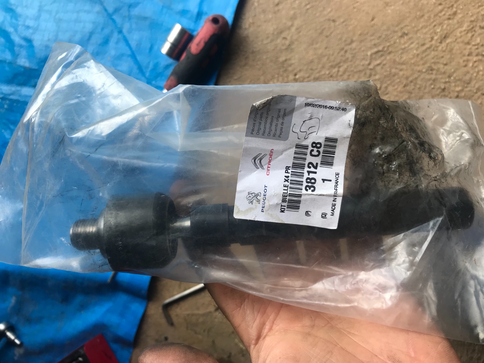

Re: Mk1 c5 driver side inner tierod end

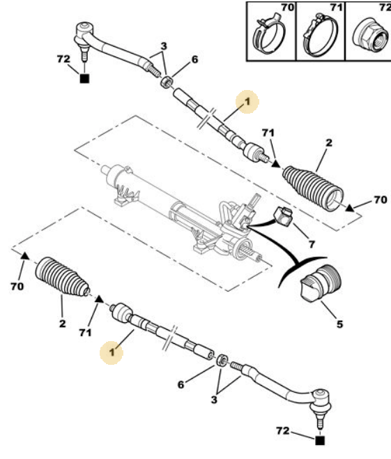

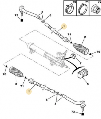

This is the part I am replacing
- x 6955

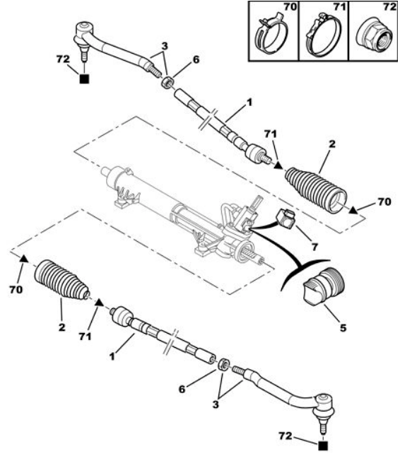

Item 1 Tie Rod Assembly Richard - part is under Steering Rack Components.

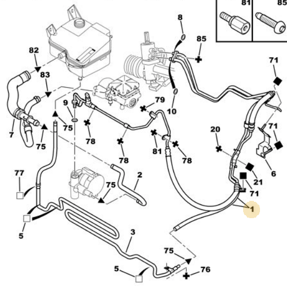

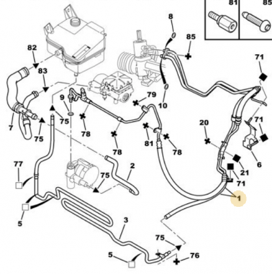

cornesoutafrica wrote: 16 Feb 2019, 06:07 My question is. I noticed the driverside got a small low pressure return pipe connected to the boot which I somehow need to loosen the clamp of to get access to the inner tierod end. Should I just pry the pipe off end somehow get the inner clamp off?
Are you referring to the Power Steering pipes Corne?
Item 1 is the High Pressure Pipe (s)
Items 2, 3 & 7 are the Low Pressure Pipes.

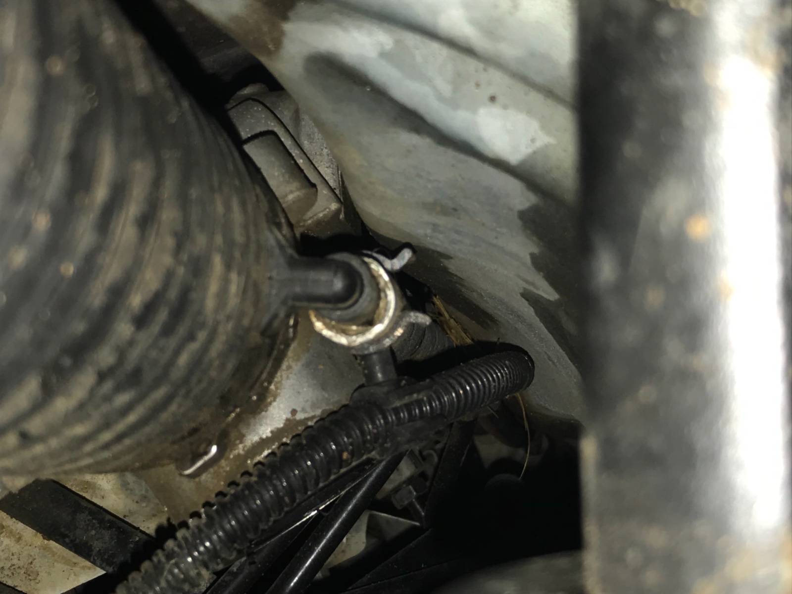

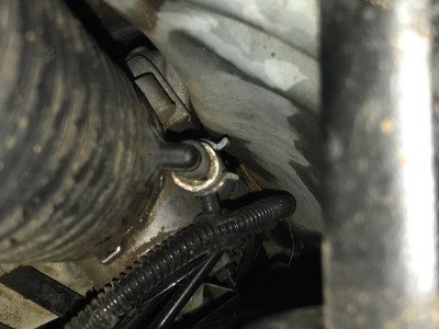

Here is a picture of the lowpressure pipe onthe steering boot I referred to.
Strange that it is not on the spares diagrams

That looks like a DIY job to me - there's nothing like that on any of the racks I've ever seen. Maybe somebody has used another boot which had a return pipe - so had to route it to the LDS tank manually as they couldn't get the proper boot?
That corrugated pipe looks like some basic sleeving protection for electrical wiring - maybe protecting a rubber pipe within.

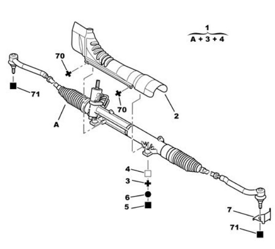

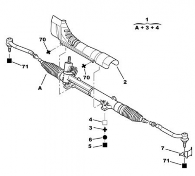

The gaiter kits are still available for your C5 (Part 4066 4). Shown as Part 2 below:
I'm wondering if the previous owner has a steering rack leak and has bodged a fix to simply return the leaking fluid back to the tank, or spliced it into another return pipe somewhere????

Strange as I have a 2005 c5 with exactly the same setup. Same boot. Same pipe.
Previous owner of my car never had any work done other than at the dealerships and never complained about a leaky steering. Only the noisy inner tierod end.
I will go ahead and remove the pipe and the boot. After a close look I could see that the nipple is casted to the pipe. So I doubt it was a leaky steering which was bypassed. Guess we will find out if it was bodged....
- x 2941
I wonder if that's special for the Africa market, I've seen similar set ups on Nissan and Honda cars here and on some Yanks but not on a Citroen.

As far as I know all citroens in South Africa was imported from the UK. Well. When I got it all out I will take some pictures and send it.
I was surprised to see it myself!

This is interesting... but would still be expected to be on the official parts database for the VIN - regardless of county, just as parts are also listed that are specific for other countries. I don't ever recall seeing this on my MK I or MK II C5s and certainly not on the X7 for which I'm on my third rack as are many others!cornesoutafrica wrote: 16 Feb 2019, 12:15 Strange as I have a 2005 c5 with exactly the same setup. Same boot. Same pipe.
