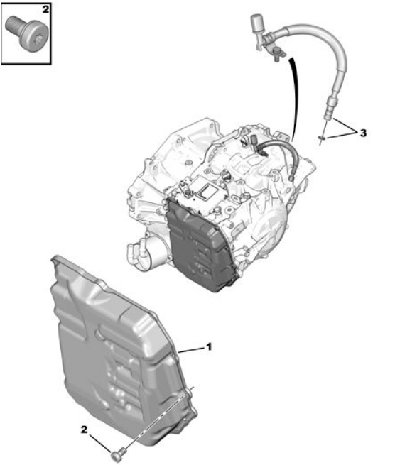

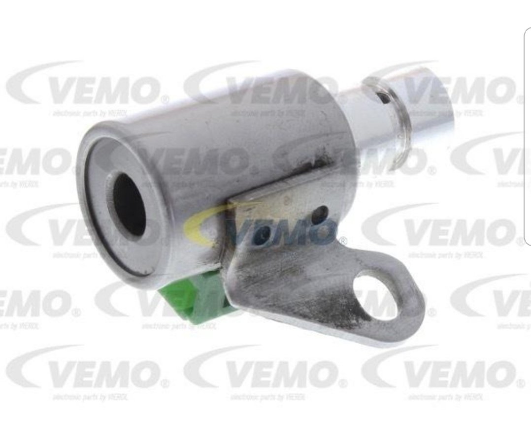

Dears,
Some news appeared, I hope.
I/we have maybe found some clue regarding the noise.
This valve can be the failing one (please see atachment)
Do you think if I am going to change it effects the gearbox oil? I mean should I change it, or will I lose some of if I remove this piece?
Regards

- Posts: 10907
- Joined: 09 Nov 2005, 22:03
- x 1438
Re: C5 2010 1,6 THP aut. deceleration noise
I am not familiar with that part. What is it called and where is it located?
I think he means this - called a 'snifting valve' Mike. Item 3.
The part on autofocus looks like a solenoid internal to the gearbox. The part that Marc shows above looks like a breather pipe external to the gearbox.
I don't really see how either can cause the noise as described.
I would suggest that you drive the car with your mechanic in the passenger seat and demonstrate the noise to him. Otherwise you might replace more parts needlessly.
