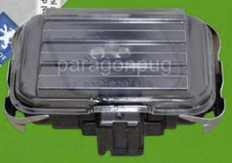

He said the slight problem I have could be linked to the face of the SENSOR Not being flat on the screen..But,,, says super glue etc would be no good,as it also would throw shadows onto the Sensor.. The origanol on the car is some form of CLEAR PLASTIC, Must be sticky both sides though.
does anyone know of such an animal that you can buy.????.

The sensors are contained in a silicon type gel. Once it has been contaminated by removal, they often have an opaque look like a milky residue. This is due to microscopic air bubbles that form when it is removed. There are kits you can buy that you can set and pour over the sensor prior to reattaching it. I’ll see if I can dig the link out in the morning

Hi Marc, Thanks for that mate, That is interesting.
Hope the instructions come with it,lol.
As regards to the way it lokks,,yes it looks like ,Bubbles for the want of a better word..
But can see the TOP Has liftedoff the screen a little,so I can only assume creating a small Shadows at certain light angles..
probably not the sensor,just the small shadows as said..
Thank you for the trouble..

If the gel has become opaque or is not flat against the windscreen it will affect the light and or rain detection abilities of the sensor (s) which will of course affect the operation of the auto lights and or wipers.

Here's a brand new one for £35:
https://www.ebay.co.uk/itm/323582928915?rmvSB=true
The second image looks cloudy - but that is just the protective plastic tray that protects the sensor pad until ready for applying to the windscreen. It's essential to clean the windscreen sensor area with some isopropyl alcohol or similar before removing the tape and applying. You musn't touch the gel pad with your fingers or you will have the same problems, so get some latex gloves and plan it carefully before mounting.
As some of the syringe based filling kits are about the same price, I haven't bothered linking to them as the whole new sensor here is a similar price. Others supply the pads - but getting this the right size is a fiddle.

Re: Xsara Picasso rain sensor
Locked and Loaded Marc,
Just waiting for confirmation from Seller it is the right one,,,{his suggestion}.
if so,,Have decided to get one,as I do think this is the problem,,,,Not a big deal,,but annoys me...lol..
Will mark with black pen on OUTER SCREEN,So I know it has gone back in the same place,including the plastic shround cover..

It will be the right part if he has got his part numbers correct. A good price for a new one.
