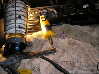

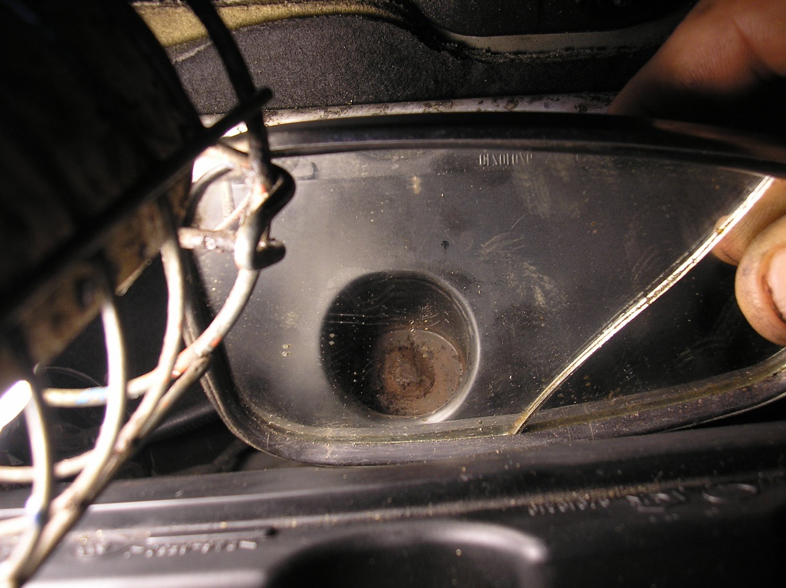

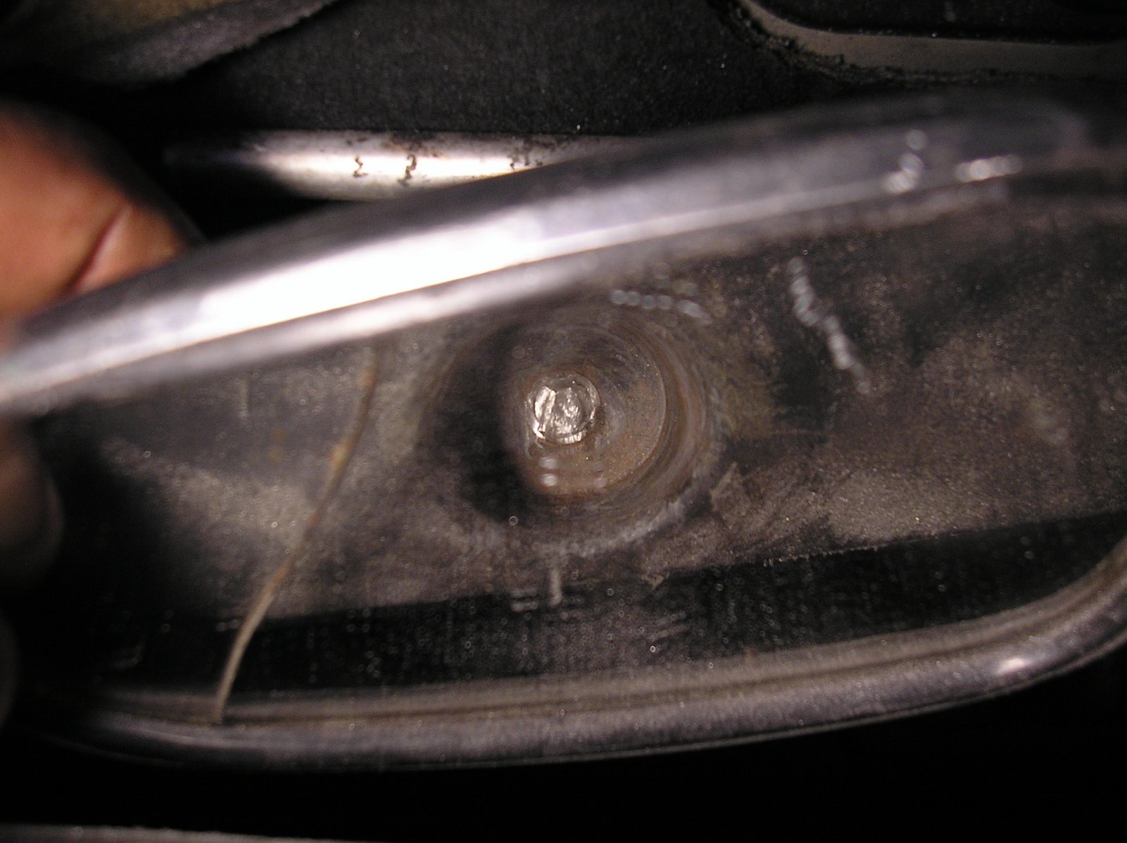

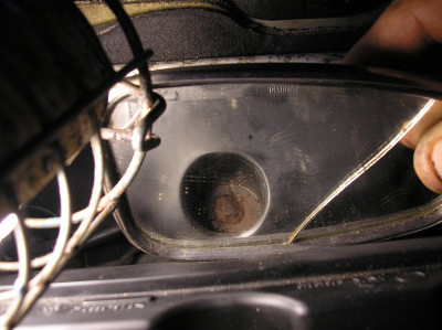

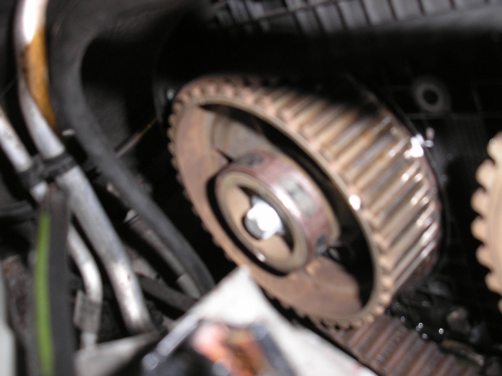

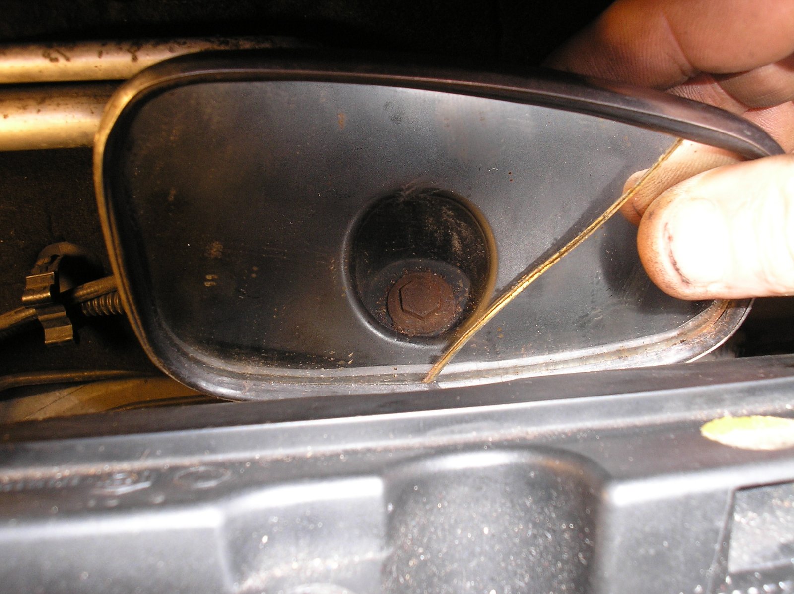

Thanks gmab, cam covers now off, see pictures.
Saturday afternoon from about mid day to about 5pm and the bad bolt is nearly out and seen to "turn". I finished off on sunday morning and removed the cam covers, boy where they "stuck" on!!! The cam boxes are quite dirty inside, and the exhaust cover oil seperator seems to be full of crap and is much heavier than the inlet cam cover.
The woolies special "dremel copy" was tooooo long so I used the small short 12v "drill" one which worked fine and now after its second use in over 26 years of ownership, has paid for its self!

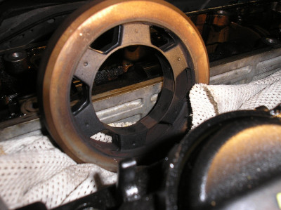

The exhaust cam belt sprocket has a problem, but since some investigation, it seems the cam timing is all ok, unless the exhaust cam shaft has broken, or the cam shaft sprockets have sheared their "keys" and or the crank sprocket hub has done a similar. The likeleyhood of the cam belt going out of time and ending back up in time is more or less impossible. The heavy outer disc is allowed to move via the rubber spider within the cam sprocket recess. I wonder if the rubber spider/heavy outer disc unit is available as a seperate part??
The exhaust cam belt sprocket has a "vibration damper" built in. The heavy outer disc is bonded to the rubber " spider" which in turn is bonded to a thin walled "tube" which seems to be pressed onto a spigot of the exhaust sprocket. The exhaust sprocket its self is solid just like the inlet cam, so I cannot see the system being out of timing as all the timing pins align with their holes, and remains in tension.
for some reason the correct pictures are not on the camera card, will re take and post, but the vibration damper is not now bonded to the thin walled tube that is pressed onto the exhaust cam sprocket, but as said the exhaust cam sprocket is otherwise solid similar to the inlet cam sprocket, so no mangled valves we hope.

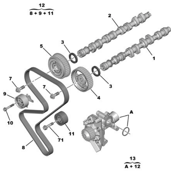

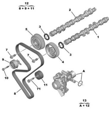

Re: it rains a lot here

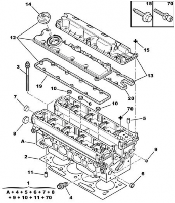

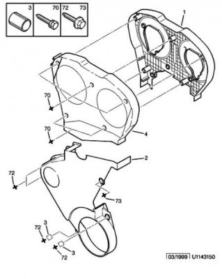

I'm still not 100% sure what you want - probably terminology, but if these are the parts diagrams, let me know which item numbers on either Diagram A, B or C and I'll be able to supply the part numbers for you.
Click / Tap Diagrams to Zoom
| Diag A | Diag B | Diag C |
TheOtherPablo
- Posts: 8
- Joined: 20 Oct 2018, 17:22
- x 1
Thanks for the help.
If possible could you please get:
Cam shafts exploded view - Exhaust Cam shaft sprocket Part number 5
- x 6957

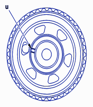

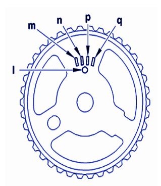

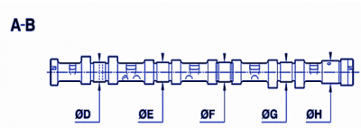

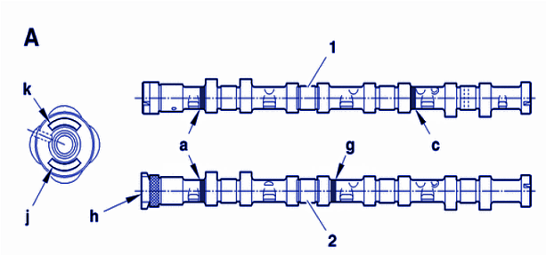

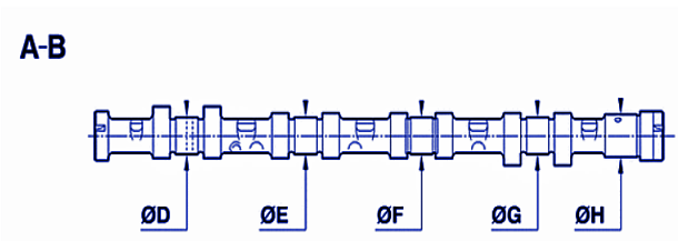

Ok, so item 5 in the middle diagram of the table above in my last post (Diagram 'B') is the Engine Camshaft Gear and is part number: 0805J9 and is £103.22 new from Citroen inc. VAT.
Here's some data on the camshafts:

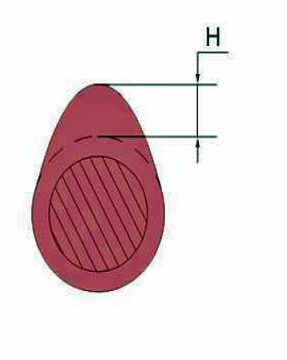

| Identifying Camshafts The camshafts are identified by the following references:
(2) Exhaust camshaft. " a" Paint rings: Repair reference. " h" Target of the camshaft position sensor.
Data
Cam Height H = Cam lift.
Identification of the Camshaft Pulleys

please see the pictures of the exhaust damper, where the bonding between the rubber star and thin walled tube is no longer.
This is a one piece new part as per parts diagram, but will not stop the engine from running for test.
