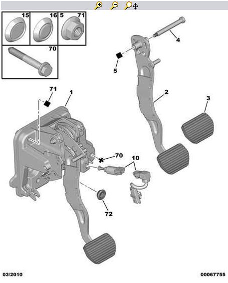

Where is this switch?

Re: C5 X7 automatic gearbox oil change
I had something similar in mind, but sticky beat me to it ...
.. jokes aside, I think it should be No. 10 in the provided picture:
Jodyone
- Posts: 128
- Joined: 07 Jan 2012, 17:04
- x 3
That's it, I replaced it on my C6 to cure a similar issue. Of course, on a right hand drive car, this is in the passenger footwell, and the pedals aren't in the way..!

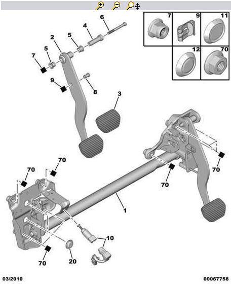

My bad, I provided the LHD picture (my default) ...
The right side driving setup looks like this:
