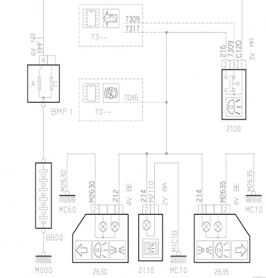

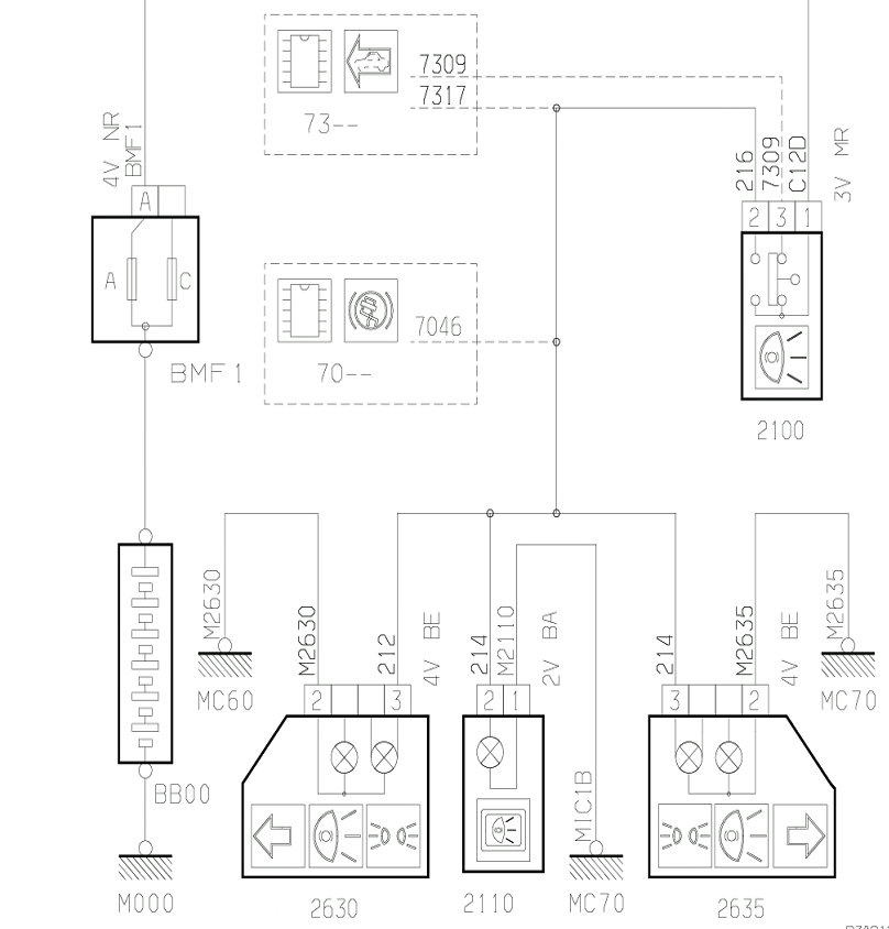

I don't have your VIN, but on a S2, they are on the same circuit. 2110 is your high level brake light. 212 & 214 are the stop lamp wires that feed back to the brake switch control (2100)
Each rear light cluster has a separate earth (M2630 & M2635) and the high level brake light also has a separate earth (M2110)

Many thanks for the diagram Marc but it's all chinese music to me I've had too many problems with this car I think it's trying to tell me something, it's becoming non viable financially garages are too expensive.

Ok but it should help you understand the wiring. The power and connections and earth are fine to the third brake light (as you've said that is working), and given that the left and right brake lights have separate earth points, it is unlikely they will both be out. So I would check the positive wiring, especially the connector blocks to the lamp units and I certainly would double check the brake bulbs with a new one as when one fails the other generally also goes shortly after. It is not always easy to visually see broken filaments .

I only put the diagram up that shows the Braking circuit - each set of lights has a different circuit, so will get confusing.
2630 is the rear LH lamp unit on the body
2635 is the rear RH tail lamp on the body
So the 4 pin blue connectors are the brake lamps and these should only have 2 wires in use in the connector - The earth (yellow and green on both connectors) and the live (shown on the diagram as Grey on 2630, and white on 2635) So you want to be testing if there is current to the live wires when the brake switch is pressed. I would ignore the other connectors for now as that is just confusing things.
Having said this, the live wires for the brake lights are on 2 wires (212 & 214), but these do join the high level brake light (2110) wire as can be seen, and then the main wiring connection to the brake light switch.
So I would be looking to where the high level brake light joins the body brake lights and test the connections in that area to see if there is a junction box or join that is causing the issue that feeds the 2 left and right brake lights.
