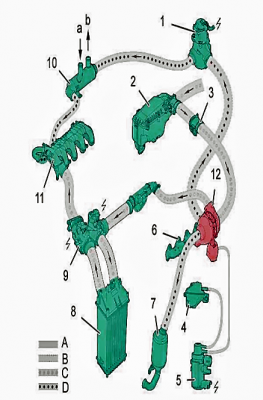

Here's the fuel system components: (Click Image to zoom and clarify)
Air flow meter (1310)
Role
The air flow meter consists of the following components:
" c" Metallic plate (hot film)
"d" Air temperature sensor
The metallic plate is very thin and allows the amount of air entering the air circuit to be calculated.
The metallic plate consists of the following components:
The air passing through the flow meter cools the metallic plate: The measurement resistor (NTC) varies.
The ECU relates the measurement resistor value to the air flow.
N.B. : The air flow meter output signal representing the volume flow of air inducted is of the "differential" type.
For a zero flow of inducted air, the frequency is 5000 Hz.
For a maximum flow of inducted air (full load), the frequency is 1000 Hz.
N.B. : Frequency reduces as the volume flow of inducted air increases.
Do not touch the metallic plate:- the use of an air nozzle is forbidden.
| Reference | Designation | Part number in the electrical diagrams |
| a | Coolant inlet | - |
| b | Coolant outlet | - |
| (1) | Exhaust gas recycling (EGR) regulation electrovalve | 1297 |
| (2) | Air cleaner | - |
| (3) | Air flow meter - Air temperature sensor | 1310 |
| (4) | Vacuum reservoir | - |
| (5) | Turbocharging pressure regulation solenoid valve | 1233 |
| (6) | Exhaust gas manifold | - |
| (7) | catalytic converter - Particle filter (FAP) | - |
| (8) | air/air heat exchanger | - |
| (9) | Butterfly double air metering device | 1361 and 1362 |
| (10) | Exhaust gas recycling (EGR) heat exchanger | - |
| (11) | Air inlet manifold | - |
| (12) | turbocharger | - |
Role
- Measurements made by the air flow meter ( 1310):
- Volume flow of fresh air inducted by the engine
- Temperature of the air inducted
- The air flow meter measures the flow of fresh air taken in by the engine.
- The role of the injection ECU in terms of the information received :
- To calculate the exhaust gas recycling rate
- To limit smoke production during the transitional phases (acceleration, deceleration) by correcting the fuel flow
