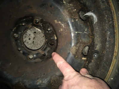

Sorry rothgear I just gave wrong information. Although the car is in a lockup the standard wheels are here. It had 185/65X15 as standard. The offset of the wheels are ET18 this is stamped on the wheel You won’t be able to see the writing on my wheel but it is where my finger is. Pull off a wheel trim and see if you have that on your wheels. It’s near enough in line with the tyre valve. If you haven’t got that on your wheels I will show you another way to calculate tha offset. If your number is say 25 then your wheels are too far in by 7mm and probably will scrape and will need spacers. You could have wheels off a different car, which even though the bolt pattern and centre hole are correct the offset could be different. I’m fussy with all this stuff and studied it in great detail! Ask Chris

Well interestingly the picture of your wheel matches the design of the 15" ones I have. They have 10 circular holes around the perimeter.

Can't see any markings on them. There is a bolt hole directly in line with the tyre valve.

Yes, i have a bolt hole directly in line with the valve too. If the valve is at 12 oclock the et is stamped in at about 3 to 4 minutes past. I have 4 wheels here and can only make it out one one of the wheels. Tomorrow I shall put a straight edge across the wheel and measure the distance to the surface of the bolt holes. This will give a near enough comparasion of the offset. I have a wheel without a tyre on it so it will ne easy, it will be a bit more difficult with a tyre on, but I will work something out so you can get a comparison.

OK. Well I've managed to check all rims today out of a couple of sets I have and they are marked ET15?

Rhothgar wrote: 30 Jan 2019, 19:03 OK. Well I've managed to check all rims today out of a couple of sets I have and they are marked ET15?
Mine may well say ET15, its very difficult to see. I would think your wheels are the exact same as mine then, and are the standard wheels for the s2 1.9 td
