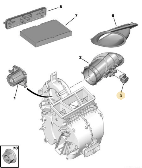

Ok, so you have the manual (single Air Conditioning) system. The air distribution flaps are mechanically controlled with cables. In your case, if I understand you correctly, the air intake flap is shut closed.
The Reduction Motor is item 3 on the diagram:
So the common problem with this is that it will be one of 3 problems most likely:
1) The gear or the spindle on the Flap Reduction Motor can snap off, so the motor will operate but will not open and close the flap.
2) The problem can be electrical - in that the pins inside the plug to the Reduction motor are corroded and not providing power.
3) The Flap Reduction motor itself is faulty.
In order to check this, you will have to remove the passenger glovebox to gain access to the motor. If you remove the motor, you will be able to see if the spindle or gears are broken or not. You should also be able to test the motor using a 12V external battery - connect it up and see if the motor turns, reverse the polarity to see if it reverses. If it does then you can go on and check the plug pins and clean them up or get another plug. But you will have to make sure that the gear teeth align properly when reassembling it.
If the motor doesn't work with an external battery, or the gears / spindle are broken, then a replacement is your best bet. Although there are some glue kits to repair these, I would just get another one to be honest.
