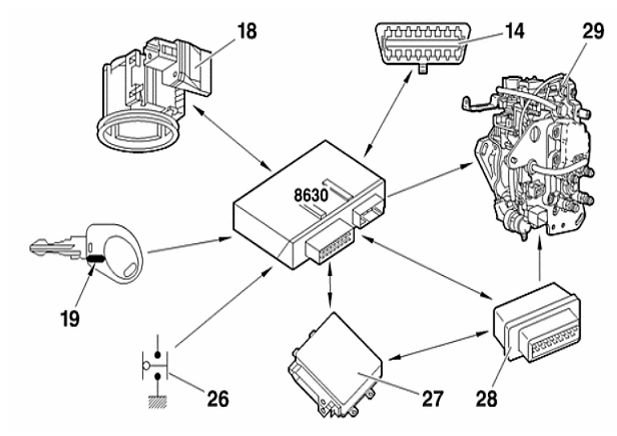

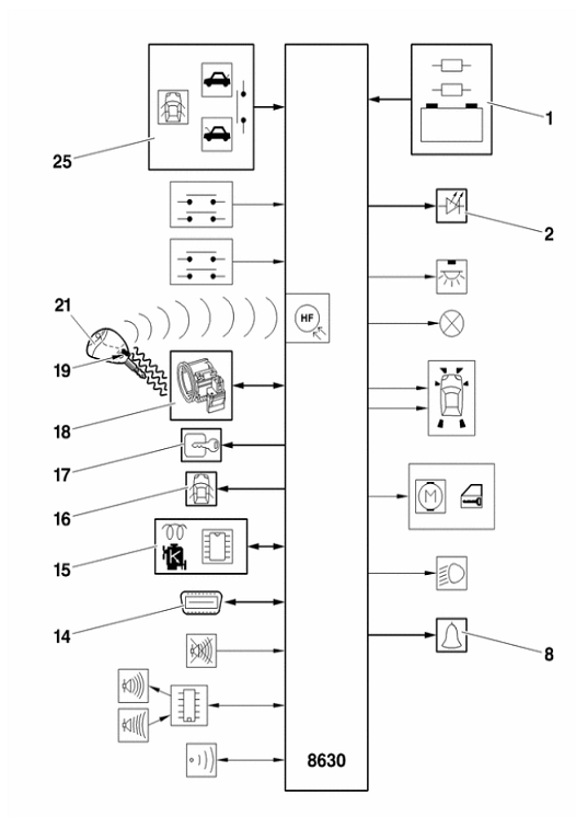

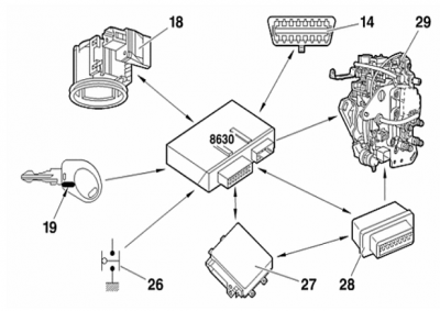

Yes, you'll need Lexia for the year which is encapsulated within Diagbox, but it will need a laptop to run as well as the VCI.
So this is the XU10J2 petrol engine with Magneti Marelli Injection system on a Feb 2000 year model.
Here are the components of the Immobiliser System (click the images to zoom and clarify).

It looks to me that the fault is pointing at the TEXTON immobiliser unit behind the dash, can this unit be repaired, replaced, reprogrammed, bypassed etc, is this possible yourself or a main dealer job only? cheers

If Marc is kind enough to post the schematic of the immobiliser, you could check the voltages around the CPH. I have a feeling that you may have a corroded connector or wire in the harness which is dropping the voltage somewhere.
- x 6955
Re: Citroen Synergie Immobiliser fault Jan 2019
There's nothing on the Synergie Mike that I have unfortunately and even the Peugeot 806 equivalent only has a poorly photocopied diagram that doesn't really show much.
