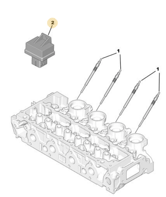

I finally got the car scanned yesterday re the airbag light turns out It's a damaged wire under the drivers seat. I mentioned to him that the glow plug light never comes on and the car is a little hard to start when cold. He told me the light only comes on at 2c. Today it's -2c and no light and car is hard to start.
Where do I start? Test light first? Relay?

Is this the 207?, as you have a 307 in your profile? If the 207 I have the VIN, but not for the 307.
Normally you would get a 'Plugs never supplied' error code, relating to the Glow Plug relay - depends on year etc...
Part is 598140.

Maybe a fault on the glow plug warning light system, try just switching on and counting twenty before trying to start, sometimes the plugs are working but the light is not, sometimes the light works but goes off prematurely.

Here's the Glow Plug Relay connections which may help testing:

It's a 207 I am still trying to change it on my profile. Thanks for the info where is the relay located, I will try the 20 second test later, when warm the car starts instantly

Here you go - item 1158 marked in red, click to zoom up.

Thanks for the diagram Marc, Gibbo, I have tried the 20 second wait made no difference. The relay looks a little inaccessible with big hands but It will come out one way or t' other. Does the relay supply power to the dash light?

No, not directly, The relay gets power from the Engine Fuse Box, then has 4 pins supplying power to the plugs, there is an earth, and a diagnostic connection linked to the engine ECU. That's your 8 pins / connections - the Engine ECU most likely supplies the communication to the BSI and from there to the dashboard display using the CAN bus wiring.

I think I may have taken off the wrong relay! The glow plug relay seems to be under the fuse box? Do I have to remove the fuse box to get it out? The relay I have off seems to be for the fuel pump part number is 240107

Can't tell from that, as 240107 is not a PSA part number on the 207.
That's the official location and should have an 8 pin black connector to it.
