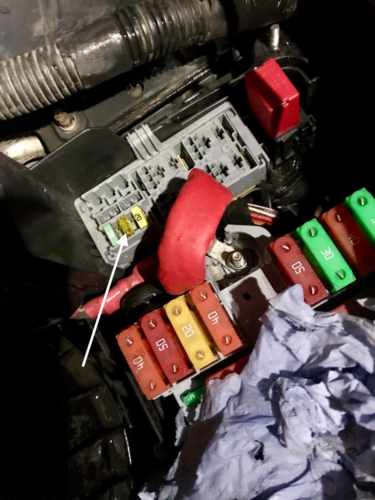

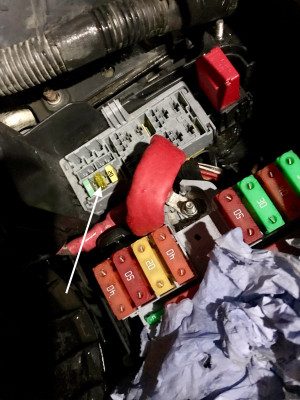

Can someone identify this fuse please? Cant find it in the handbook or on any google search.
Its an additional fuse board in the engine main box.
Thanks.

I'm not having much luck, as there are half a dozen types of fuse boxes on these - given the varying use and adaptability- It doesn't help with all that tissue in the way as it is making it hard to identify the correct one - and it's not like a normal car where is has a simple BSI and a few attached fuse mountings plus the engine bay fuse box - this dispatch III has a stack of options.
If you could move the tissue I may be able to get a bit nearer- as even the fuse Amps are not helping and do not match what I have.

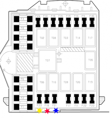

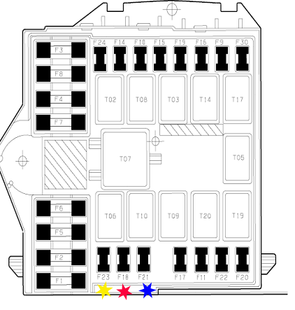

Ok, so after some further neck twisting, I think I may have it:
F23 marked Yellow is 30A Hydraulic brake block electrovalve
F18 Marked Red is 7.5A +Batt Electronic Injection (as are fuses F16 & F17 also)
F21 Marked Blue is 15A Fuel Pump (though I note ther is a 20A fuse in your picture.

Hi thanks for your reply but it’s not that one! It’s labled F56 I the fuse box cover but the actual fuse board itself is separate from the main one which is the one in your diagram. It’s situated just at the top of the main one fuse board but separate from it. (To the left of the diagram above)

In that case on the other half of the board, F56 is a 15A Batt+ 12V rear socket or "prise 12V arriere" if you prefer the French.

Ok thanks. I’ve looked up no 56 and got the same results except that every list states that it is 56 in the door pillar fuse box. This one is in the engine box. 😫
