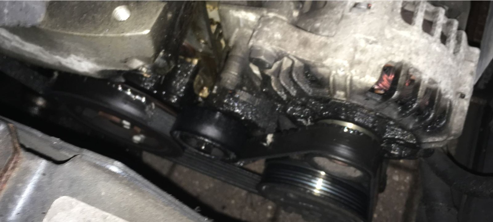

Re: French cars are a mystery to me
Peter.N. wrote: 16 Jan 2019, 10:28 JohnD probably has the answer, you won't get an accurate reading if the car is parked on a slope, forwards, backwards or sideways.
They're also crap warning systems Peter. My 307 presently tells me "oil ok". There's more of it down the side of the engine than in the sump....
