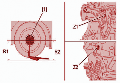

The height settings are measured thus:
Note - for your Specific C2 (TU5JP4S), I have highlighted the correct settings in RED
Measuring:.
  • Correct tyre pressure.
  • Setting the reference height.
  • Steering rack set at its zero point.
  • R1: Front wheel radius under load
  • R2: Rear wheel radius under load
  • H1: Dimension between measuring zone under the front subframe and the ground
  • H2: Dimension between measuring zone under the rear side rail and the ground
  • L1: Distance between the wheel axis and the measuring zone under the front subframe
  • L2: Distance between the wheel axis and the measuring zone under the rear longeron
  • [1] gauge for measuring the radius of 4-screw road wheels : [4300-T].
  • Z1: Measuring zone under the front subframe.
  • Z2: Measuring zone under the rear longeron.
FRONT
Measure the wheel radius (front): R1.
Calculate the dimension H1 = R1 - L1
Front Suspension
EngineTU1JP - TU3JP - DV4TD - ET3J4TU5JP4 - TU5JP4S - DV4TD- DV6TED4
Tyre175/65 R14 - 185/55 R15195/45 R16
Value at setting height (+6 / -8 mm)142,5 mm152,5 mm
REAR
Measure the radius of the rear wheel: R2.
Calculate the dimension H2 = R2 + L2.
Rear Suspension
Value at setting height (+10 / -6 mm)52 mm42 mm

Re: C2 vts ride height??
No problems, just be sure you check the arrow heads facing each other in L1 in the first diagram, as they are not easy to see, but they are there. Clicking the picture will zoom it up a bit.
