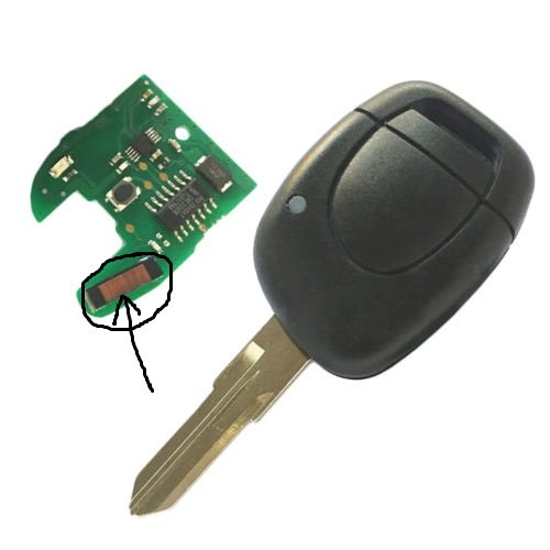

Hey just had an idea if i was to buy a new key from ebay can i just solder the new piece onto the pcb i have now as i think its only the Ariel to sent the signal.
I could be wrong pic attached

The windings on the tube (arrowed) can be bought separately shawn; obviously I can't tell what part you think you damaged, but they are certainly available. All these do is to absorb the energy from the electromagnetic field generated by the transponder coil in the ignition in order to power the chip and send the code.
