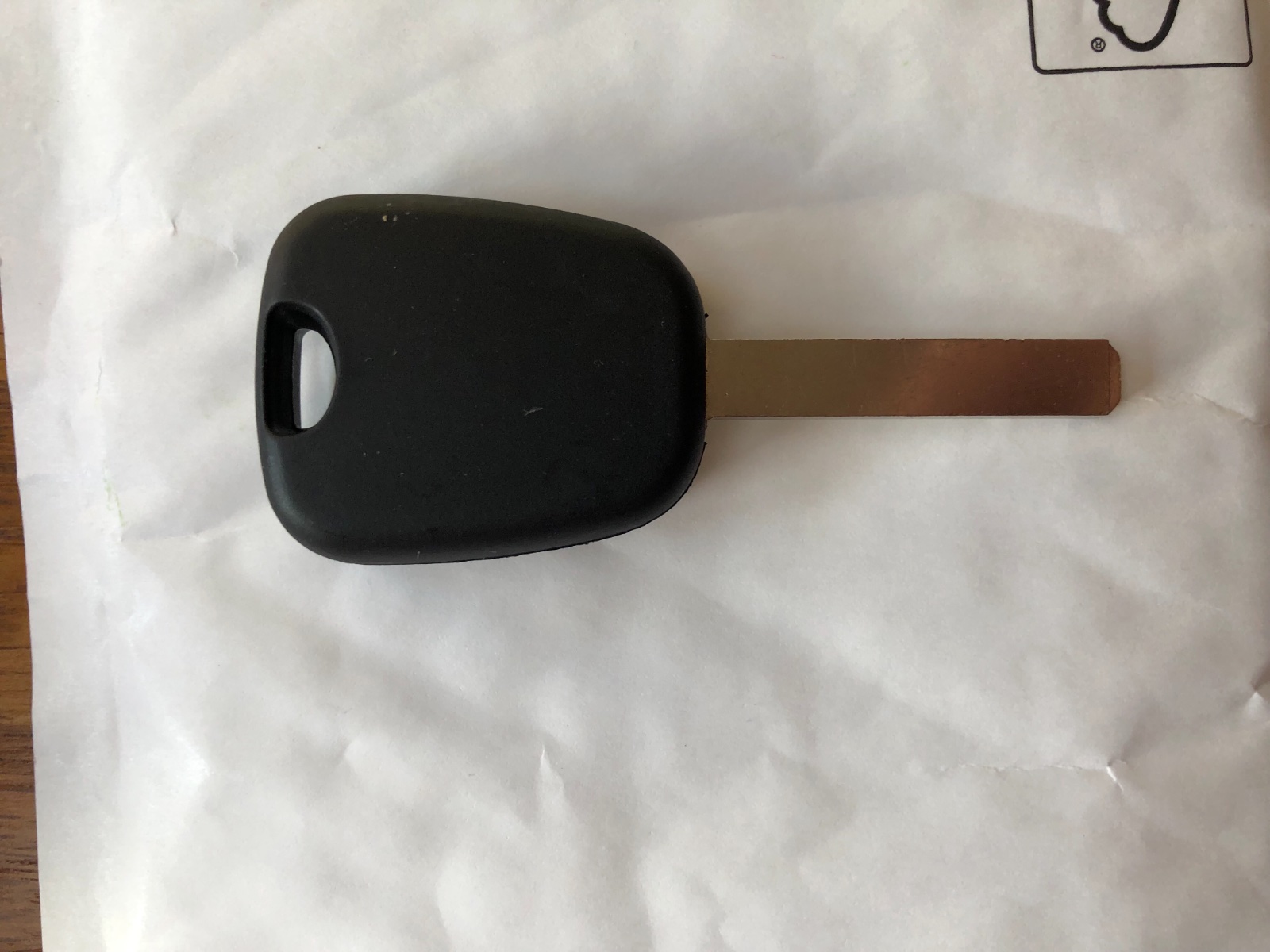

Just need to go out and have this cut, and the. Will try again.

So that will just be for the starting then - no remote locking - but should be suitable to test the coding if it.

Yes, just want to test my aerials etc, if this works i'll (begrudgingly) order an expensive two button key!
Can mine be programmed to have the 3 button key at all?
x 6953
Re: Citroen C2 locking issue
No, that one would't serve any purpose as the middle button functions have to be a feature supported on the car itself - plus it would likely be a different board anyway. Let us know how you get on.
