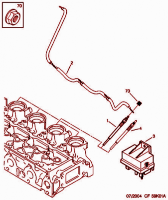

The Glow Plug relay is Peugeot Part Number: 598140, item (3) below in the diagram.
It should be easy to identify, as there are not too many other relays like this - check near the battery / engine fuse box for mounting.
Some are long and thin and others short and fat, but it's always important to get the correct one - so use the part number I gave you to search on and make sure it lists this number.
I'll get you the Peugeot price shortly (they usually update their parts database on a Sunday), so check back in a bit.
