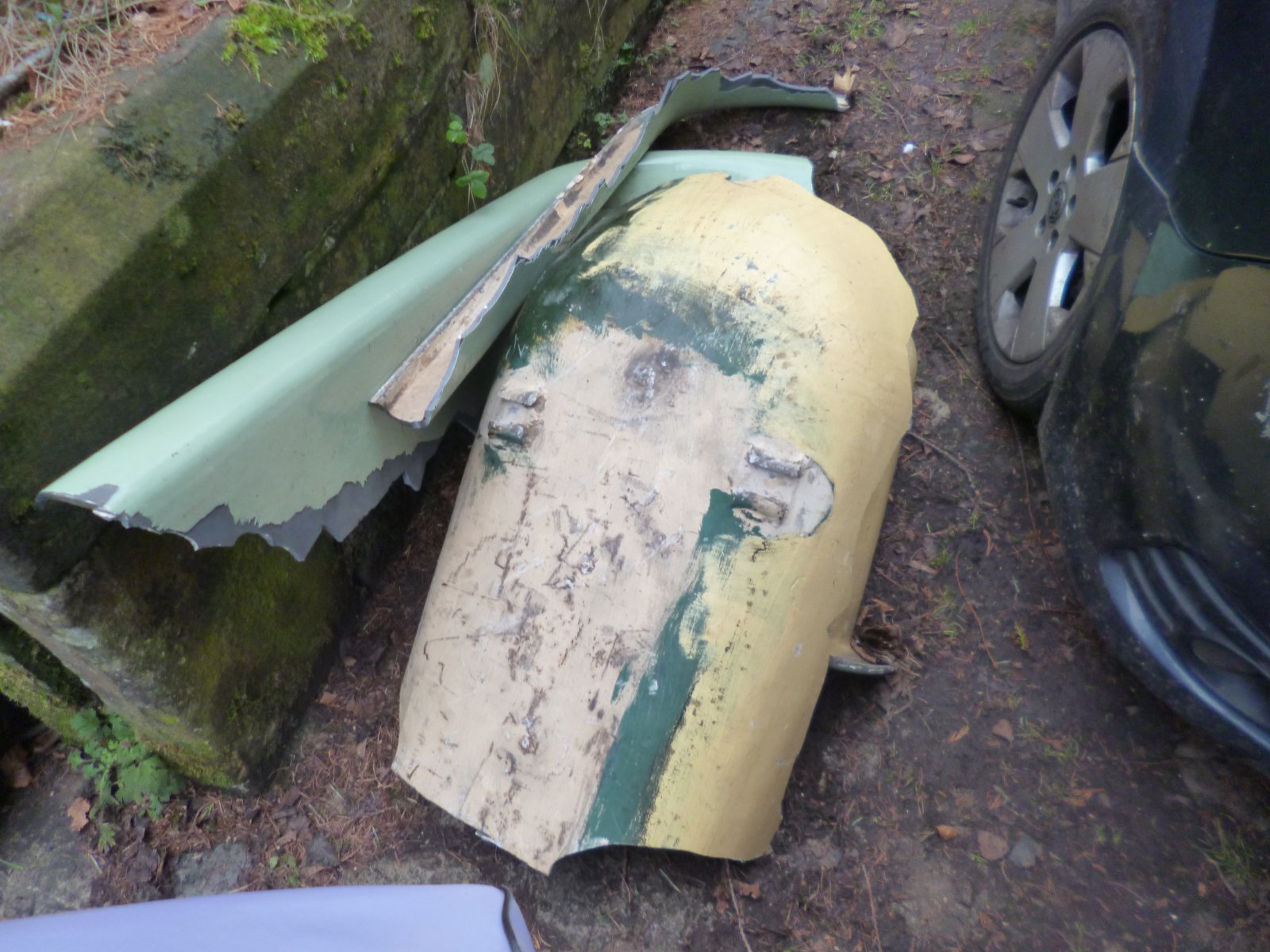

Removing a 100 year old (at least) cast iron bath!

But I came up with another methodYoutube abounds with "How to remove a cast-iron bath" but the methods are only two.
1. Smash it up with a sledge hammer,
Have you heard the sound a cast iron bath makes when it is hit with a sledgehammer? Its deafening...literally. Ear protection a must. Eye protection also a must, and a strenuous workout, and not the greatest when it comes to the shock felt through the tool from the impact on hands wrists and arms.
2. Cut it up with an angle grinder
Others looking to make life easier get the angle grinder out. Shower the place with sparks and fine dust, and cast iron consumes the grinding discs atomising them along with the iron grindings in what must be a highly toxic mix to breathe in even if you have a couple of new paper face masks to call on!
Regards Neil3 "The Lever and Hungry Hippo"
Scaffold pole and the meaty adjustable wrench, which is a work of art in its patina itself (I literally found it when digging the garden many years ago). Bit of "O-Level" Physics on simple machines, well-remembered and used many times in real life. The lever. The wrench just nibbles away like a "hungry hippo" with the minimum of effort, dust, noise.

I think if you could get it down to London that may be true Gibbo, but Paul hits it right in his comments. I think if I had managed to get 4 others willing to slip a few discs in the cause, I may have got it out the door, but they are such an awkward beast to transport anywhere to sell. I mentioneed it to a local auctioneer who reckoned the green colour enamel was a plus point, but £70 at the most was what he expected at that time round here. Its more than served its purpose now

Dont actually have a sledgehammer. First couple of bangs with a lump hammer left a ringing in the ears, and confirmed a sledgehammer would be needed and I wasnt going to do it without ear protection. Got creative though. Couple of cuts with the angle grinder to get started, and the nibbling and levering worked fine.

Job done, looks a prety small pile but literally blood sweat although no tears as yet , no point crying over a smashed up bath!
Still a major clean up of the bits, muck and dust to follow, but the job's 99% done. Won't be loading it up in the car and taking it to the tip though, we have Brian round here! Can still lift a washing machine onto his wagon single handed at over 70!
