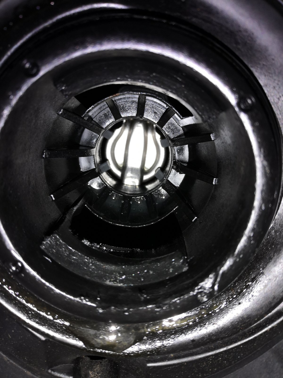

Does anyone know how you open this little flap on the opening to the filler. Looking to put some Redex in the tank but can't for the life of me open it with the end of the bottle!
It's on a DS3 1.6 Blue HDi if that helps?

If you want to add a good diesel fuel additive (Wynn's Diesel Fuel Treatment and Miller's Diesel Power Plus, and one or two other identical ones, actually work), just pour in the recommended amount (usually 1:1000 dosage for routine use) when refuelling, and gently flush in with the pump nozzle. Alternatively, use the pump nozzle to open the widget, and pour in the additive around it.

To answer your specific question about the flap, it needs a nozzle of the correct (diesel pump) size to release it. The flap isn't a complete seal and the handbook says that you can add fuel from a can slowly; indeed I have done this many times. So, just pour it in slowly.

Dont know if PSA cars have this but on Fords with anti misfuel devices there is a special funnel in the tool kit that you can use to bypass the misfuel device. Meant to be there for if you need to fill with a jerry can

So how would that widget stop the HDi from being wrongly filled?
Could it be an anti-splash-back device, for enthusiastic filling?

It can't actually stop you if you're determined to put petrol in your derv car.
It'll stop you pushing the nozzle in all the way and that's supposed to wake you up and realise it's the wrong fuel you've chosen. But, of course, you could then trickle the petrol in if you wanted.

Ford have them on their petrols and diesel models, unless the correct sized nozzle is used it wont open the flap, you would need to be very determined to put the wrong fuel in this system. Hence the reason they have the bypass funnels in the toolkit as you wouldn’t even be able to fill it with a can if you ran out of fuel

Maybe on Ford models but Peugeot and Citroen do not need a special funnel. It would make life easier perhaps but not a necessity.wheeler wrote: 05 Jan 2019, 12:03 Ford have them on their petrols and diesel models, unless the correct sized nozzle is used it wont open the flap, you would need to be very determined to put the wrong fuel in this system. Hence the reason they have the bypass funnels in the toolkit as you wouldn’t even be able to fill it with a can if you ran out of fuel
