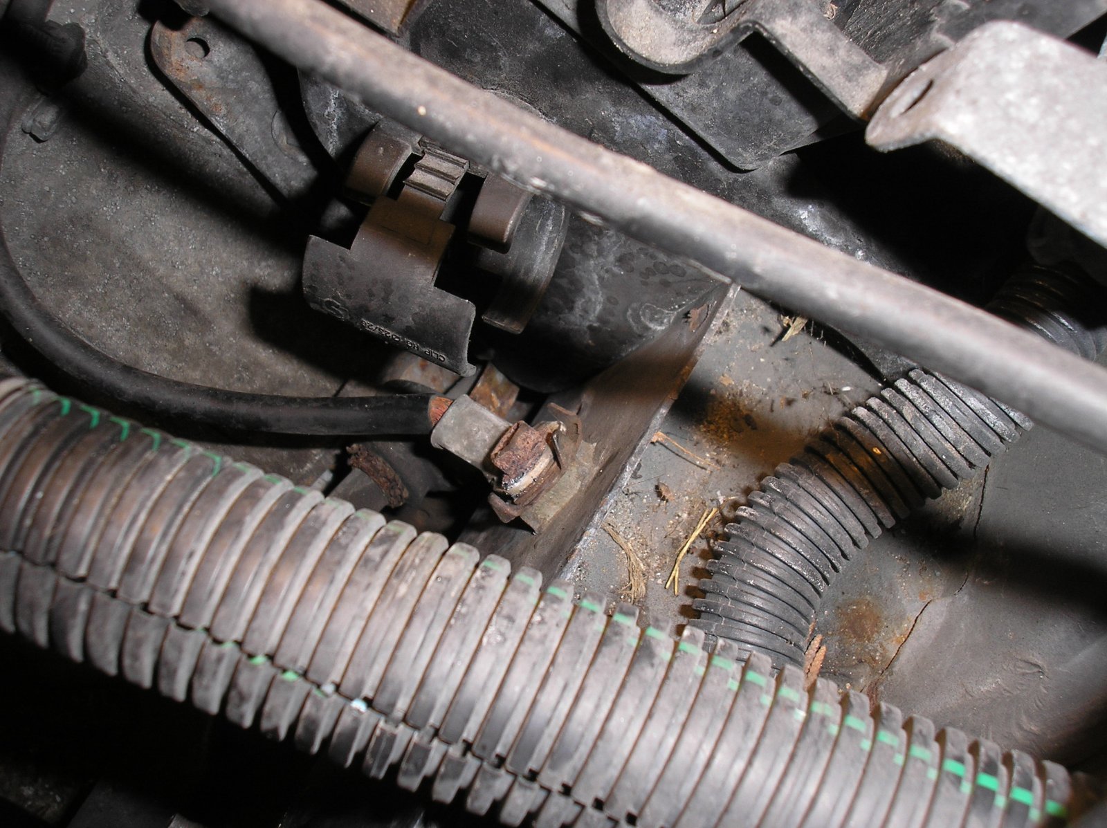

We disconnected the battery and attended to some more earths under the bonnet as well as the previously cleaned battery "bridge" under the bonnet. The bridge "bolts" seem to be brazed to the metal bridge so no voltage drop there me thinks.
We noticed that the main earth from engine to chassis looked bad, as well as the 2 earth points behind the ABS block. We also noticed that the main earth on the engine was not fitted properly.
After removal of stuff in the way, we sorted the heavy ish green earth wire eyelet to a "loose" bolt very close to the main earth lead engine bolt connection. It seemed to want to fit naturally. next we attended to the engine main earth lead connection that was "cocked over" and not connected properly.
Next we attended to the really bad main earth lead to the body by the ecu. This was really bad and not what I would call "tight".
See pictures.
Top, main earth from engine to chassis. This was bad bad bad, bolt not what i would call tight and connections where very very very dirty, they shine now along with some washers, new bolt and spray grease.
Centre, main earth heavy lead to engine, incorrectly fitted in this picture. You can just see the "loose" bolt head to the left. This is now the green earth lead that seems to head off to the ecu direction. It also holds a now "extra" earth lead and seems to fit naturally. The main heavy earth lead is now fitted properly and was not "clean". They all shine now and are tight.

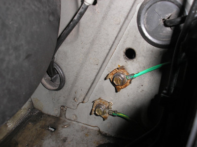

Bottom, the 2 earth points behind the abs block. The eyelets shine now as do the bolts and washers. Difficult to get small drill with wire wheel to the body connection platform, so earthing thru bolt and its eyelet contact. These had been sprayed prior to removal, but all the others where "as is", ie not sprayed.
The 2 earths behind the abs block seemed all ok after removal.
We have added an extra earth lead with the heavy ish green earth lead as a belt and braces, to be connected when I have the car again.

Well investigated - the usual suspect earthing connections - there are so many of them for each of the systems that as you can see, can easily become corroded and cause havoc. That then has a knock on effect to other systems. Cleaning them up and protecting them going forward gives some peace of mind. I'm sure your son appreciates it!

On some PSA cars, those body-work earthing points are square nuts, spot-welded to the bodywork. As such, they should be making good contact. However, the square nut top surface often (always?) gets painted along with the body, and so a bolt-down connection only makes body contact via its threads, and not with the full surface of the eye-connector. Not good.
Permanent cure is to remove the paint (dremel/scrape) from the nut-top, clean up the eye-connector, tighten down and apply a dob of protective grease/wax.

Just been looking closely at your photos of the body earthing points. It's unusual and worrying to see any rust on these, not of the bodypanel itself, or the welded-down square nut, but the 4-spike 'washer' that looks as if it sits between the square nut and the cable's eye-connector. Not sure what that item is there for - unless it was intended to hold a ? plastic cover for the earthing point.
When you come to clean off the paint on the square nuts, it might be a good idea to discard that spiky washer (assuming it's not also firmly attached), so that the eye connector can make decent direct contact with the nut top.
Does anyone else know what those spikes are for?

The spikes will surely be there to pierce the paint and provide an electrical pathway.

I just always thought the ‘spikes’ were there to stop the eyelet terminal rotating all the way round & twisting the wires when tightening the bolt?
It also seperates the eyelets if there are multiple earths on each point.

The spikes seem to point upwards into fresh air.
They could be anti-rotational, if fixed down.
There's no good reason to separate eye-connectors from each other; they naturally fan out radially.
If that spiky washer is made of steel (and they do look rusty) it's not a good thing on such a connection.

white exec wrote: 04 Jan 2019, 17:35 ..................The spikes seem to point upwards into fresh air.................Still puzzled.
Possible answer
When I had difficulties in starting my C4 Ehdi, my local Citroen garage found it needed a earth lead replaced, via recall notice - this was a 2011 car and was only 6 months old!! -picassodad wrote: 03 Jan 2019, 10:18 Marks on the bolts seen when doing yesterdays earth points and missing nuts and incorrect main lead fitting suggests the engine may have had a cam belt failure, or clutch maybe. Who ever did the job did'nt do very well we feel.

Spikes to stop rotation of the eyelets I feel.......

They do indeed point up into fresh air, if they pointed down towards the body they wouldnt stop the eylets rotating when tightened?

Rubbish earthing has a long history with PSA. BX had multiple body earthing points in both engine bay and cabin, and many of these gave trouble, with systems dropping out and misbehaving. Cost-cutting by PSA gave early XM 0.25" push-on grounding connectors, which had to be re-thought (and recalled) early on, and uprated to bolt-down.
Making important ground connections to painted bodywork (and lightly painted threads) is just plain crazy, but easily rectified once-and-for-all. On XM, cleaning up the 10 or so inner-wing earth points in the engine bay, and several more in the footwells, is pretty much essential.

. . . & I thought bad earths were a problem with fibreglass bodies - oh, & '90's Cadillacs (which have so many, there's a schematic to supplement the wiring diagrams, to identify their location.
Back to those "spiky" washers, I'd be inclined to replace them with star washers (per earlier Citroëns) to both stop rotation AND cut through the paint UNLESS, by reference to other Picassos, I could be sure they were correct - & correctly fitted!

The spiky bits arent removable washers, they are fixed to the earth points so they cant be incorrectly fitted.
