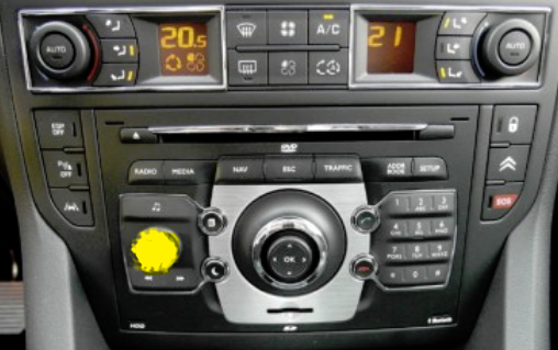

One other thing, try holding the 'on' button shown in yellow in the picture for a minimum of 15 seconds to cause a reboot.

The 'on' button trick also tried it and it didn't work either. I think I read all the forums around the world about the NG4 (blessed google translator

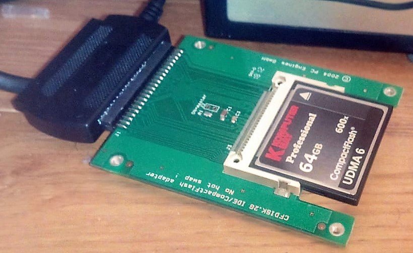

Pic of the CF... same as yours UDMA6 64GB KomputerBay ... all should be fine as it works for you, but no
