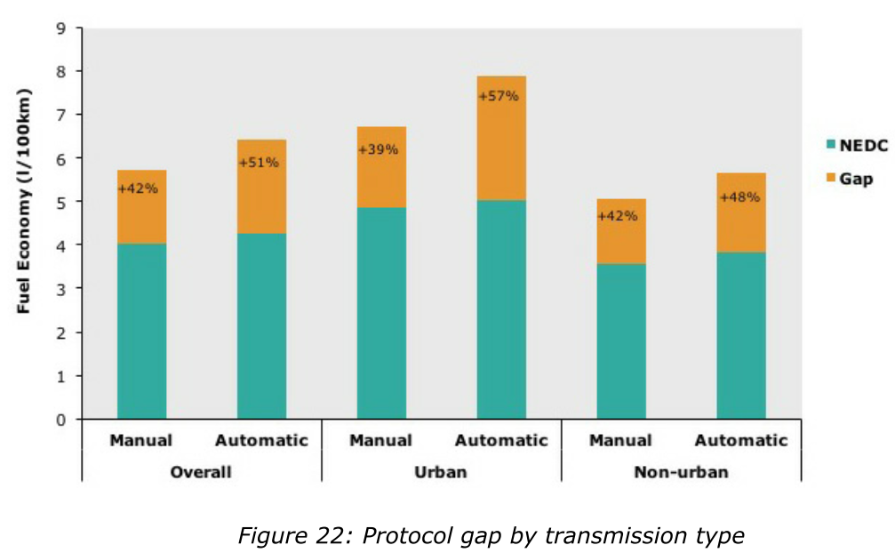

It's the same with the C5 X7 - my friend has the same engine as me, but has the AM6 Auto box and his emissions are way above mine, that it puts his car into the next car tax bracket!
A lot of this has to do with the weight according to PSA:
Transmission Type Effects
Despite significant technical progress, automatic gearboxes continue to have higher fuel consumption than manual ones. the gap between the nedc test and Protocol results is also greater for automatic transmission, particularly in urban driving conditions (Figure 22).
Higher gaps between manual and automatic transmission occur for both gasoline and diesel powertrains and can be as much as 3 l/100km for an automatic diesel car in urban driving (Figure 23). Improving the operation of automatic gearboxes fitted to diesel engines would reduce the performance gap identified in Figure 16 and Figure 17. Higher average vehicle weight might partly explain these differences, with weight being an important driver of fuel economy in urban environments.
NEDC: New European Driving Cycle
