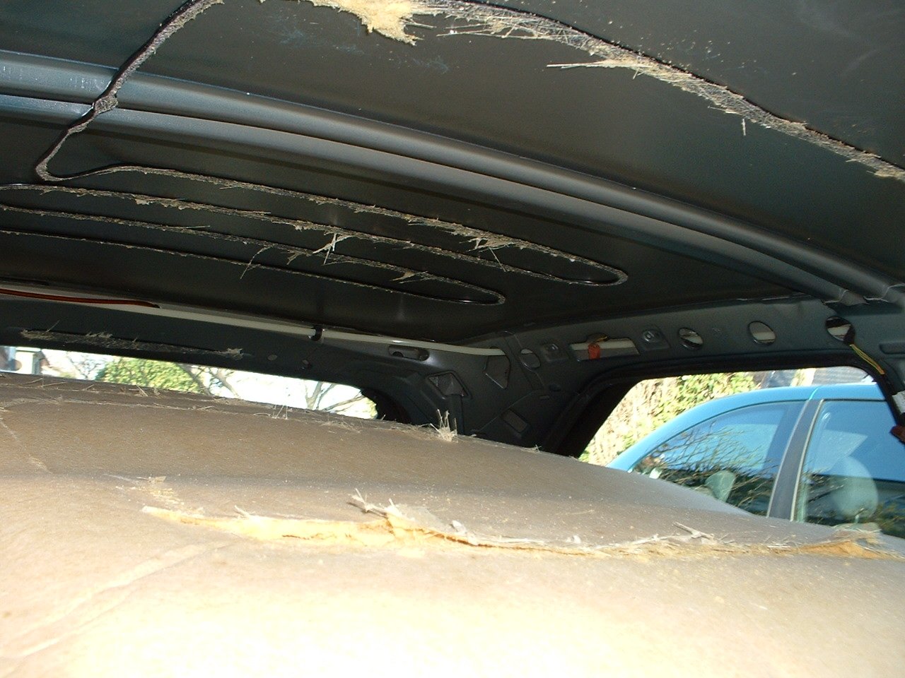

HEADLINING REPAIR (no sunroof fitted)
Not much about this on the forum so thought I'd have a go....
Saggy headlining on my Activa
Upper trim removed
Upper trim removed
Remove the interior light from headlining, remove grab handles from headlining, sun-visors, remove all adjoining trim from interior of A,B,C pillars including the front upper seat belt anchor and the upper parts of the hatch and door seals, you should now be able to ease the edge of the headlining away from the door and tailgate seals, once clear of the seals push them back for now.
Edges released
Edges released

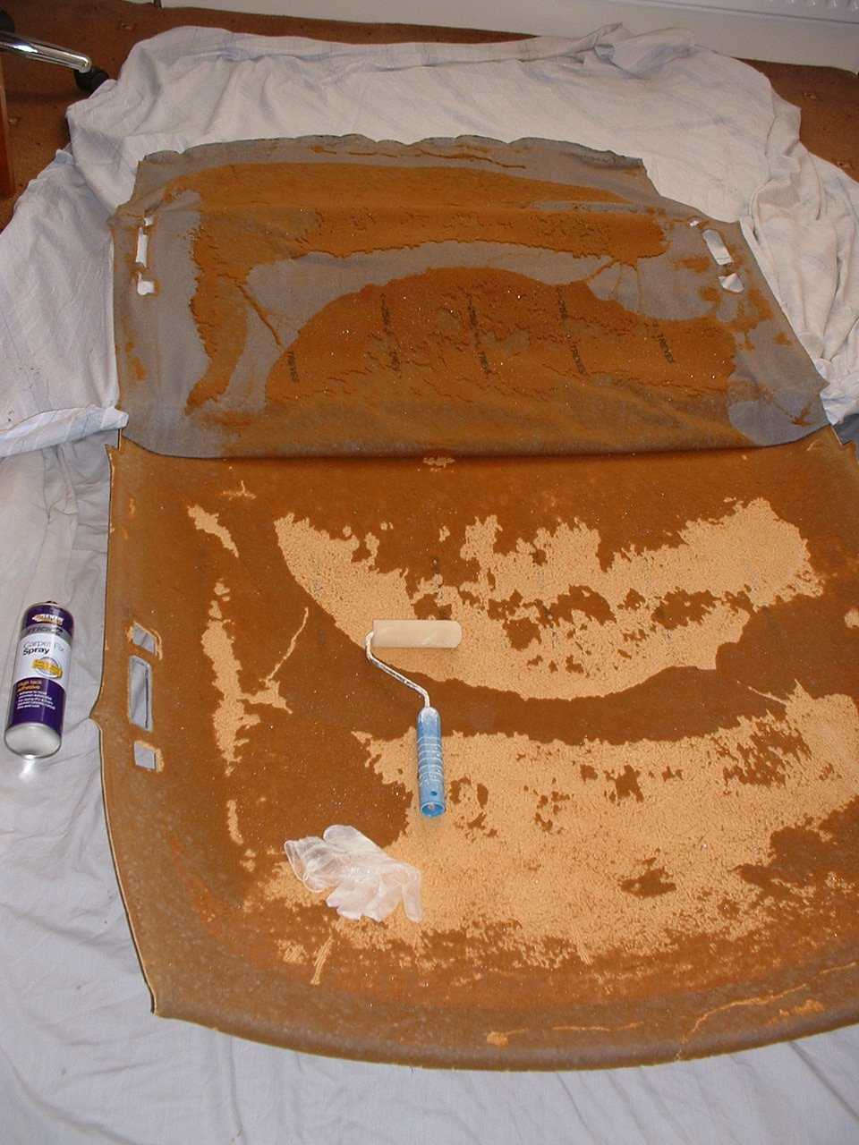

What you do now depends on your problem - in my case the covering fabric has seperated from the fibreglass backing, the backing was still secure to the roof so carefully try to separate the backing from the roof, I managed on a cold February day to insert a rounded scraper (most of the roof is single skin and I don't want it to look any worse) to start separating and then as more room was available my poor little hands, there was quite a bit of semi-solid sealant bead on mine on the main roof and a small individual strip near the rear hatch, I damaged some of the fibreglass that was harder to remove, but eventually once you've separated the two, the lining will drop and allow easy removal through the rear hatch.
released
released
interior
interior
interior side
interior side
I decided to use some carpet adhesive to reattach the lining material - time will tell if it's any good, it's messy stuff and the weather meant it was an indoor job for me, I decided to try half at a time as pictured, as it would allow the patches of foam a better chance of being filled by the foam that was still attached to the lining material, the material isn't in brilliant shape but I'm not prepared to replace it at this stage (time will tell) peeled back a half at a time, removed any loose pieces of foam and sprayed as directed, waited a minute and replaced as best as possible pressing down with a dry foam mini-roller to help avoid creases.
fibreglass roof panel

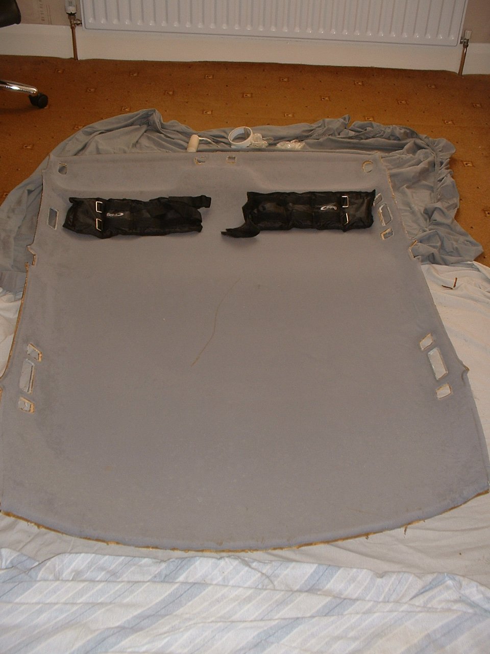

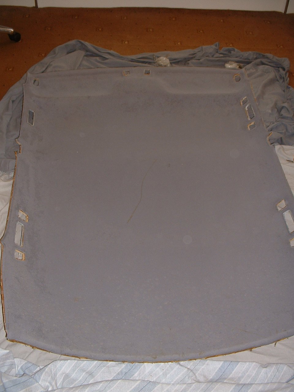

There was some penetration through to the facing surface so I will have to see what it dries like and then remove the 'rust scrape' if possible ....currently drying overnight with leg weights placed to try to help it stick better in the shaped area near the sun visors
drying overnight weighted at contours

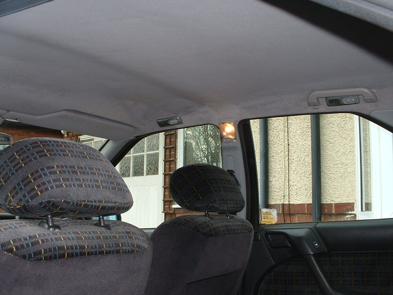

13 Feb 19 fully fitted
Fully re-fitted front
Fully re-fitted rear
I have not used adhesive to support the rear lip - I have managed to insert the headlining into the seam of the rear hatch door seal and I'm pretty sure this will suffice although it has made a small gap in the trim at the top of the c-pillar it's only noticeable with the hatchback open....

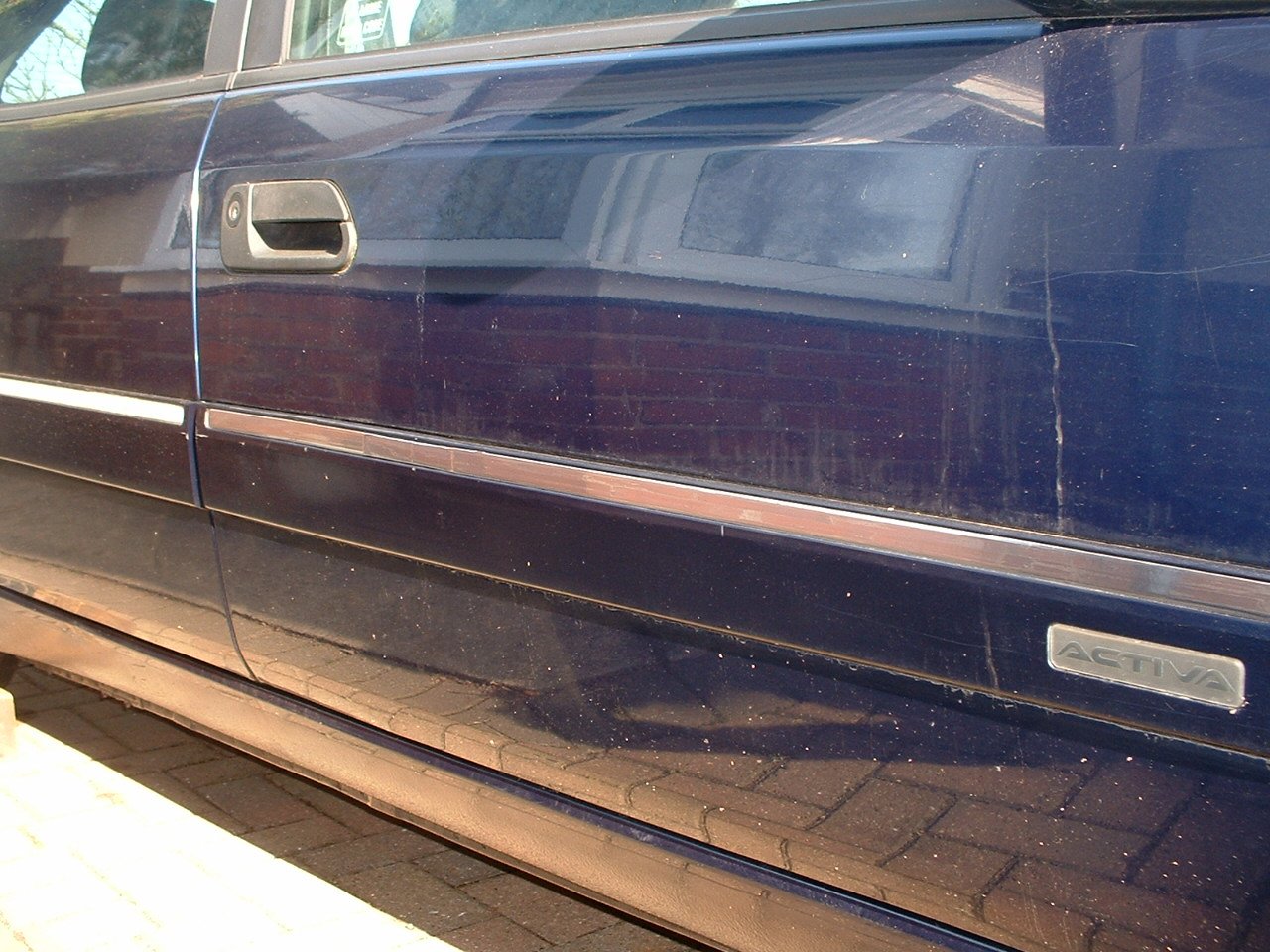

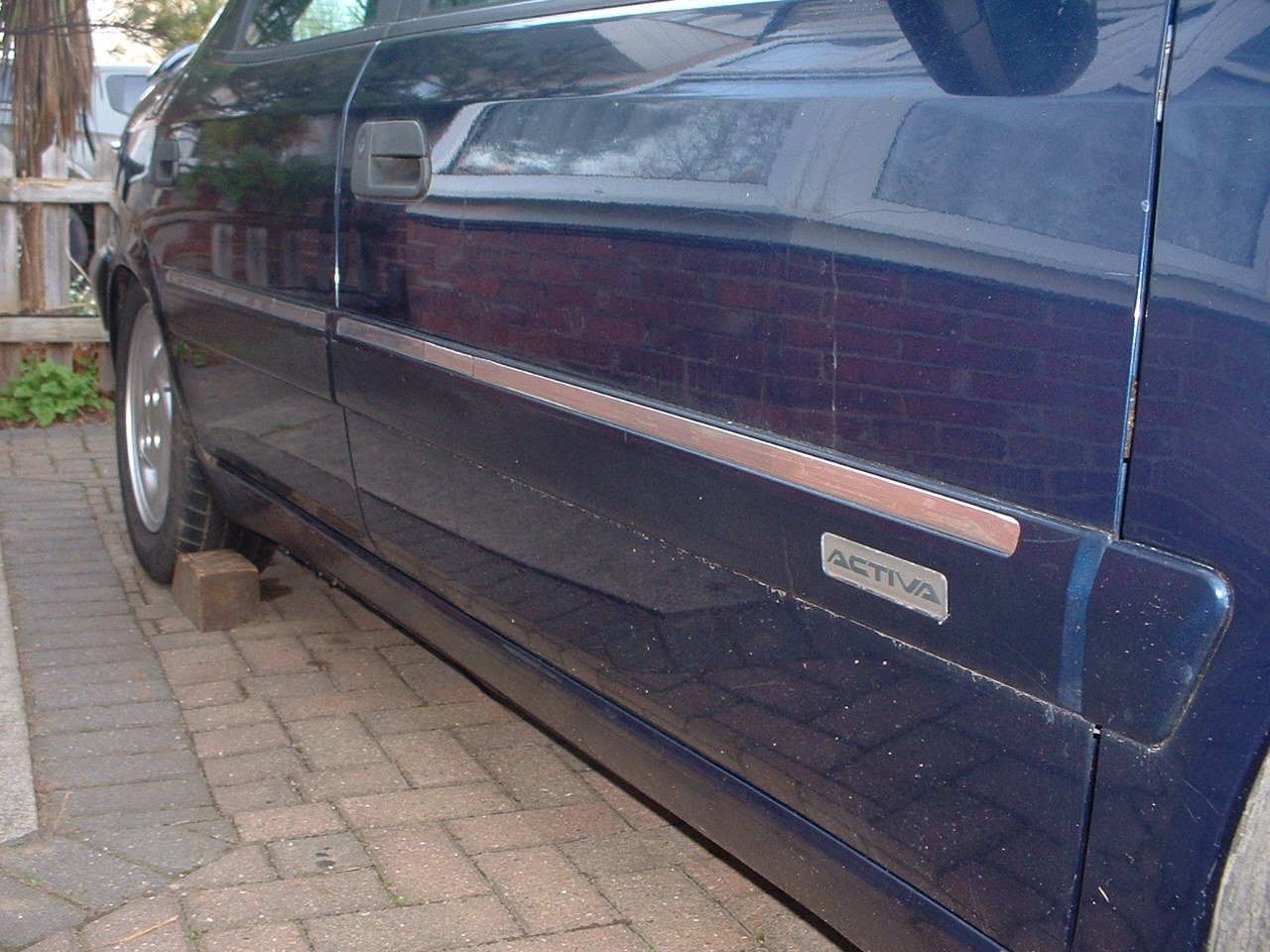

The sun came out today so I've had a go at tidying the door chrome strips - how these actually corrode is beyond me as they are really tough to separate the chrome finish from the black plastic trim
Photos don't really show the 'before' condition but the 'chrome tape' was only £5 and looks ok if you don't look too close :roll:

Rear door scab cut out (pre-sanded)
scab cut out of rear door
filled with tape and trimmed
and then covered with one strip of chrome tape
finished
finished
finished
finished
