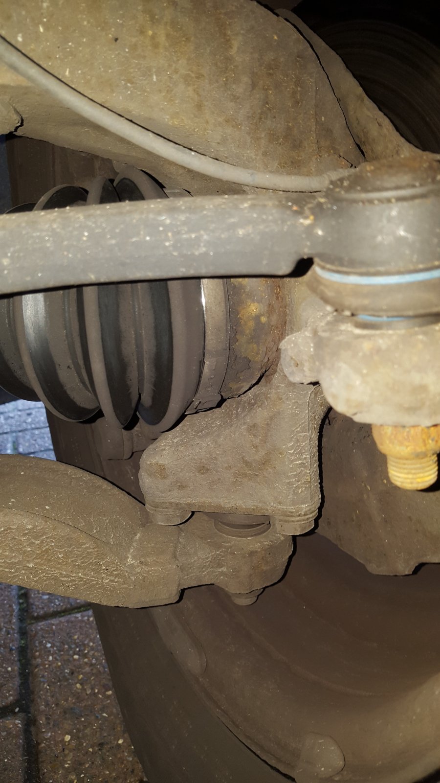

Here's a few pics.
Thanks for the pointers guys

Just looked at those pictures, if they are from your vehicle then i must admit bugger all has been changed IMHO
Do you have a detailed invoice that shows what work was done ?
If not i would go back and ask for one as you like to keep records of all work done as proof of up keep of the vehicle should you wish to sell it at a later date.
If you have/get a detailed invoice that states they have changed the parts i would go back to them and explain to them that you will be taking it to another garage to get the steering aligned as it is wayward since it has had new parts fitted as you no longer trust them to do the job correctly.
I would then inform them that if the work you have been charged for has not been done you will be taking it up with VOSA, the regulatory body that issues licences to garages to be able to conduct MOT tests.

Took the pics today. MOT done about a week ago.

Yep, if the track rod ends have been replaced the adjustment nut on the track arm will still be new and un-rusted, right next to a rusty track arm - not even UK road salt will destroy it and make it look old and rusty in one day! :lol:
However in winter with salted roads it will only take a matter of weeks or maybe a couple of months to render the new track rod "old" and rusty looking. Within a single winter it will be old and rusty looking and blend in with the original parts. So get back there pronto with your concerns before they have a chance to say that it is just fresh corrosion on the new parts.
Also in my opinion if you have left a mobile contact number no garage should be replacing parts without your authorisation when you take a car in for an MOT. Ever! I know the garage I use would not do this. If this had happened to me I would have been livid and demanded immediately to be shown the new and old parts and ask for an explanation of why they thought it was OK to go outside of what I had agreed to bring the car in for. (EG an MOT) And I would not be going back there again.
Edit: Just saw the pics on page two. The threads and nut on the track rod end where it goes through the swivel hub look very rusty - this degree of rust wouldn't happen in a week. Can you take a better close up picture with sharp focus of the thread/nut for the ball joint on both sides of the car ? (like your third picture, but it needs to be a sharp clear picture of the threads and nut below the joint to see the conditions of the thread)
