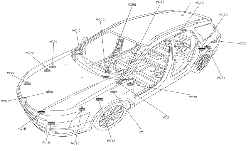

Ok, so I've put 2 diagrams up as there are multiples of these for the individual lighting system components. Hopefully these will be the ones you need. I'll pop up the earthing locations for you too.

DRLs & Earthing Points
DRLs
Earthing Points (DW10CTED4 Metallic Suspension
DRLs

Before i got the diagrams i guessed that the 3 green/yellow wires were earths & checked them under load & seemed ok.

Was just saving the diagrams for future use & having a look at the DRL diagram. I'm curious as to the location of the DRL relay (2404),It could come in handy if I need an engine running feed for anything in the future. Do you have the 3rd page of the diagram that shows component locations?
