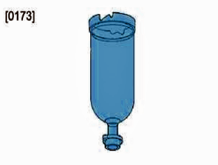

"A" : Fitting with filling cylinder offset; Using the tools [0173], [0173-B], [0173-C].
"B" : Fitting with filling cylinder direct; Using tool [0173-2].

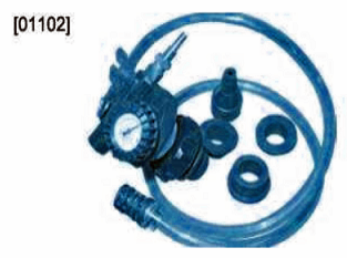

Filling using the tool for filling the cooling system by vacuum
CAUTION: Always use new coolant.
Connect the hose (1) (at "a") ; Using tool [0165-2].
N.B.: Refit new clips.
Prepare a receptacle of coolant containing the quantity of fluid drained + 20 %.
N.B.: The receptacle must be positioned slightly lower than the equipment for filling by vacuum.
Repeat the operation until the cooling system is full (if necessary).
CAUTION: Remove the equipment for filling by vacuum [01102] and rinse the assembly with clean water.
- Fit the filling cylinder, blank and adaptor assembly on the expansion chamber (according to assembly).
- Close the bleed screw.
- Put the equipment for filling by vacuum [01102] in place on the expansion bottle.
- Place the cooling circuit under a vacuum to reach -0,9 bar (diagram "C") :
- Wait 10 seconds and check that the value obtained does not drop
- Fill the cooling circuit completely and wait for the return to 0 bar (diagram "D")

- Remove the filling cylinder , plug and adapter assembly.
- Check the coolant level when cold.
- Top up the coolant to the "max" level (Cold).
- Refit and tighten the cap on the header tank.
