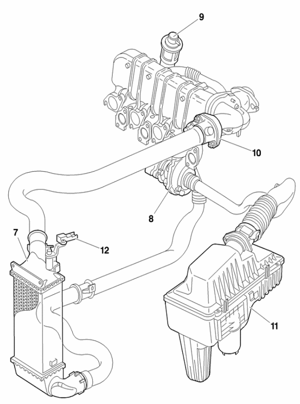

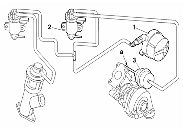

Can anybody tell me is the turbocharger is vacuum operated? If it is, are the pipes specifically shaped (like the intercooler pipes), or can suitable flexible tubing be used? If it can, what IS suitable flexible piping?
The reason I ask is that I do not think (yes, I know, I NEVER think!) the turbocharger IS getting used. Her exhaust is visibly clean (certainly no signs of black smoke), but her power band (when she is not in 'limp' mode) starts close to 3,000RPM. I recall that my previous C5 power band was much lower down (around 1,500RPM).
Thanks for all the help so far (and any forthcoming assistance).

x 6963
Re: My turn for a C5!
Here's your setup James and Turbo Air Supply
ReferenceDesignationmake
(7)Air/Air heat exchangerVALEO
(8)TurbochargerKKK K03
(9)EGR ValvePURFLUX
(10)Air ThrottleMAGNETI MARELLI 48 W7 Reference 648
(11)Air cleanerPSA 7899
(12)Turbocharging Pressure SensorNIPPON DENSO
(1) Vacuum pump
(2) Electrovalve
(3) Pressure Regulation Valve,
