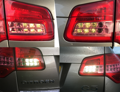

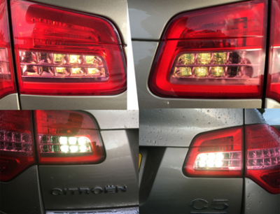

It really is down to the type of LED Pete - they are not all created equal. My DRLs were defo brighter than the halogen ones, but were about £25 for the pair and took some modifications to the pins to fit - but were worth it in the end. I also more recently in the summer did my angular lighting - which on my version with Xenons uses the also dreaded HP19W bulb, whereas the halogen headlamps use a standard 'H' type bulb (can't remember if it's H7 or not). I had to put some load resistors and undertake a modification again with the pins - but the result is fantastic at nioght and round country lanes / at junctions - really illuminates the corners.
As for the reversing ones - choice is very limited because of the fitting, but I have these:
As you can see the before and after pictures, they are at least crisper, however, I have the rear blind up (which helps filter out additional dazzle before the electrochrome mirror does its job), so the visible light is not great - but wasn't before. If you don't have or don't use the rear blind, then you should get a much better result. I will go out in a bit now it is dark and take a snap for you. But these were the result of the ones I fitted

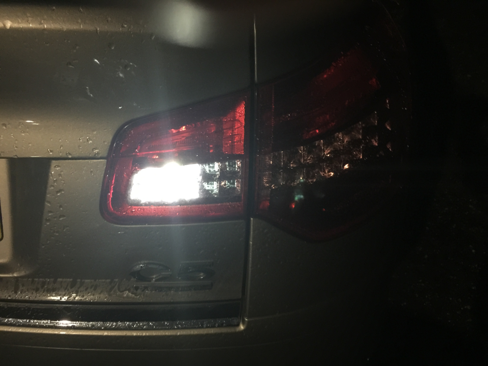

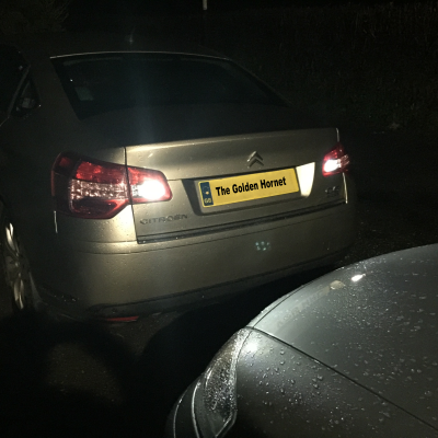

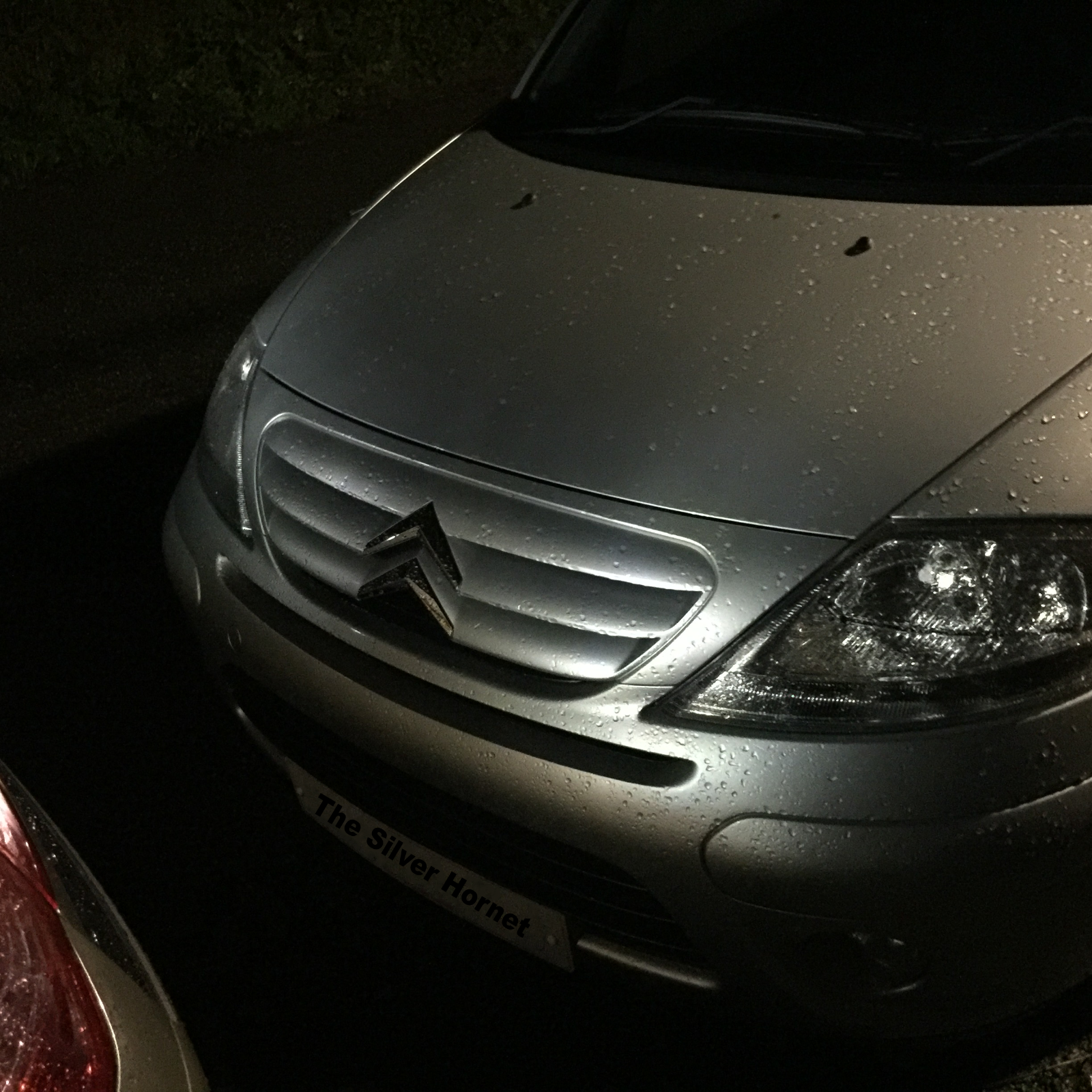

Ok, so in true FCF assistance mode and as I promised Paul that I would get a picture of the reversing lights (I didn't forget - really) and as Pete asked, I trapsed out tonight in the freezing wet and windy weather, barefoot and in loin cloth to get these pics.
Click on the images to get a larger, clearer view
These were the ones:
https://www.ebay.co.uk/itm/2-x-H21W-R43 ... 7675.l2557
| Here's the Golden Hornet showing them from a distance |
| Here's a close up |
| ...and here is a picture of the light shining on the Silver Hornet to give some idea of light. |

Effort much appreciated Marc, they look pretty bright to me!
