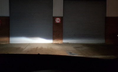

I've attached a pic or 2 at various distances on the car park at work. Maybe it isn't the level after all? Is it me, or does the drivers side look to be pointing way way over to the passengers side??

Take a roll of cooking foil with you, so you can quickly cover up one headlight at a time, to see exactly what each one is doing. A bit of chalk on the wall can help too.

Well it's a little hard to tell Gav, but bear in mind that the right hand dipped beam is aimed away from oncoming vehicles - so maybe the best way to know for sure is to call into a local ATS with an MOT testing station and ask them for a quick beam alignment check - they will be able to confirm if they are kosher or not - and if they are a little out, should be able to adjust the aim for you.

My next thoughts exactly. Deal with a few mot stations so I'll be calling a favour in tomorrow to see what's what.
Level wise they look about right, as in the same level. But now I've noticed the lack of light to the drivers side properly, driving home I may as well be running on sidelight at that side
