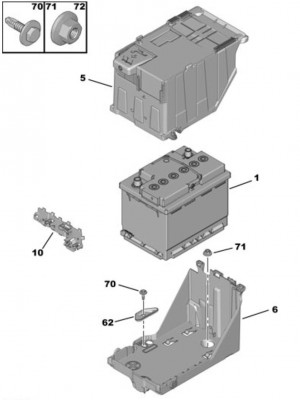

I think you may kick yourself Rick when I tell you this, but the battery in the DS5 is actually encased in a protective shield. There is a single flap that allows one terminal to be seen - probably the positive. This shield can be removed upwards. The other part is sealed I believe, so might give the impression that it’s a weird type of battery or the negative is elsewhere! :-D
Item 5 below,
As for the connection procedure when using a slave battery:
Connect the positive cable to the positive of the flat first
They connect other end of cable tompositive of slave battery,
Then connect the negative cable to the negative of the slave battery
Finally connect the other end of the negative cable to the earthing point of the other vehicle won’t start,

x 6956
Re: Jump start from a DS5 battery
Take the shield off the battery (no 5) in the diagram to get to the neg. terminal.

If (as I suspect it is similar to the 308, the fuse panel above the battery case must be removed first, and (especially the first time you do it) it is very difficult to release the clip at the front (or even see where it is). Even when unclipped, the wires are barely long enough to allow the battery casing to be lifted up and removed, likewise the battery.
After I had fought with the fuse panel a couple of times, I modified the clip slightly with a knife so that the panel could be lifted off with merely human strength, with less chance of damage.
For jumping, I would suggest that you just clip the negative lead onto some suitably solid piece of metal that is definitely part of the engine, possibly a lifting eye.
